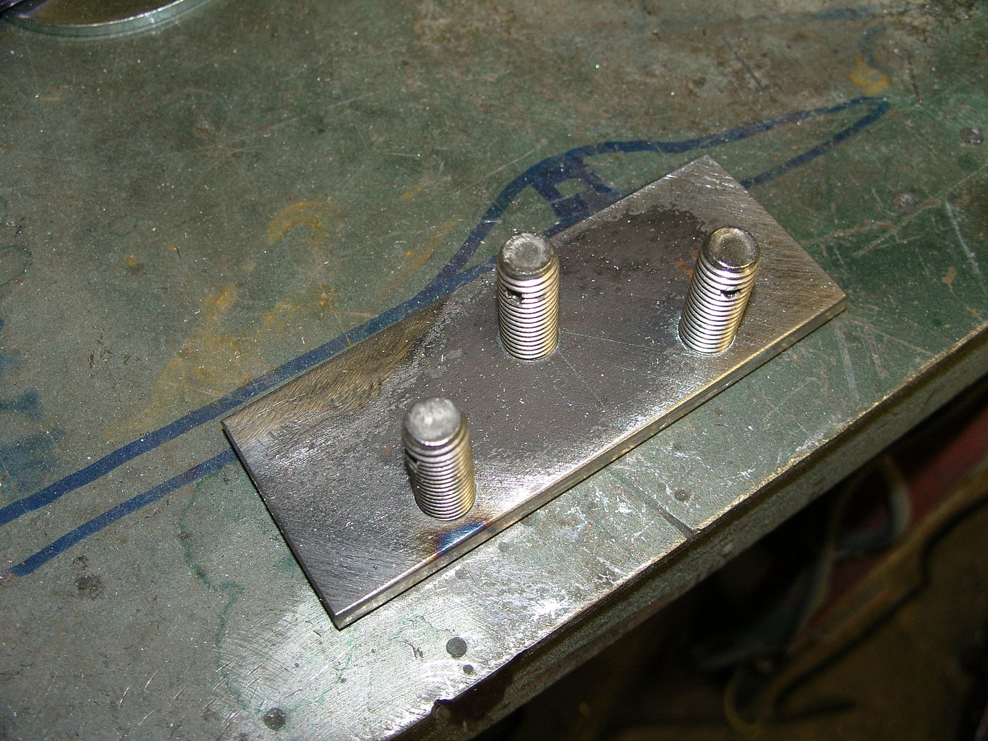

    Well progress has been slow as its been ******* down since monday :(
    I did get to make some engine mounts last night though, I made the basic shape a while ago but they didn't get used so they ended up on the parts shelf, Which make them handy for this project :)
    I wanted them to look old so decided to attach them to the frame with castle nuts and used Early Ford engine mounts.
