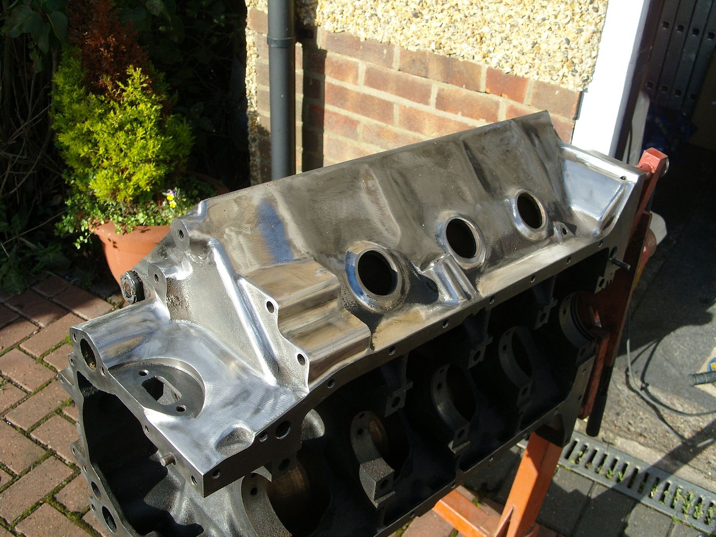

    Anyway back to your question about the smoothing out.
    Its not a difficult thing to do but can be time consuming, with the modern paints available you don't need to get it as smooth as you might think, most of what i do is finished to 120 grit, the paint will do the rest of the smoothing for you.

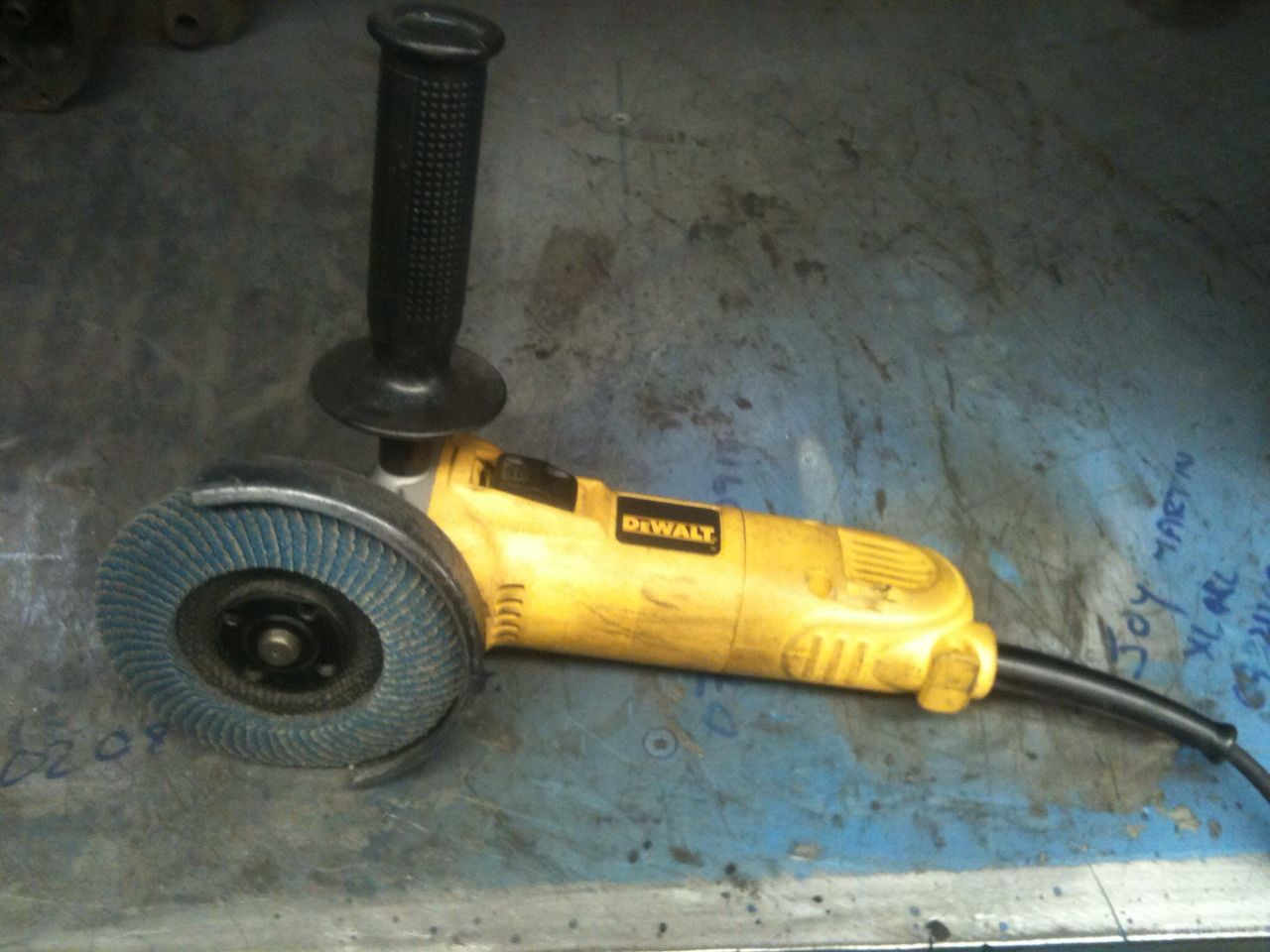

    I usually start with a angle grinder with a flap disc in it, this is used to get to the vast majority of the surfaces.
    For the castings such as blocks, heads, water pumps etc etc I start off by using a angle grinder with a 60/80 grit flap disc in it, this is good for removing the big unwanted lumps and smoothing off the large areas and any corners, basically get in where you can with this.
    Next I go around all the curved corners and awkward bits with a Tungsten burr in a Die grinder, I use burrs of different diameters and shapes depending on the raduis.
    Then for the small areas between the corners and large areas i use an electric finger sander and 90 degree die grinder with Rolok discs.
    Thats about it really, just get it all reasonably smooth, you don't need it perfect as the primer will do the smoothing job for you. This head was done this way and only has 1 coat of aerosol primer on it to see how it would look.
    Heres a few pics of my 26T block, master cylinder, water pump & intake etc etc I did.
    Hope this helps and inspires you to have a go, Its a lot of work but more than worth it.

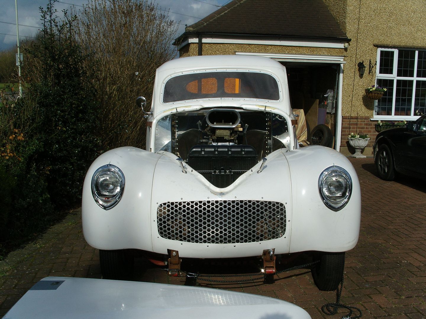

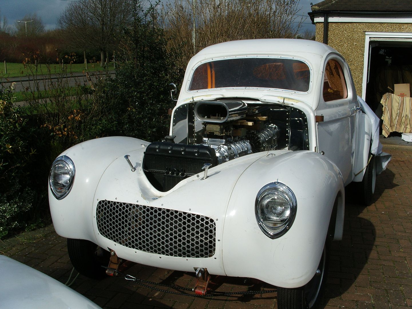

    Well the weather has been very kind the last few days and my old mate Garry Bennetts was staying over for the NSRA swapmeet on sunday, Garry has had a blower on every car he has owned and knows his blowers and suggested we should dummy mine up in the car to see how it all looked :D
    We got it all in position and was surprised it all fitted under the stock hood !!! This was due to me fitting the motor a little lower in the frame than usual. I really liked the sneaky pete look but over the next hour Garry convinced me it should stick up through the hood. then 7 of the boys north of the border turned up on the way to the Swapmeet and all said "its gotta stick out the hood" , It was settled
    Heres a pic of it fitted under the stock hood line. The hood clears it by about 3/8"
    Here its spaced up with 1" Phenolic spacers and bits of wood under the carbs, still not enough to stick out of the hood but i don't want to go with thicker spacers so I decided i would make up some spacers for the scoop and raise it slightly, I'm looking to have the scoop intake just clear of the hood lip.
    Heres a pic of it raised slightly, better ???
