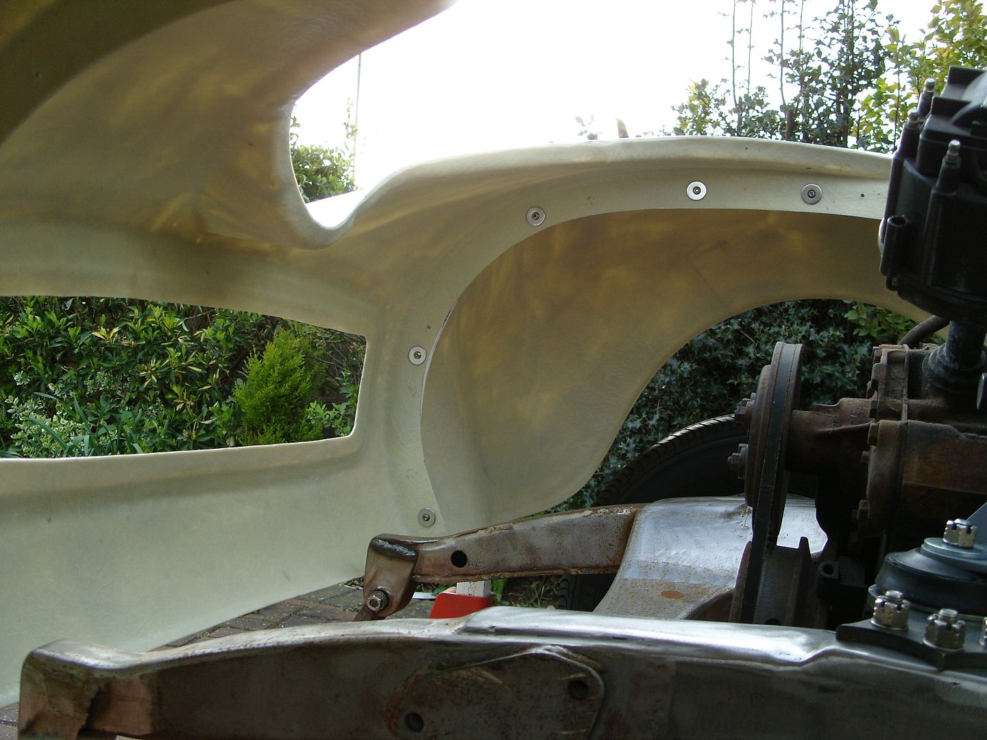

    Well it stopped raining for a while so i cracked on with the rest of the engine mounts, I didn't want the motor high in the rame so used alternative mounting positions.

    langy, Was wondering what the mounts you used were ? Kind of look like hockey pucks . . . . .
    Dave
  12. langy
    Joined: Apr 27, 2006
    Posts: 5,730
    langy
    They are Speedway early ford mounts Dave, i kinda like them as they can be adjusted and if too soft i put hockey puks in to replace the rubber.

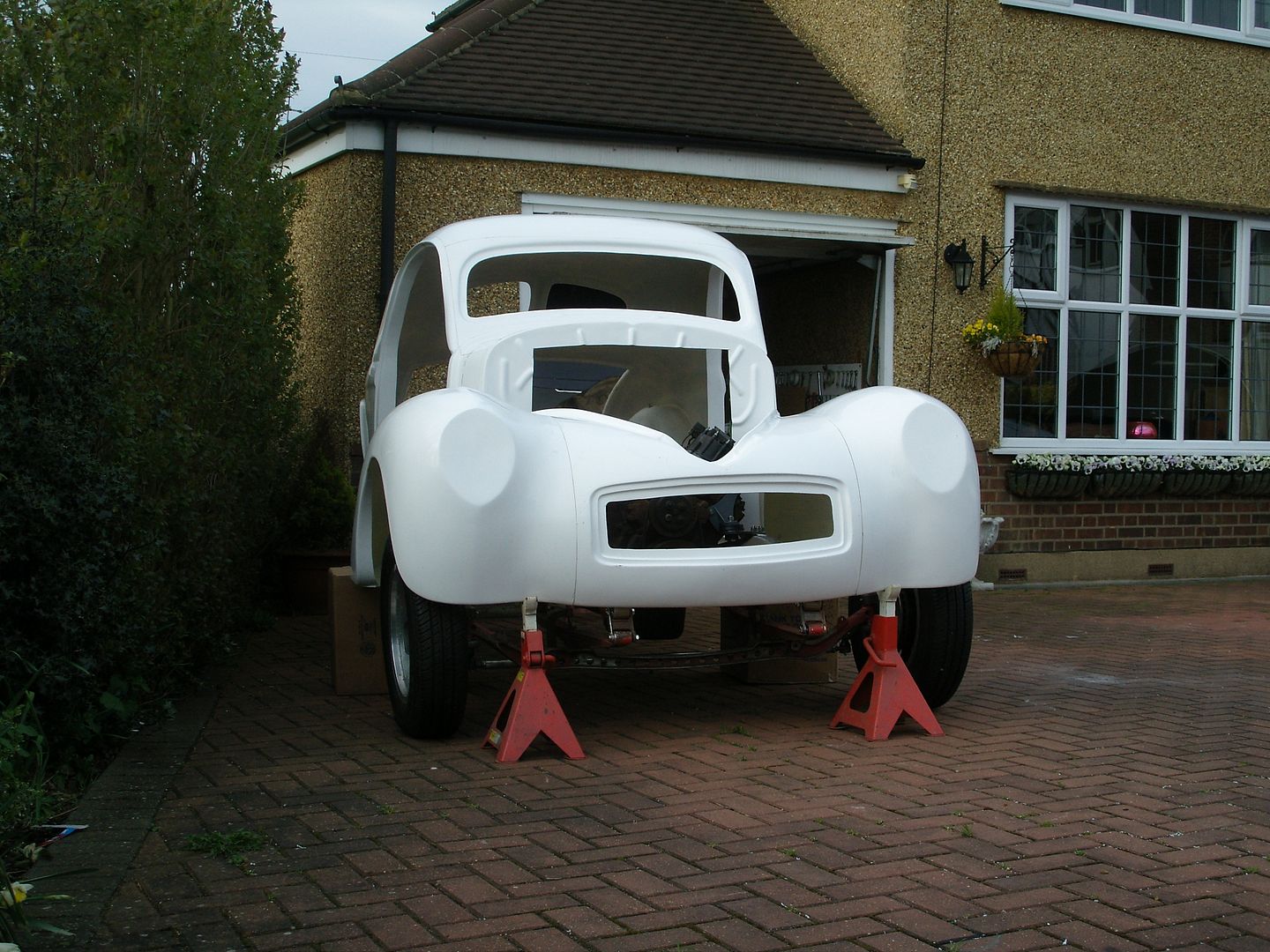

    Did the mod on the centre section last night, raised it slightly for tailshaft clearance, Couldn't make the mount though as couldn't find the TH400 mount i bought.
    I did the panhard bar the other evening in square to match the ladder bars but forgot to post the pics.
    I had a few hours spare this afternoon and my mate turned up today with a van so i got him to use it to pick up the body from my lockup, once we got back with it we played arund and mocked it up.
    The firewall was removed as it won't be needed.
    I bolted in some temperary wood spars to hold the body at the right height.
    This will have to be removed soon.
    Drilled & bolted a fender on, and drilled and bolted the frontend together.
    Next we mocked up to get an idea how it will look.

    Langy, I just read the six pages. It is very entertaining watching you make progress and seeing things from your point of view across the pond. Do the English still use Whitworth fasteners and tools?
    The quality of your fiberglas looks excellent. I can't see any roughness on the underside. You didn't press mold it did you?

    No mate Whitworth went out years ago, Its virtually all Metric these days but i use UNF & UNC as much as i can but some fateners are tricky to get here.
    Yes the gl***work is good, my laminator likes to get them as smooth as possible, He is a good guy.

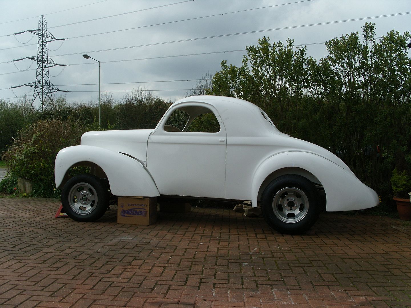

    Not much work yesterday as it was my birthday and Sue insisted on taking me for a meal and beer :D
    But i did sneak a bit of time in the morning, I picked up a pair of 9" shafts that had been drilled Chevy pattern so popped them in and bolted on my rear wheels, It looks completely different now, The tyres i will be running are gonna be 30" tall which is 2" bigger than the radials on the wheels a the moment.
    I also taped a door into position and laid the hood in place to give a better idea of look.
