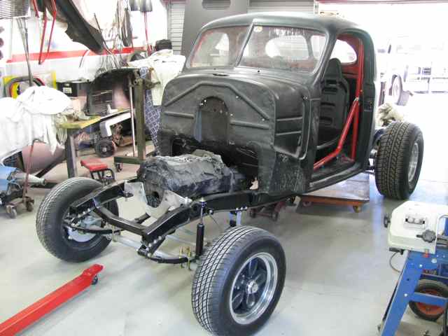

    Weather great again today so more fitting up, It amazing how a bit of nice weather lets you get so much done.
    First job was to get the cage back in the car, I knew I had to cut holes for the rear legs and they had to be big as they have a stub with a flange on them. A hole was cut and the legs put through and loosly bolted in, then some cover plates were made up to cover the holes, they will be sealed when i get some more sealer, rear bulkhead has to be sealed for regs.
    While I was there I decided to bond in some ply around the rear windows for the trimmer to attach the headliner too, This will have a full interior like a g***er should have.
    Unfortunately I ran out of ply to do the other side :(, its bonded in with fibregl*** paste
    Cage all back in and bolted up.

    Luckily it stopped at teatime so I managed to get a couple of hours in last night after the rain stopped, mostly bits and pieces but i did get my battery cables all terminated and screwed down to the trunk floor with Adel clamps.
    I ran the main battery cable along the ch***is mounted in Adel clamps while the body was off, it runs along the main p***enger ch***is rail and ends at the rear axle where it needs to enter the body, the floor here is 1/4" thick so no grommets available so I used a bulkhead connector, very handy.
    The connector is under the battery tray out of harms way. battery cable is 35mm2.
    While I was crimping the eye lugs on I thought i would show you what a great little tool the Speedway crimping tool is. I used to use a set of tong type crimpers which were very expensive and very good but unfortunately someone borrowed them and never bought them back. This simple tool is equally as good.
    Heres a short video clip
    Also got the fuel tank back in place and the fuel lines hooked up.
    Another little job that was annoying me was the little cables on the hood & trunk pins keep going rusty and I didn't like the way they were secured under the small hold down bolts, solution was to use stainless steel bicycle cable and to drill small holes and hold the cables fro the rear, looks neater I think, sorry about the dust on them.
