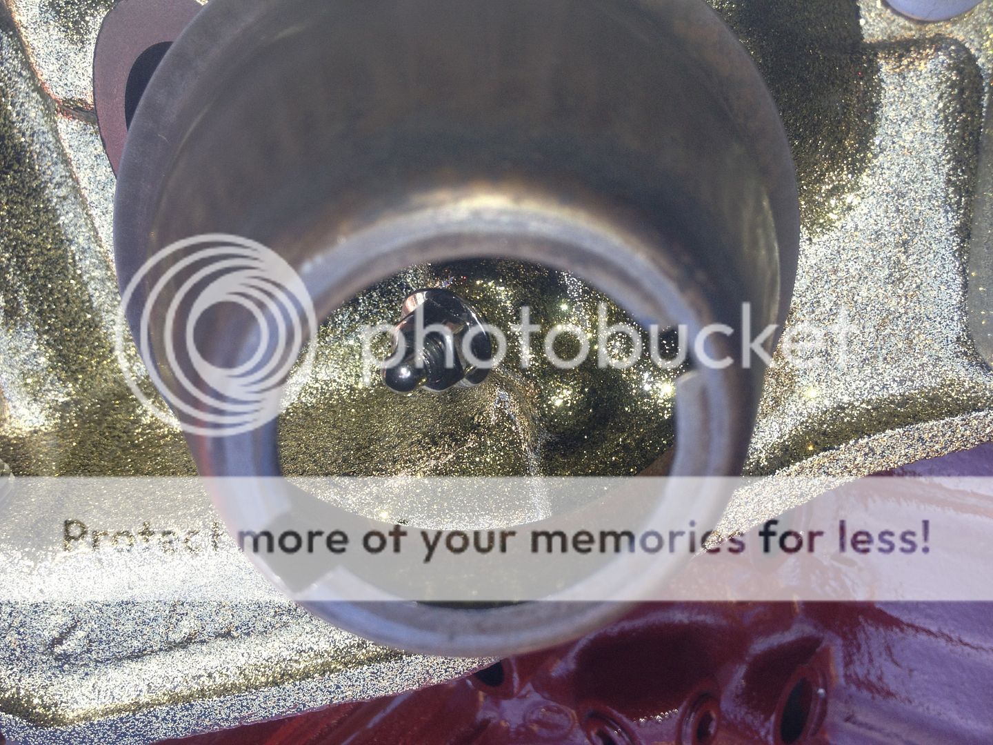

    Yes amazing stuff when applied correctly, I don't want to get into the usual argument about its use but I worked at the race shop that prepared the GT40's that won the LeMan 24hr in 66 and the Gulf Mirages later and all the engines there were painted inside with Glyptal.
