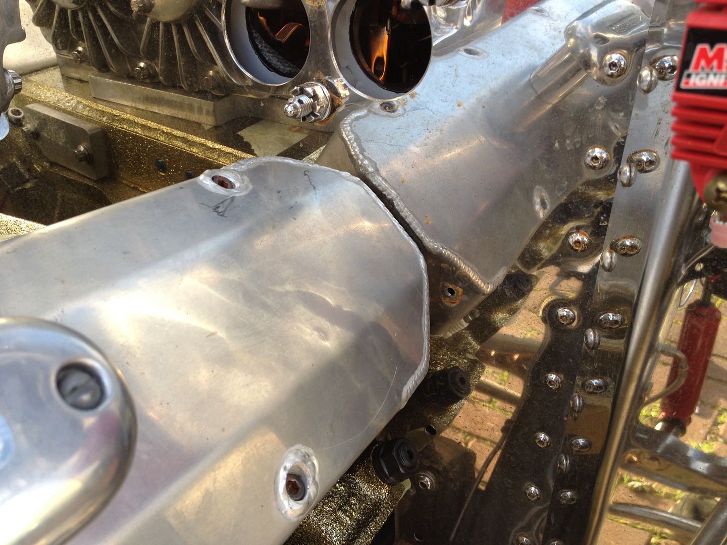

    I wanted to get the engine sealed up asap so valve cover was an urgent job, my tig is setup for a stainless exhaust i'm doing at the moment so popped over to my mate Garys, plus he has a brand new Miller Dynasty :D
    First job was to cut off the offending portion, then we sliced up a new end cap and job was a good un :cool:
    Rushed back to fit it and it was ******* down yet again !!! :(

    It stopped raining for a while today so I popped the valve cover on to check clearance, I now have a nice 3/4" of clearance instead of the 1/4" I had previously..
    Before
    After

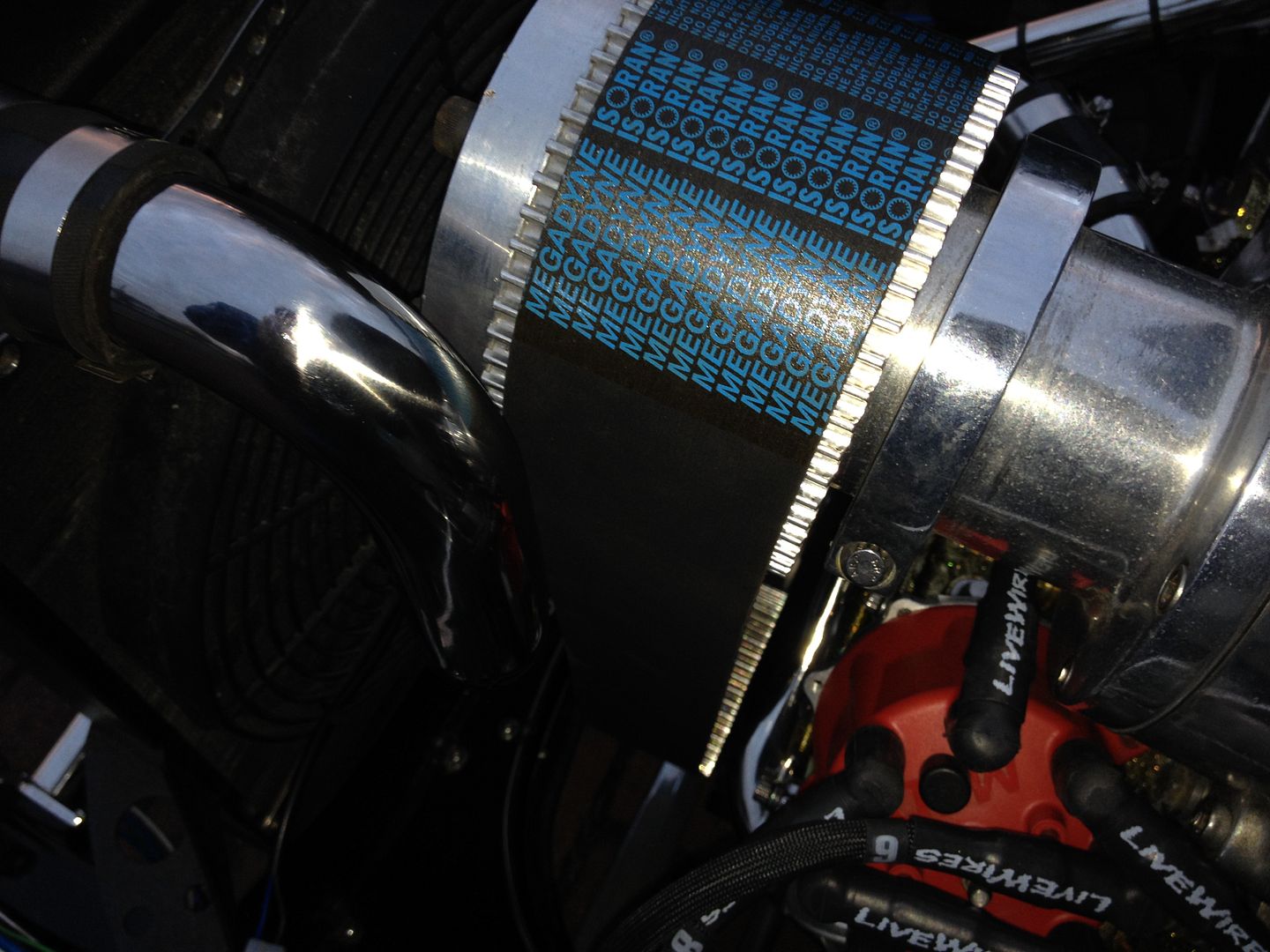

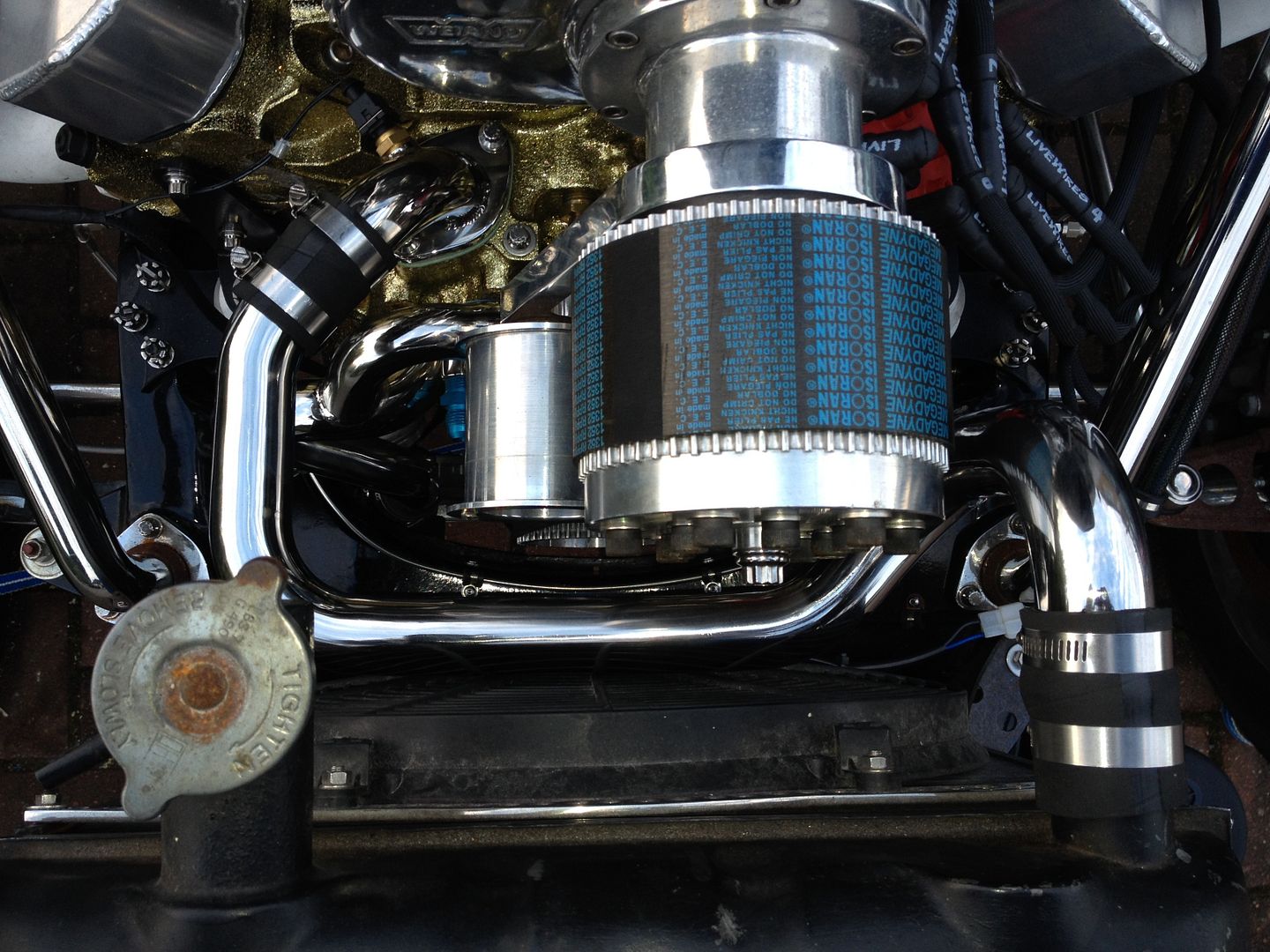

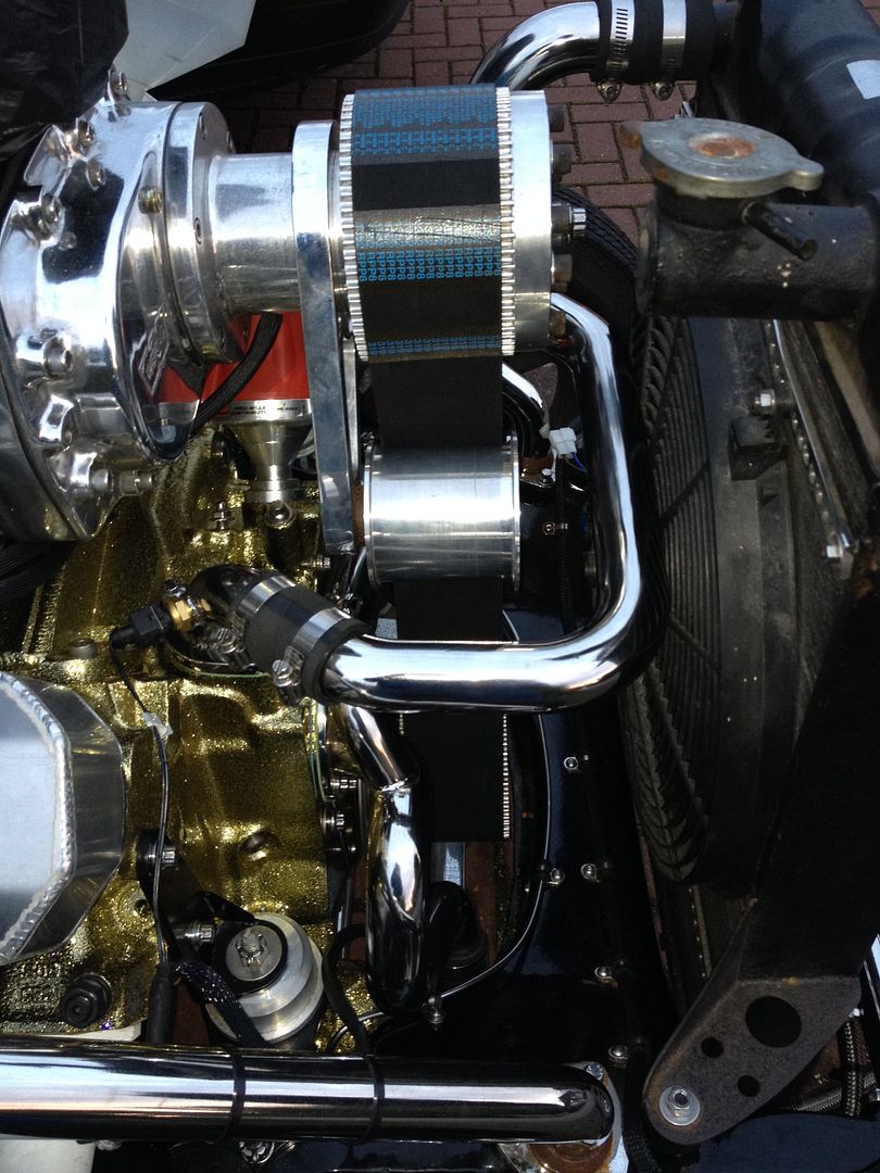

    Managed to find a few hours today as ran out of materials on a job I was doing so looked out the window and it had stopped raining so managed to get a few more jobs of the list, its actually very short now !!!
    I had ordered another blower belt due to the repositioning of the idler ***embly so that was the first thing to fit, got it all in place and now the idler fouled the thermostat cover end of the top hose, unfortunately the length belt I wanted they don't make so had to have one slightly shorter.
    So out with the thin cutting disc and within minutes I had a selection of bits, the top hose was duly modified and extended where needed but the thermostat cover needed to exit at an angle, so more cutting and the bend was rewelded round a bit, all good now !!!
    I'm glad I altered the idler now as it gives excellent blower belt wrap.
    I really must get a nice cover for that rad cap !!!
    Before
    After

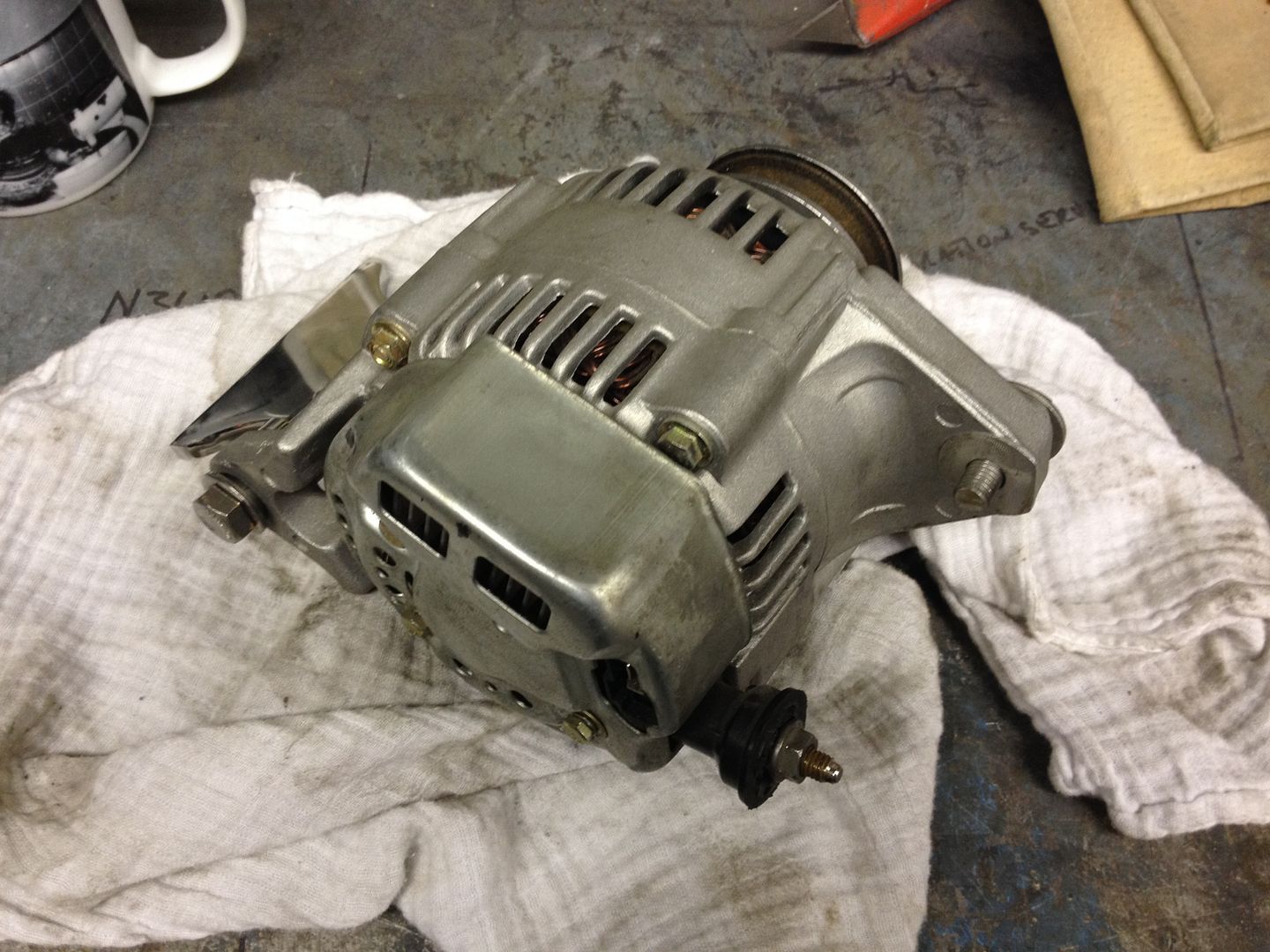

    A few more jobs done today, the hose fitting and longer coil lead turned up so they got fitted, about the only awkward job left was to make an alternator mounting for the small Nippon Denso alternator I have, I'm quite surprised no one noticed it missing to be honest :D Its a 60 amp so should be fine but I have an 80amp which is a straight swop if needed.
    I've left it as one of the last jobs as I needed to sort the blower belt first, I had a few options but ended up mounting it low on the drivers side.
    It was quite awkward to do on the willys with all the other stuff in the way so used my 26T Cadillac motor as a jig, plus its nice and warm in the workshop :D
    The rear mount picks up on the original engine mount pad and the front mount picks up off the fuel pump blank off plate, nice and simple.
    I originally intended to lighten the incredibly heavy stock cast pulley, I started turning of the not needed excess but then thought I might as well make an aluminium one, still need to put the groove in for the belt.
    Next I needed an adjusting arm, this mounts on the frame.
    These pics are it all bolted in place, its tricky to photograph now the front end panels are back on.
