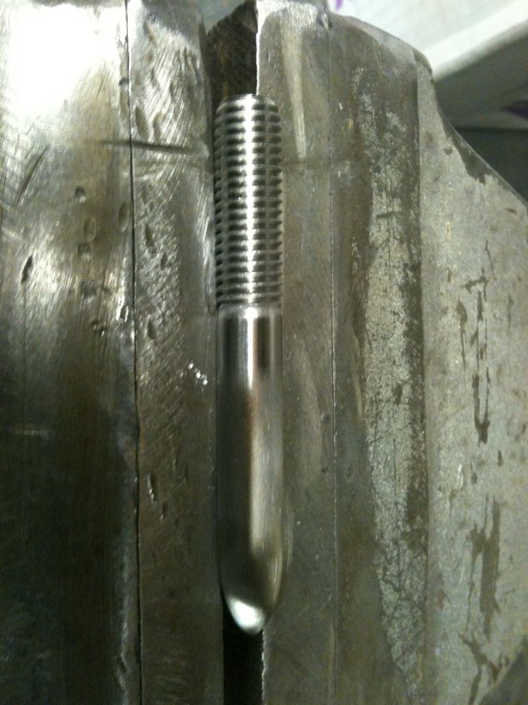

    Been playing with hinges for the trunklid and suddenly thought "I don't need these, they are just extra weight" So i decided to put all the removable panels on pins.
    First job was to make up the tabs for mounting the pins on, i used the offcuts from the old firewall and beefed them up with 3 extra layers of matt & resin, nice and thick.
    These were held to the trunk gutter with 2 small screws for each corner after 3 layers of matt were applied, then a piece of wood was clamped to them to keep them in line. then any gaps were filled with chopped matt and resin.
    Next i needed pins, I could of bought some but i realy wanted stainless so i used 10mm stainless bolts and cut the heads off them and shaped the ends by spinning them in a drill and shaping with a soft disc in an angle grinder. I then drilled the holes for the clips and then gave them a quick polish.
    All 4 fitted to the shell
    The round plates were holesaw offcuts from my 26T project, I'm glad i didn't throw them away now. 3mm Mounting hoes were drilled and countersunk machine screws used with nylok nuts underneath, stainless R clips came from Ebay.

    Langy, Now that is a great simple way to attach the trunk lid. Probably not too much time and money invested.

    Exactly Dave, it was quick to do and cuts done on some weight and looks right, I need to get this done pretty quick, Thanks

    Thats lookin pretty nice, I reall like the extensive use of stainless in all of your prjects :D I've been TIG welder on nothing but stainless for quite some time now so I also enjoy it very much! Just wondering though do you use ainti sieze on all stainless threads? I've have had quite a few cases where anti sieze was not used, removing a stainless nut off of a stainless bolt results in it snapping off. Just wondering how it works out for you in your applications...?
    Also I have not the slightes clue about fibergl*** work.... Just a simple rough up on both pieces, and the resin adheres so well?

    Yes lube on the stainless threads is an essential, Even spinning nuts on by hand can introduce galling.
