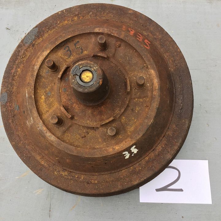

  6. Mr48chev
    Joined: Dec 28, 2007
    Posts: 36,519
    Mr48chev
    I've collected a half dozen or so 35 wires over the years but have never checked them to see if they ran true or within specs.
    Stock 35 drums had the nubs built in to support the wire wheels.
