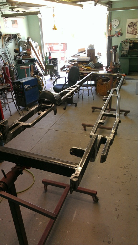

    Bob has the ch***is completely welded and ground now. Lots of tedious small work that just doesn't show up in photos.

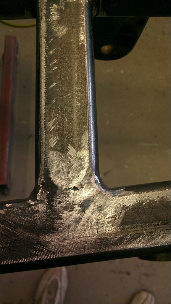

    Not much of an update, but progress has been made. I went to Bob's this morning and spent 5 hours hand filing the ch***is to smooth out any rough spots. This thing is turning out so much nicer than I had imagined, but with Bob at the helm it should be expected.

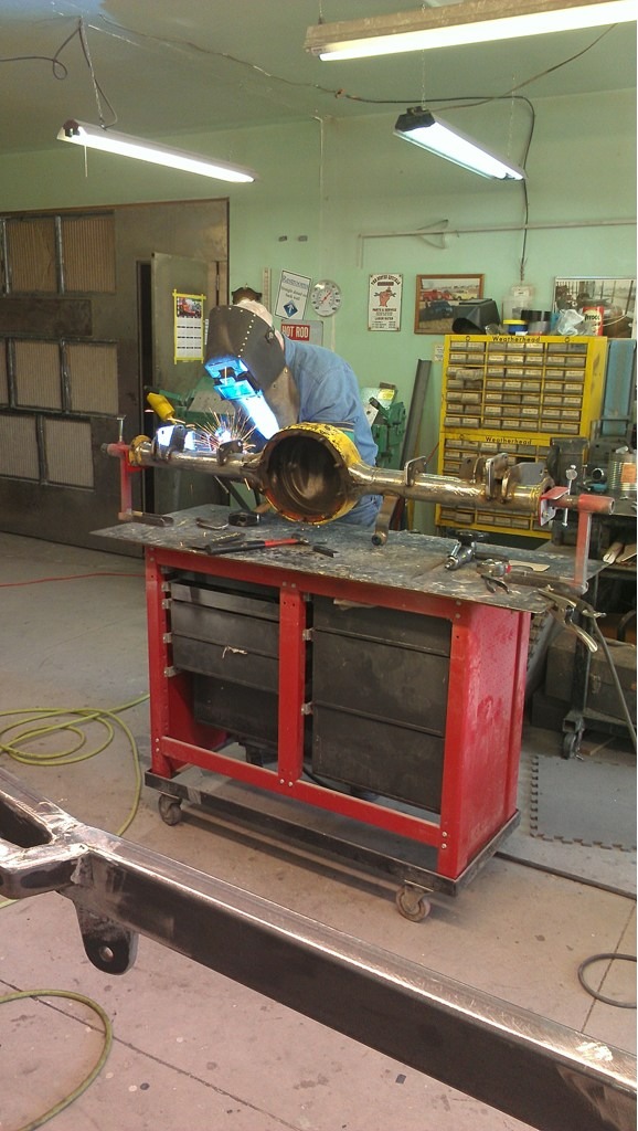

    While I was filing away Bob spent time reconstructing the inner rear bone mounts on the rear axle housing. As was pointed out previously, the way they were set up allowed the rear end to pivot, except for the outer bones (Ford). This somewhat defeated the purpose of having the inner bones, which was to strengthen (or ***ist/prevent bending) of the Ford bones.

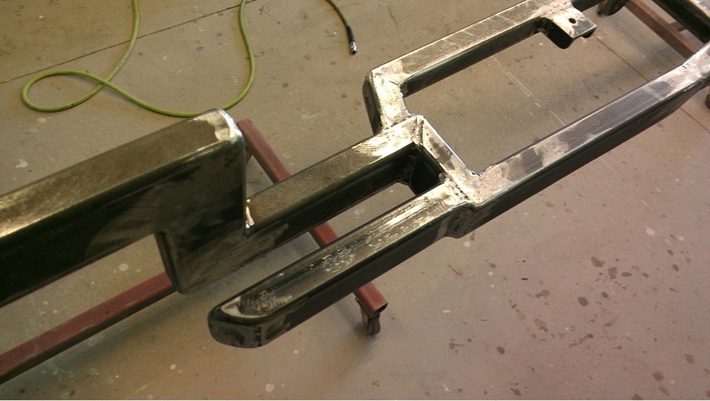

    One eyesore and pet peeve of mine is a ch***is that's kicked in the rear that's obvious from the side profile. As such, Bob built an extension so the frame will appear to continue past the kickup toward the rear axle. No unsightly gap between the ch***is and rear tire now. Nice. :cool:

  17. Blue One
    Joined: Feb 6, 2010
    Posts: 11,518
    Blue One
    from Alberta
    Gee, where have we seen that idea before ? :D ;)

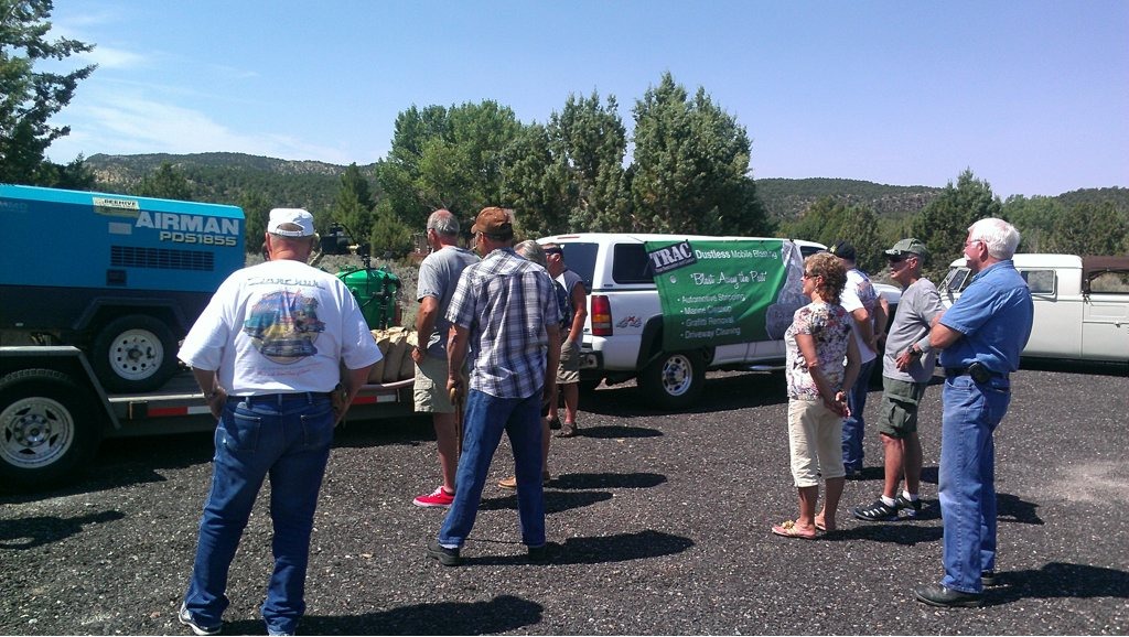

    This weekend, as un-exciting as it may seem, is exciting to me. We'll have the car club together and do a wet blasting demo that a friend's family has gotten into. The ch***is and all suspension components will be blasted and body/paint work will follow immediately thereafter.
    We should have a completely painted rolling ch***is in a few weeks to a month. Once thats done we'll have the body wet blasted and body work/paint to follow. It's getting close, but it still seems so far away!

    Larry, I don't know how I missed your comment before, but YES, I love what you did! It's always been a pet peeve of mine and I love how you addressed yours!

    I agree, and I think yours will look great as well. It just looks somewhat incomplete having that "gap" there.

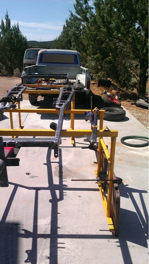

    My friend Todd and his brother Troy met me at Bob's this morning, and the four of us loaded the ch***is and all of the suspension parts. We took them to Todd's dad's house and dropped them off, then drove back to town to have breakfast with our car club. We threw a few of Bob's T parts on the trailer as well.
    Our car club has nothing important to discuss, so we have EATINGS not meetings. Everyone was invited to come up for some wet blasting action.... wait, that doesn't sound good. :D
    So most of the people that showed up for breakfast made the drive up the hill to cooler country (about 15 miles north). Todd and Troy gave us a cool demo and supplied hearing and eye protection. Wet blasting (and sandblasting) is friggin' loud!!!
    <iframe width="420" height="315" src="//www.youtube.com/embed/xu4OYM40ImI?rel=0" frameborder="0" allowfullscreen></iframe>
    So now we have lots of bare steel that's been treated and ready for sealer. Bob will begin again Monday with filler, sanding, primer, sanding, primer, sanding, primer and ***embly. We'll have another EATING not meeting and invite everyone to watch the body getting blasted in October.
