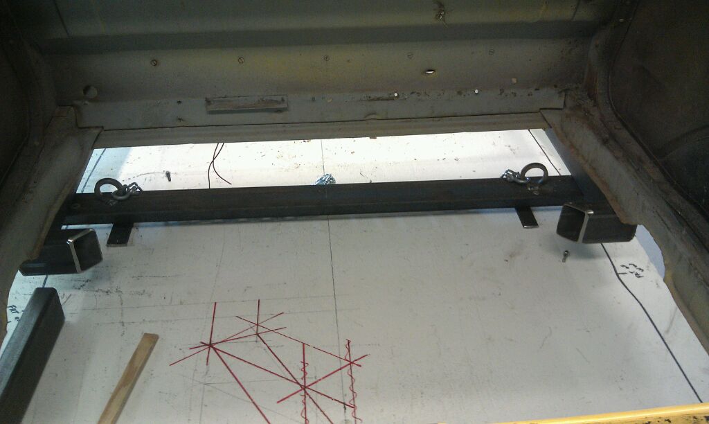

    Yes, the top bars will most definitely be under the car inside the frame rails and viewable to ants and snakes only. Both rails are now sliced, bent and spot welded. Cross members have been started.
    Hopefully I can get up there later this afternoon and see the progress. If so I'll post pictures. :)

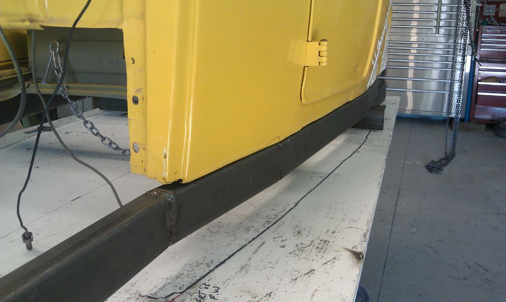

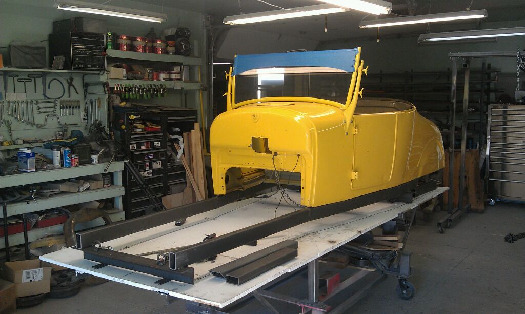

    Kramer, you see how the top bars are mounted in the second pic on post 26? I think Bob is going to replicate that fairly closely with new hardware. Stay tuned, things are moving fairly quickly and I'm sure we'll all see Bob's vision soon.
    My wife and I stopped by tonight, and I'm blown away by the progress. The rails are cut, bent and set, and follow the contour of the body nicely, without being over-done. Bob has built a few ch***is' that follow the body contour completely, but with 30 cuts and 30 welds PER RAIL I didn't opt for that kind of labor.
    My upholstery buddy came by too and discussed what he wanted to have happen in preparation for his work.
    Please enjoy tonight's picture show... :D

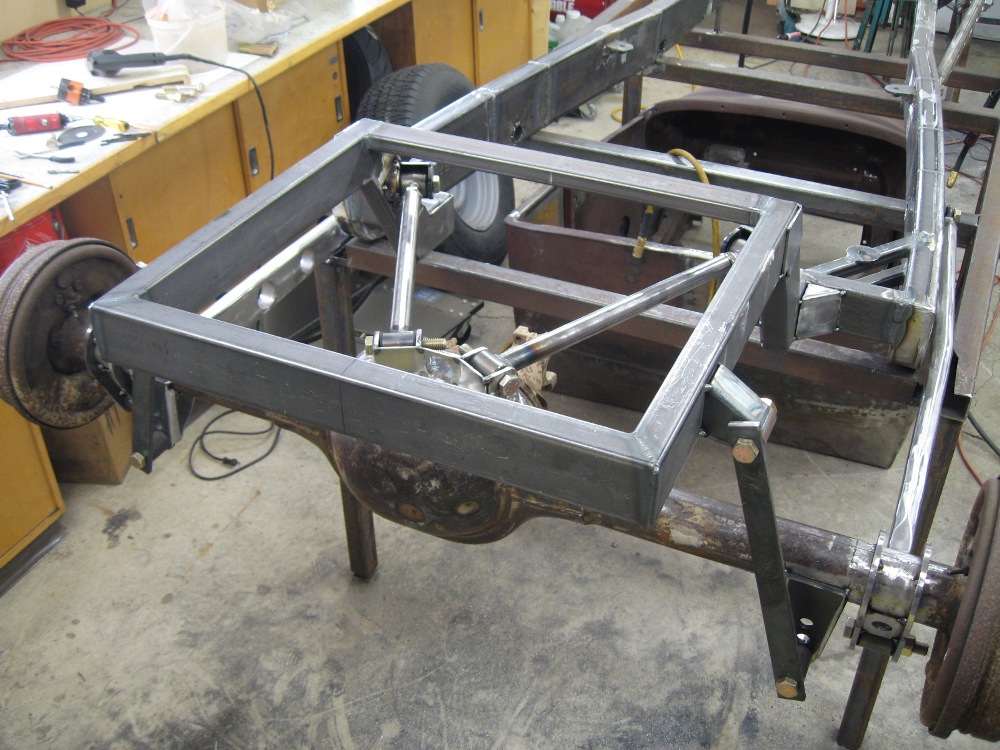

    Not to hijack here, just to show my version of a modified triangulated 4 bar rear suspension I designed for my 26 RPU.
    I fabricated my own rear bones and the top bars are up inside the frame. I will be using coil overs however a transverse rear spring would also work.
    Larry.

    Stopped by Bob's tonight. He hasn't had a lot of time this week, but the body is back off and the suspension is being mocked up.
    There will be much more progress next week!
