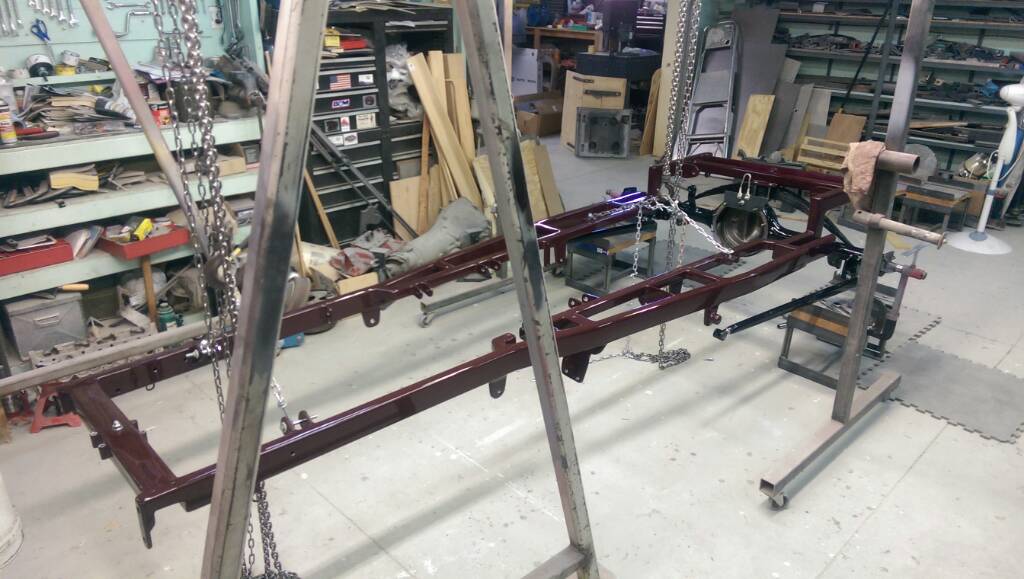

    That looks the business Eric, love the way the black and that super nice ch***is color go together. Totally cool and you must be so stoked. JW :)

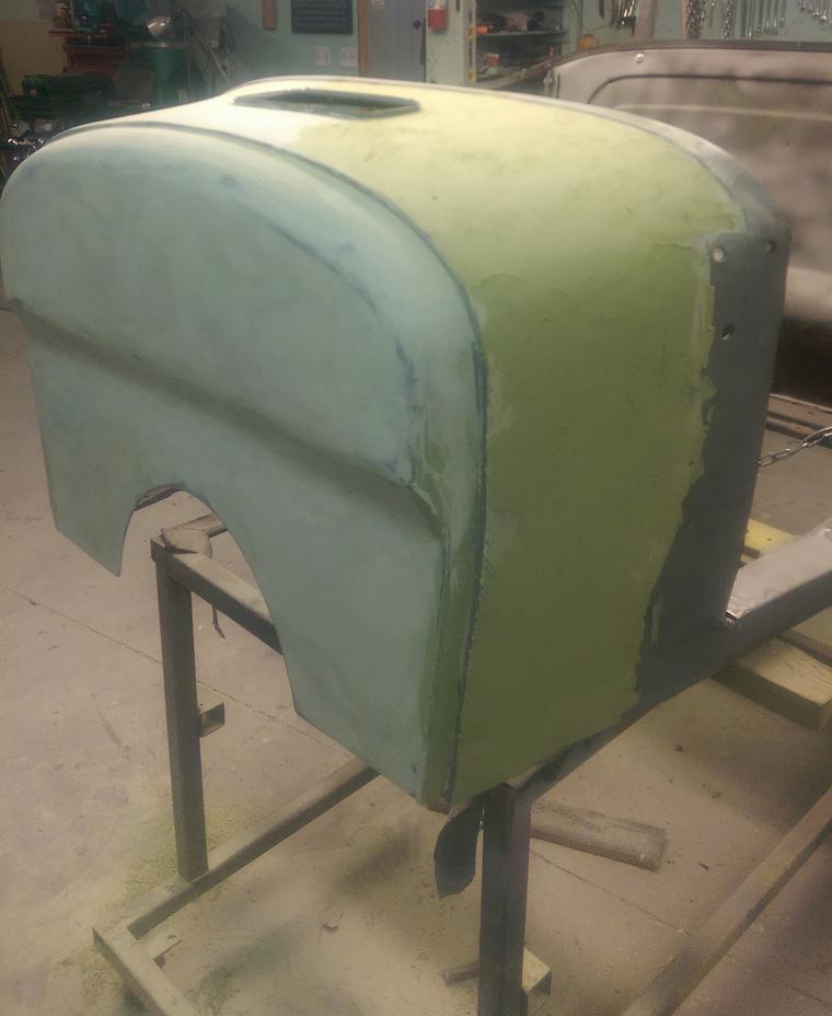

    Progress is awesome! How is that old body coming along? any recent pics of it?

    Cowl metal work is finished, has a few skim coats of filler now. Haven't seen it since last weekend but here's the latest pic I have. I may have already posted it. Gimme a shout soon, we need to connect!

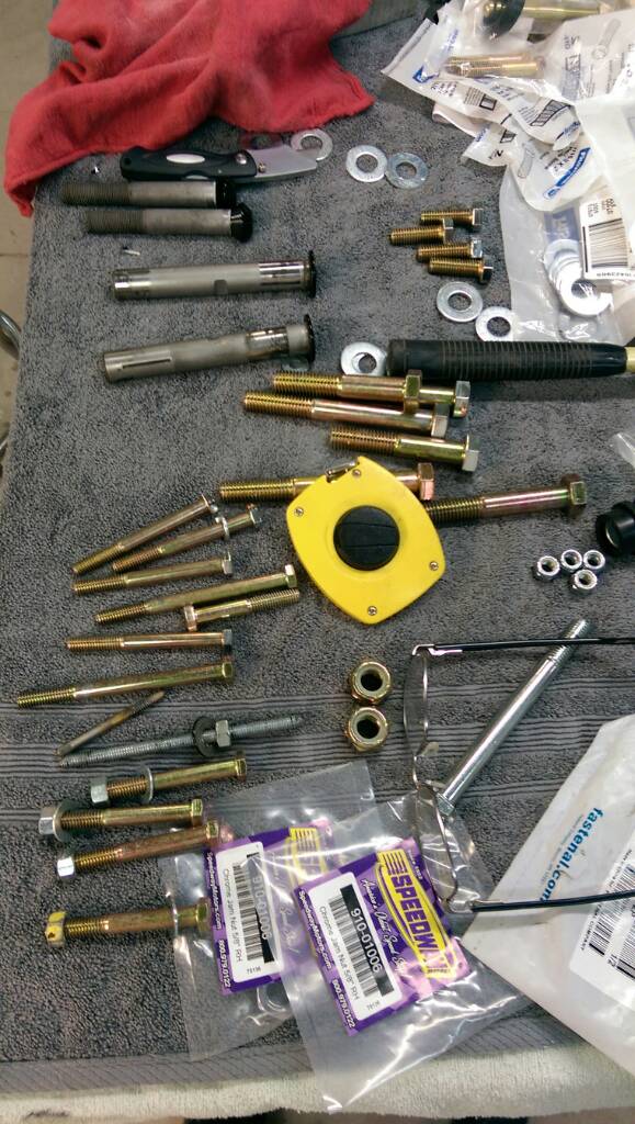

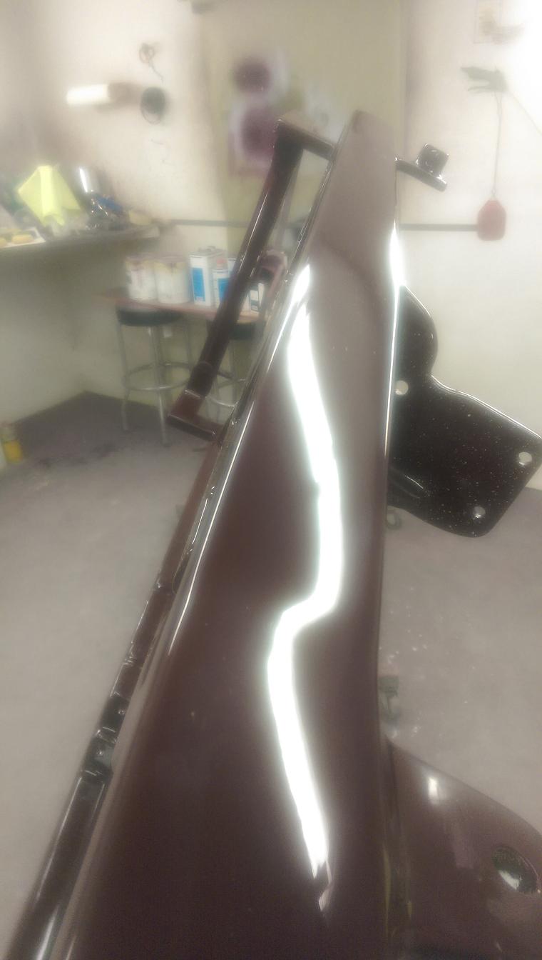

    Here are a few more pics from last weekend that I haven't posted yet. Bolts are Cadmium plated Grade 8, they get polished before final install and stay looking good forever.
    volvobrynk and 26 T Ford RPU like this.

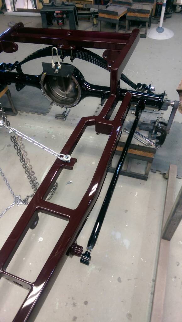

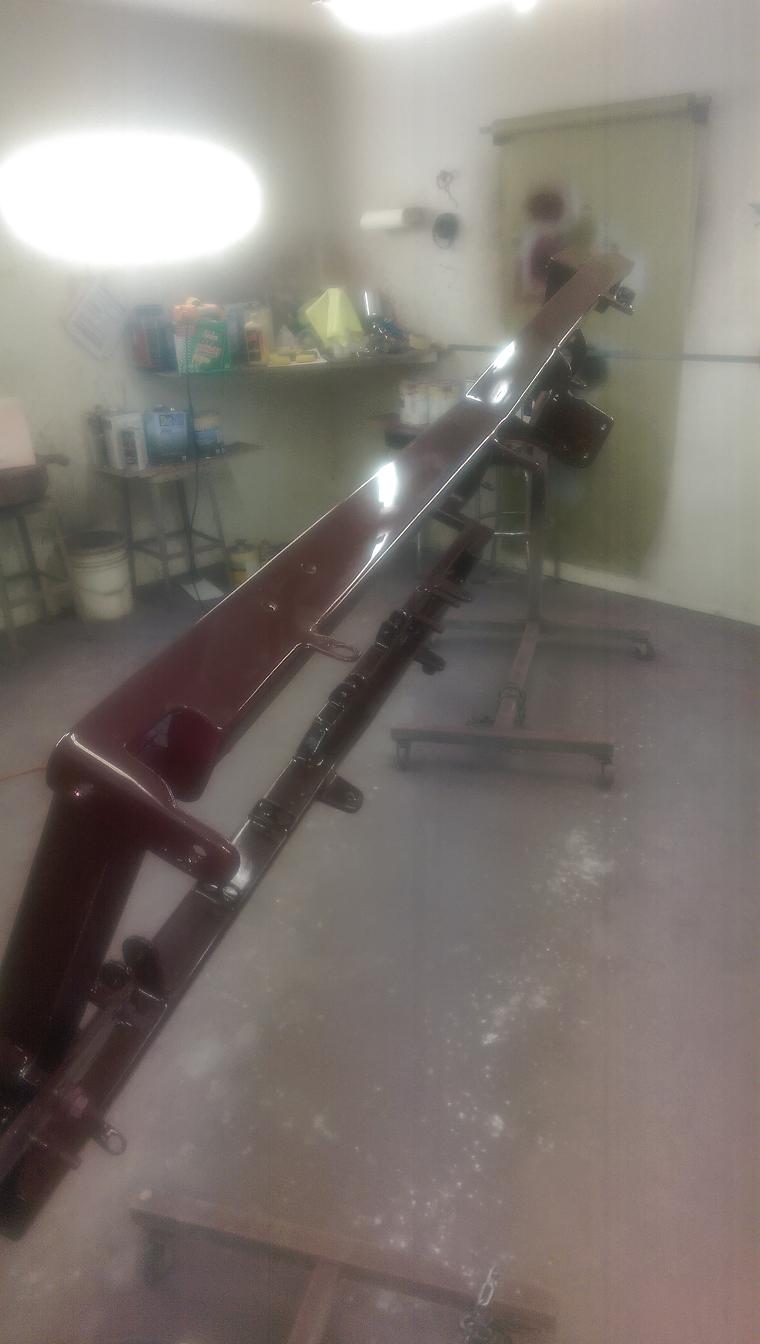

    Quick update, not much to report but still moving forward.
    More parts painted in base/clear. Master cylinder, steering box and rear shocks.
    Some hand fabbed rod ends.
    Modified king pins, ***orted hardware and more grade 8 bolts to polish. 1403918971337.jpg
    Front spring painted and ***embled.
    And the frame pretty much the way you saw it last.
    We did finalize the ivory color that the wheels and firewall will be. I dropped off the sample to the paint store this afternoon and they'll have it mixed for us Monday morning.
    26 T Ford RPU likes this.

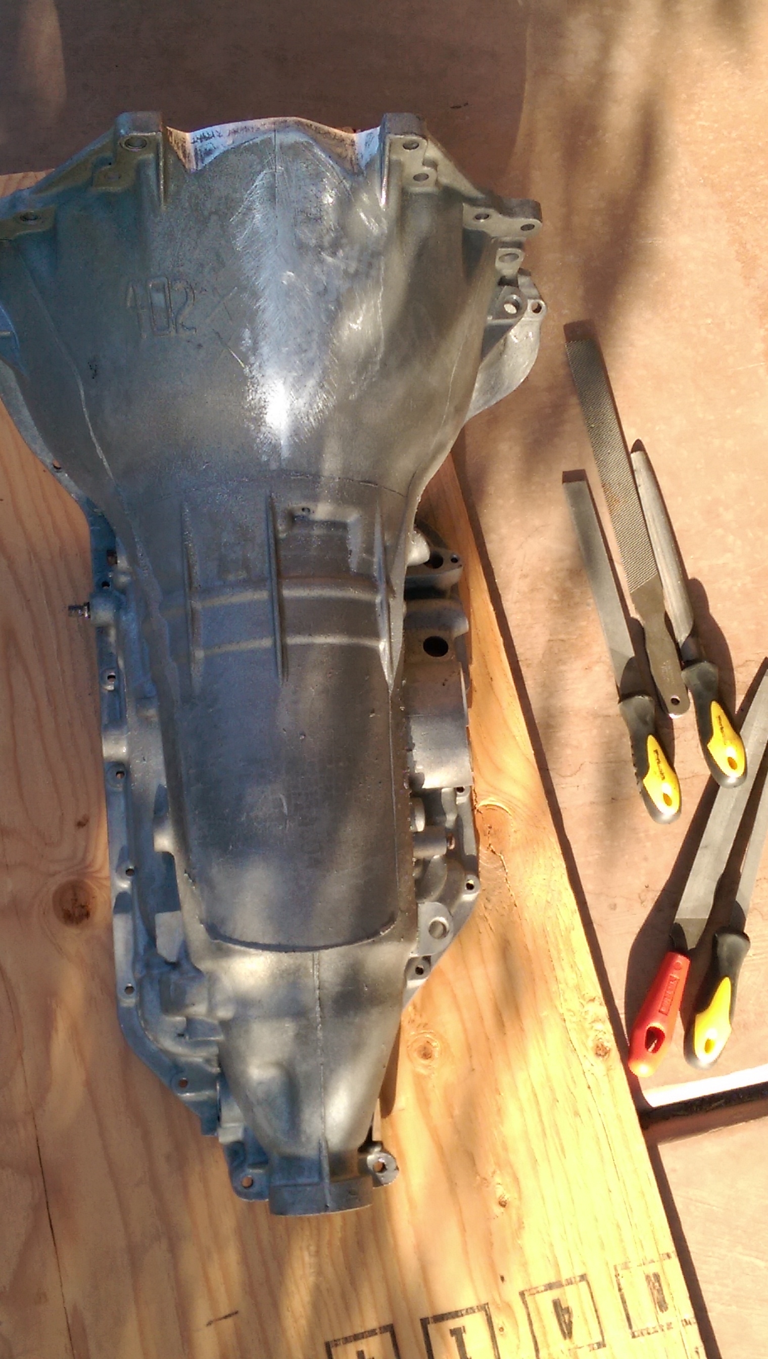

    I mentioned a while ago that I decided on running a 200R4 (or 2004R if you prefer). That's been secured, but not without a little blood. My trans guy broke it down and cleaned it thoroughly and I picked it up. Because of the significant amount of flashing it was like picking up a 40 lb porcupine. No s***ches required, but I chose to smooth it out some. Of course it will never be seen, so who cares, right? We're hot rodders, we do. So I spent about 45 minutes on it with several flat, half round and round hand files to clean it up some. No sharp edges left and the paint will lay out better without all the garbage on it. I only took one picture after about five minutes of work. It's since been delivered to Bob and he'll cover it in maroon paint before it goes back to my trans guy.
