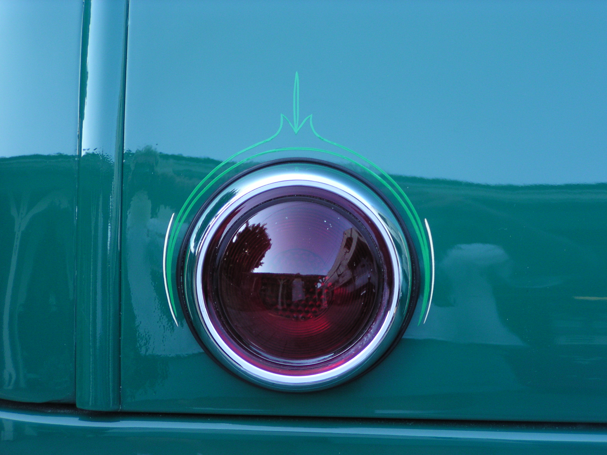

    Eric, that house looks really nice. I might have to come visit. Here are a couple of upholstery pics. Mark.

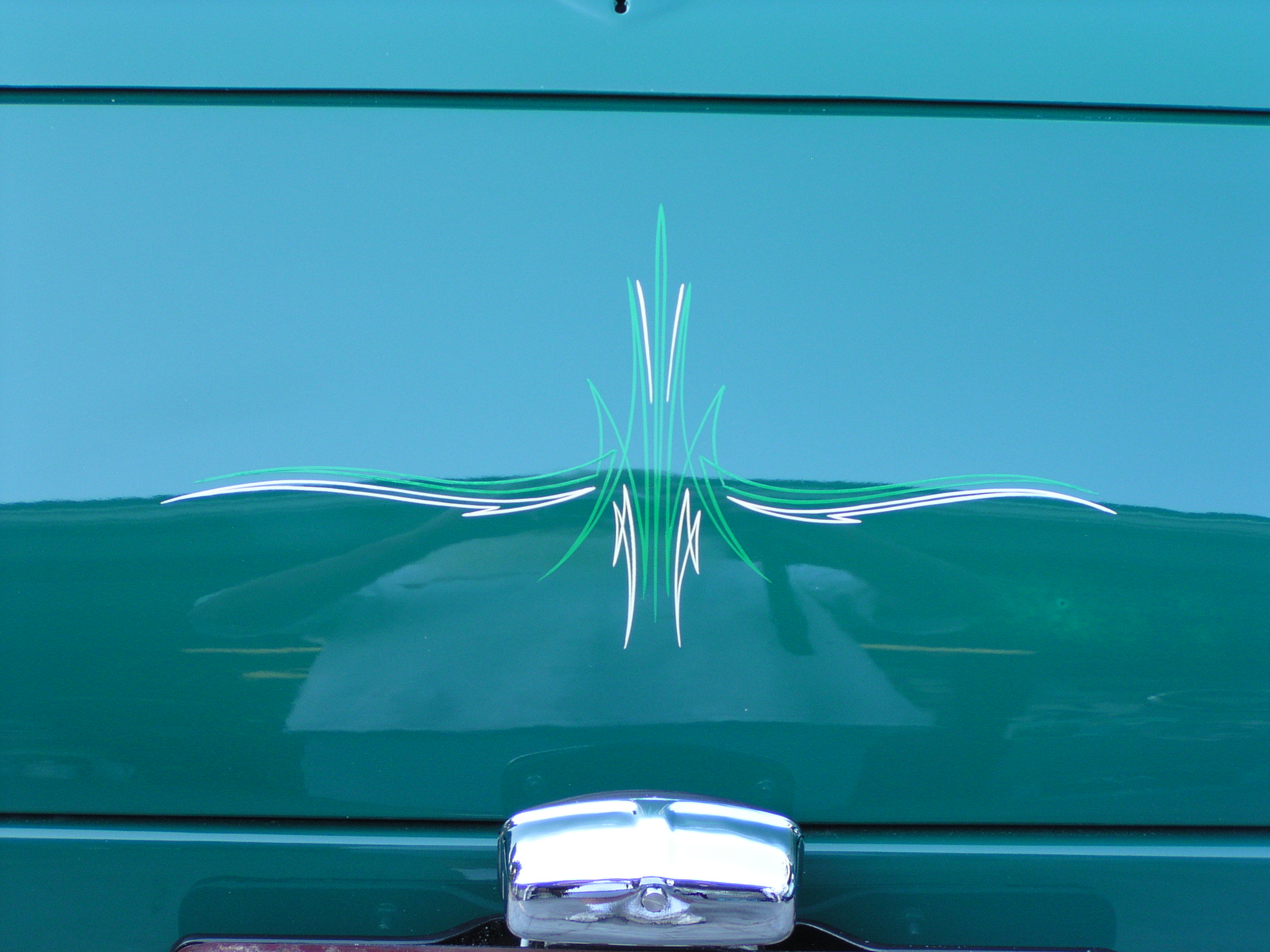

    Eric, here are a couple of pinstripe shots that I had put on. Keep going on yours. It will happen. Mark.

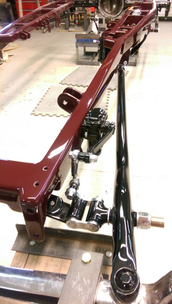

    Bob sent a pic today. Front shocks are wrapped up with a few pieces he cranked out on the mill and lathe.

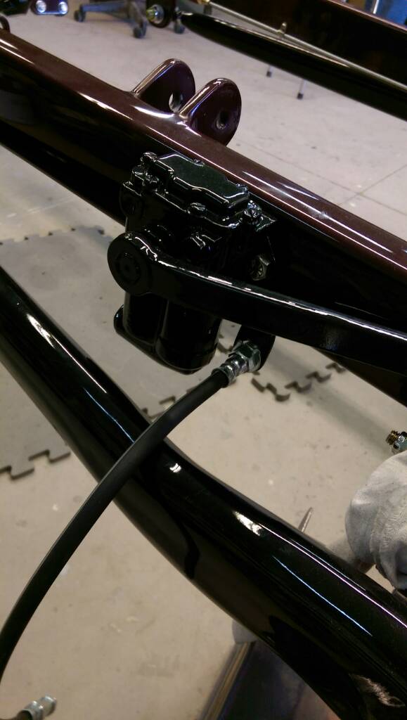

    So, this is the first time I've caught the Vega steering box turned sideways. Is that pitman arm in the center of the steering arc the way it sits? My frame has a tighter pinch at the front than yours, so I was wondering if I would need to switch to traditional steering like Bob has done here or go with a Mopar cowl steering solution. I'm just not that far along yet.

    RJ, it's actually an early Ford Mustang box, not Vega. Depending on which photo you're looking at the pitman arm may or may not be centered. The center position is just slightly forward of straight up.
    Regarding frame width and steering boxes, it's going to depend completely on how you engineer it. This one was kind of a compromise because I wanted outside steering (like we did) but that meant that I would have a somewhat vertical angle on the steering shaft (which I don't like). I had the Mustang box and it was in good shape so we used it. The plus side of the steering entering the ****pit where it does (floor, between my calf muscles) is substantially more leg room.
    The pinch in your frame will have very little to do with steering box selection. The steering wheel position and the spindles don't rely on he width of the frame. The Mopar box is a cool unit and looks more traditional than a Vega box, but regardless none of them will take into account the pinch of the frame. If your frame has a significant pinch and you're running your exhaust down through the frame it could be real tight getting your steering through there, but lots of guys do it. I didn't have to worry about that because of the.... shameless plug... www.lakeheaders.com from @saltflatmatt
    You just need to engineer your steering to use the parts that you select. Does that help at all? I'm not sure I answered your question.

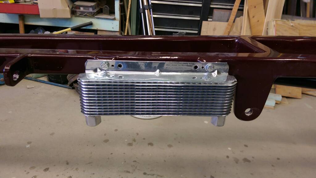

    Thanks guys! Well, I made it to Bob's this morning. Spent about 5 1/2 hours there polishing.
    Bob has finished most of the brake plumbing including residual and proportioning valves. He's also run the 3/8 " fuel line, rear end vent, hung the trans cooler and a few other things.
    Today while I was there he mounted the spindles, backing plates and steering arms.
