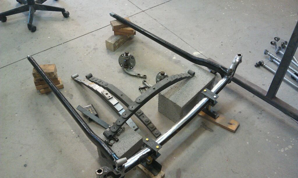

    Update time. You guys know how things seem to move slowly during a build? Walk away for two plus weeks while someone else builds your car part-time.
    Front end mocked up:
    Salt Flat Matt's headers on the mock up engine/trans:
    Other side:
    Rear end placed:
    The plan was to run the rear bones in a factory type configuration, but the angle just wasn't conducive to where we wanted the front of them to end. These are a few projects Bob is building for himself:
    On Bob's red T this is how he ran the bones, which is how I wanted mine:
    Instead, he will be cutting the ends off and channel some plate inside, fully welded.
    This shows the upper piece that will be welded to the axle housing. The upper piece will bolt through to the lower piece that will be welded inside the split bone. Make sense?
    So, that's where we are today. Thanks for following along!

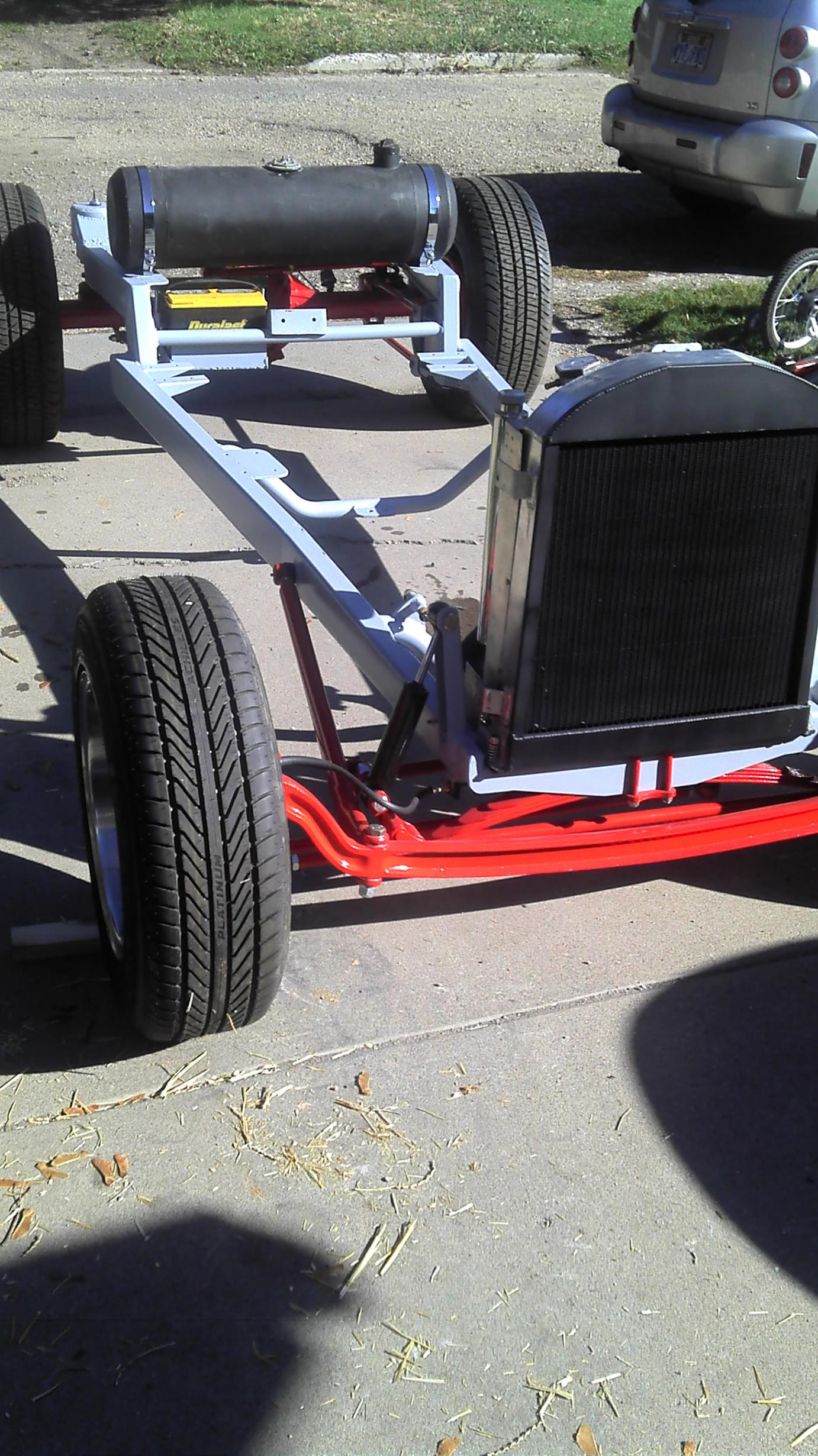

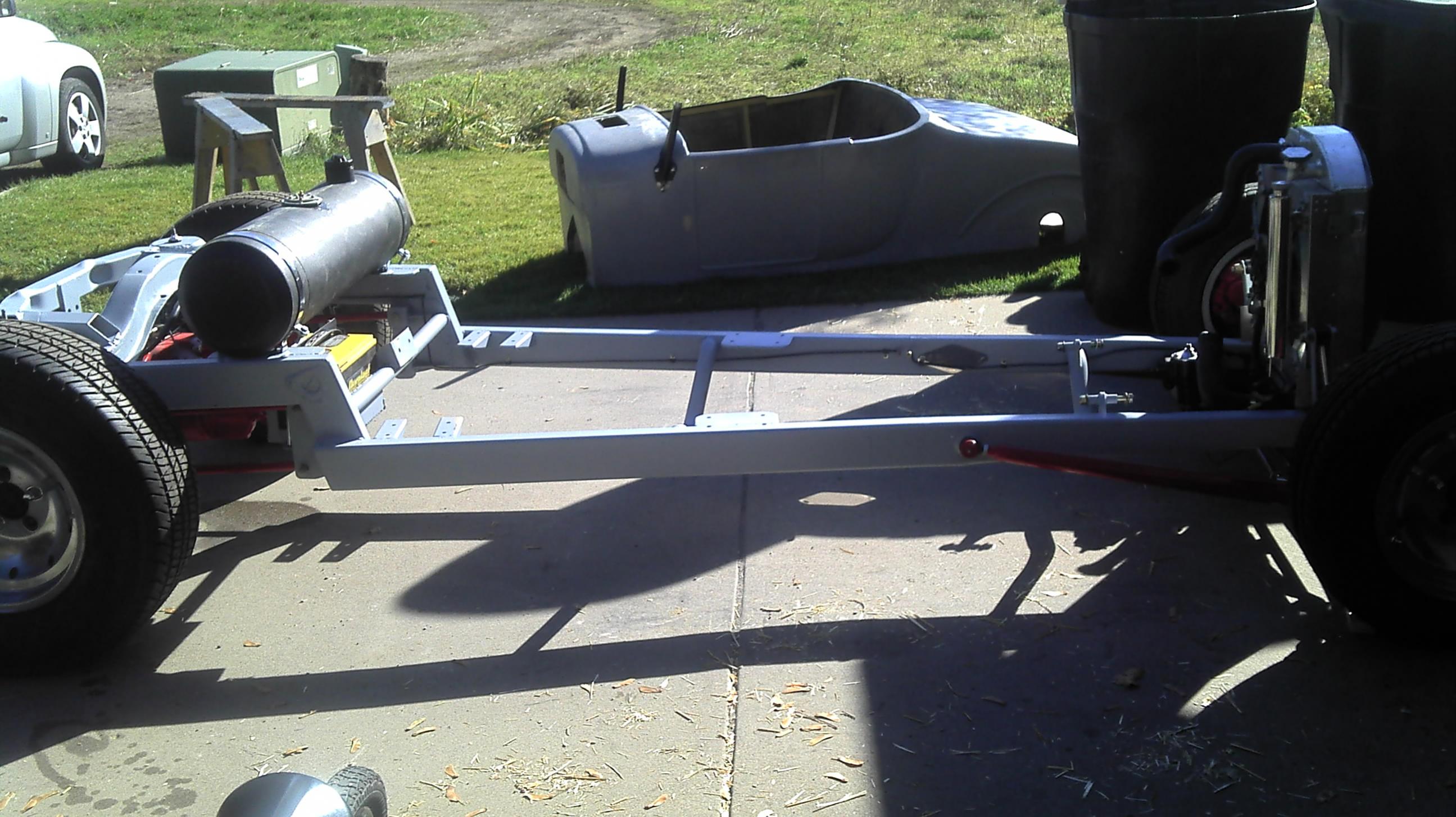

  15. t-rod
    Joined: Feb 7, 2009
    Posts: 432
    t-rod
    Since we're talking frame kick-ups, I'll show off mine,too.

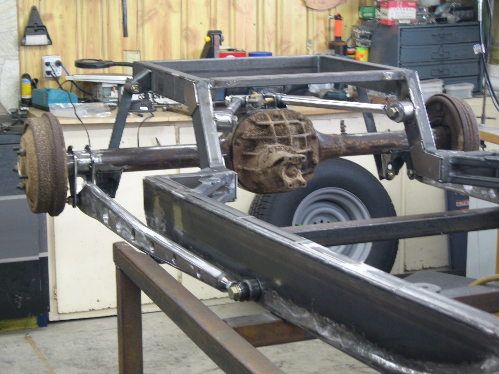

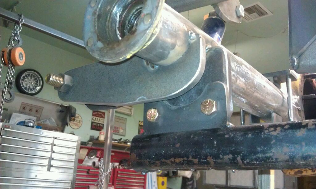

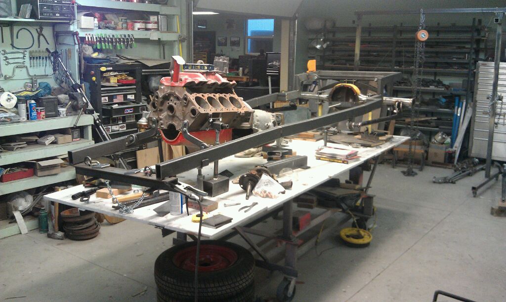

    Small update, I stopped by Bob the Builders today.
    RJ, I forgot to measure the rear kick up, sorry. I'm pretty sure its 5", but not totally certain. I'll try to remember to measure it next time.
    Time flies, and I didn't realize it had been more than a month since I'd been there... Wow! Keep in mind before viewing the photos that Bob has a total of 68 hours in this build so far. The clock started when we unloaded the car from the trailer. He has since dis***embled all the old, built the ch***is, and engineered a million things.
    The lower split bones are together and positioned, he hasn't begun the upper portion to make it a 4 bar, or the panhard bar. You can see how he slotted the bones and drilled the bottom to plug weld them. Lots of 3/8" and 1/2" plate here... Obviously the weak link is the 65 year old bone itself. :eek:
    Engine mounts are ready, and Bob plans to have the K member done next week. The pictures show a TH350, but I'll be running a PowerGlide. I want to have options later (easy ones) so Bob's building a TH350 mount that will be painted ch***is color, but stashed on the shelf until such time the PG takes a dump or I want a change.
    Shock mounts are in (and some temp shocks), set at 27 degrees. They'll settle at 30 degrees when loaded.
    Anyway, some other changes and Bob's personal projects have changed the timeline some. He'll be taking additional time to video this car for his video series... I can't remember if I mentioned that earlier. It's fine, we're not in a hurry and he's doing a great job. Hell, I couldn't do in 680 hours what he's done in 68! :D
