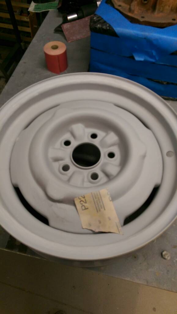

    Sanding/prepping for paint today.

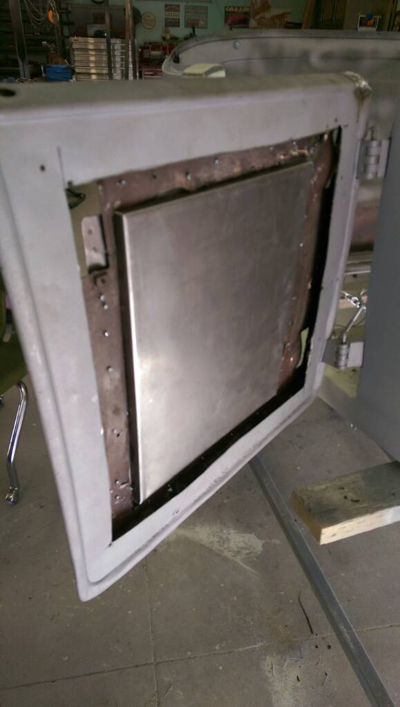

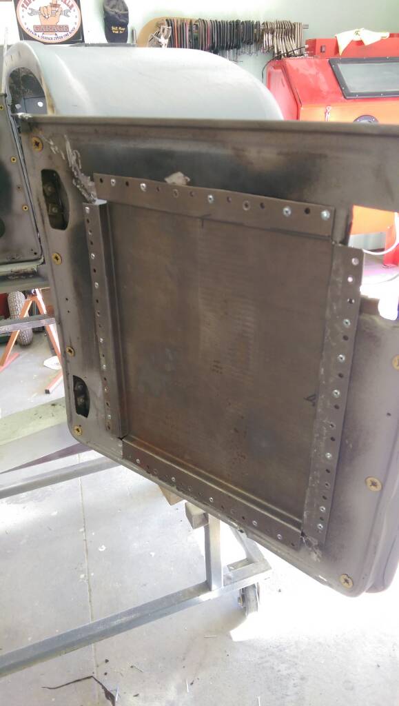

    While I was sanding the front and back of the wheels Bob started working on the p***enger door.
    Both doors will have map pockets but they're pretty small. Since we have to put a new inner skin in the doors anyway we may as well give it some structure too. Recessing the new panel 5/8" will give us a little more room for junk to get lost in there and it stiffened up the door considerably.
    If you noticed the pop rivets they're just there to hold everything together. Empty holes will be welded, pop rivets removed then those holes will be welded too.
    Outer skin to follow, then a map pocket for the driver's door.

  12. nitrobrother
    Joined: Dec 24, 2004
    Posts: 4,379
    nitrobrother
    Is there room for a couple of beads to strengthen it and reduce any tincanning?
    daddio211 likes this.
  13. Blue One
    Joined: Feb 6, 2010
    Posts: 11,511
    Blue One
    from Alberta
    One thing, I know that Bob knows what he is doing however..... I have found that for
    working on the outer skin of the door it is far easier to have the inner panel removed.
    That way the metal finishing can be done easier.
    The inner panel can go back in after the outer skin is right.

  15. daddio211
    Joined: Aug 26, 2008
    Posts: 6,012
    daddio211
    Yes, it will be welded. The rivets are there temporarily.
    Absolutely Larry, hence the pop rivets. The new skin will be welded on, the inner panel removed, body work finished, inner panel reinstalled and welded.
    Ha! Yep, making progress. And sanding wheels doesn't **** as bad as sanding louvers! Not that I like sanding wheels, either...

  16. daddio211
