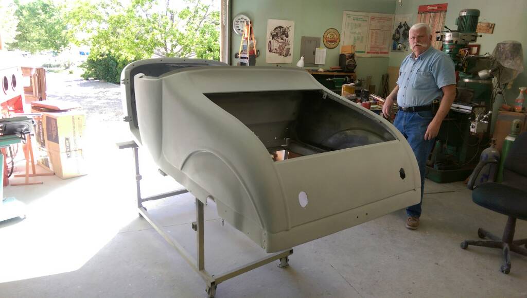

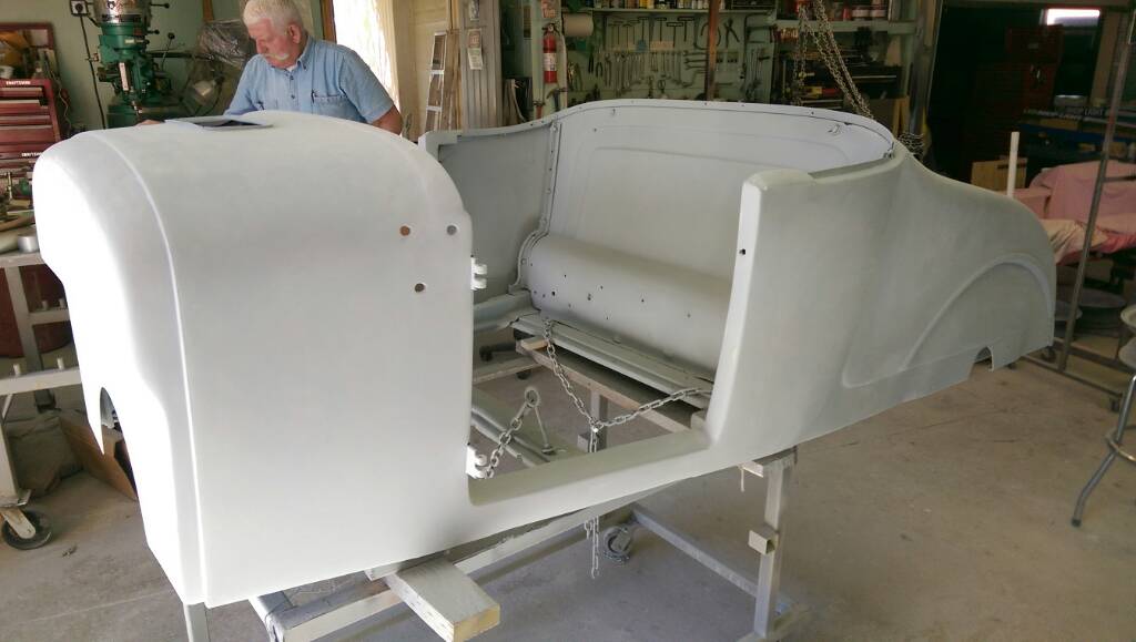

    Spent hours today sanding the wheels. Sanding ****s. One wheel had a few divots in it from rust, but we checked it closely after sand blasting. A little glazing putty and more sanding, and it's about ready.
    Bob has now primed and blocked the car with 220 four times. He started blocking with 320 today and will have it ready for paint in a few days. I think I've said that before.
    Not shown is the significant work Bob put into the driver's side bun panel. On the last prime he didn't like the way it was looking so he made a template and compared it to the p***enger side. He ended up taking the bun panel and the are behind it down to steel and reworking it completely. I hadn't seen a problem, but he wasn't happy and wanted it to be right. It's perfect now.

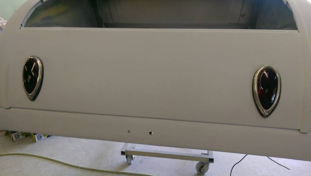

    I was running late and Bob already had the booth cleaned out. He was hanging new 48" LED lights in place of the old fluorescent lights. Man, they're about twice as bright! It'll make painting dark colors easier for sure.
    So.... I helped with a few of the lights and did a few little things to the body. I filed the taillight holes and made sure the teardrops fit, filed a few small holes for detail stuff and chamferred the edges.
    Then I spent about two hours brushing and blowing all the **** out of the holes, seams, subrails, etc. Now I understand why body guys ***** about media blasted bodies! What a pain in the ***! Sand, bondo dust, garbage, bugs, everything you can imagine.
    Paint should fly tomorrow and this should be the last time I post a picture of an unpainted car. Well, THIS unpainted car at least!

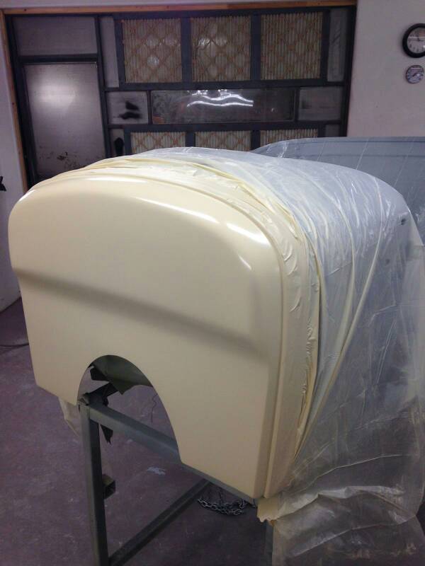

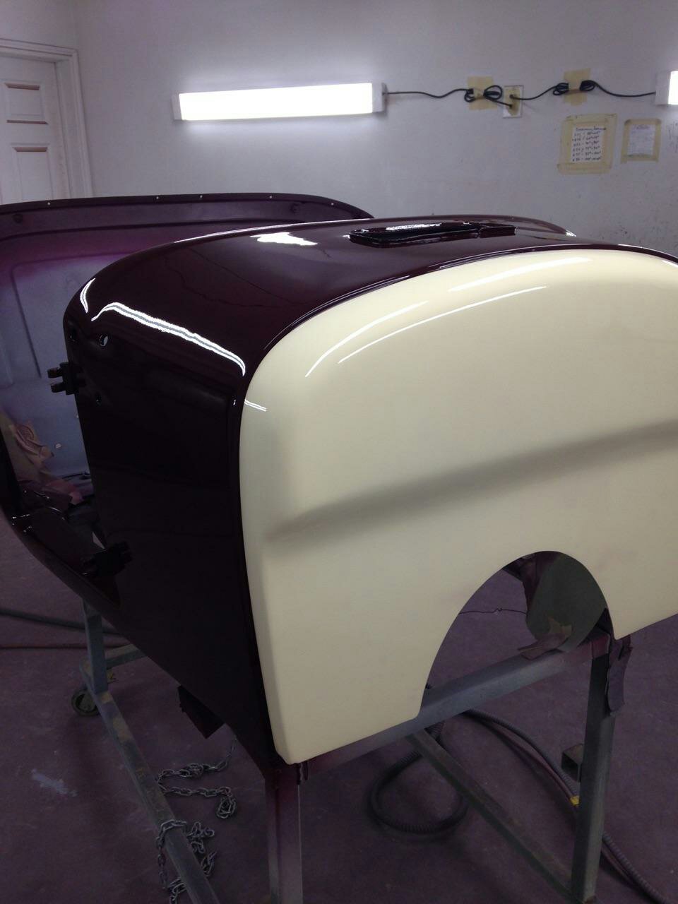

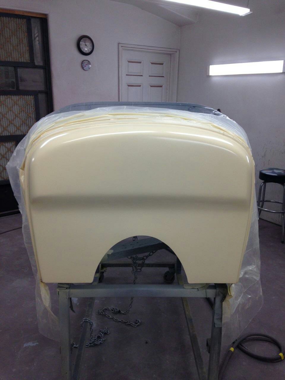

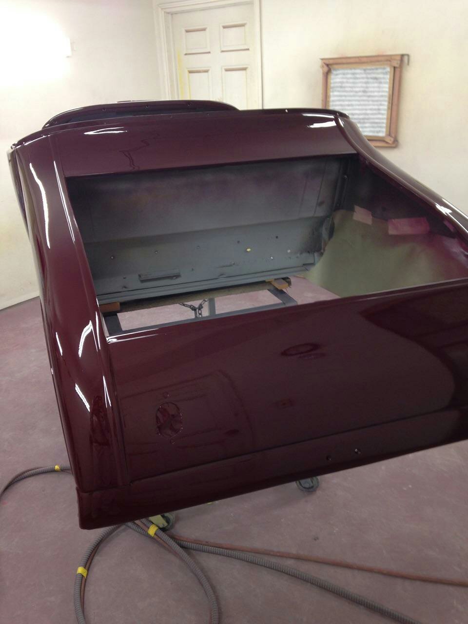

    Well, Bob started sending pictures mid-morning today.
    Firewall...
    Body....
    Clear coat...
    Can't wait to see it tomorrow!!!
  15. tomkelly88
    Joined: Aug 31, 2010
    Posts: 382
    tomkelly88
    Wow that looks good, great progress!
    I like that creamy white firewall
    daddio211 likes this.
  16. daddio211
    Joined: Aug 26, 2008
    Posts: 6,012
    daddio211
    Thanks Tom, Victoria picked out the colors. The engine and A grille shell will be maroon and the steelies will be cream.
    volvobrynk likes this.
