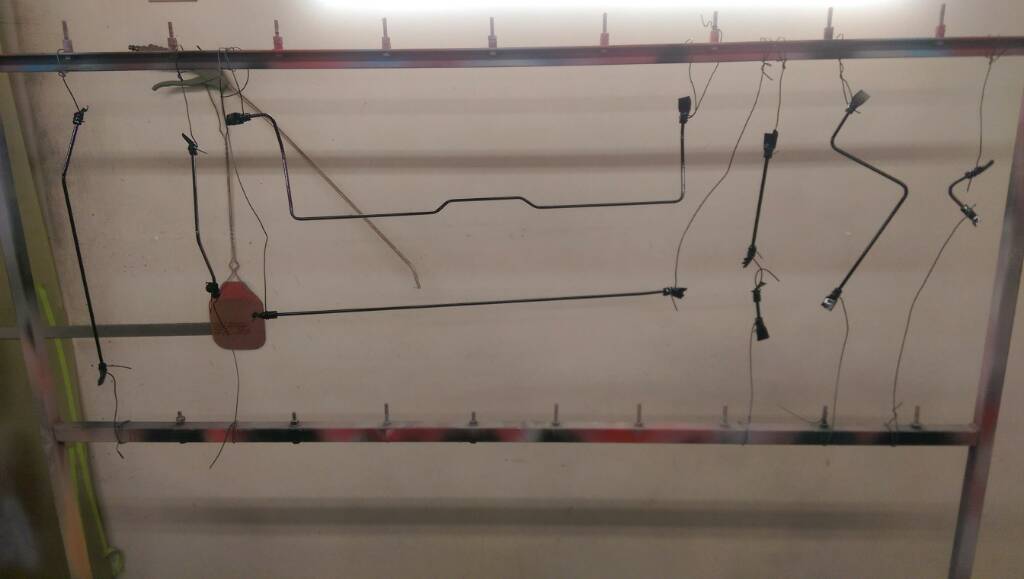

    So anyway, not a lot has happened on my end and Bob's been waiting on me. Bob did get more parts painted including brake lines, trans mount, etc.

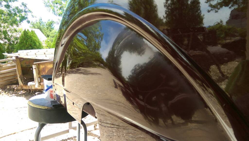

    Well, with some instruction I'm not too bad at the cut n' buff thing. Bob had me do the inner fender wells to develop a little technique and understanding of the process. Still have a lot of learning, and this isn't the best picture, but it's like gl***.

    Top stuff, go easy on the edges:cool::cool::D JW

  15. Yeah what he said, too darn easy and it happens so darn quick to burn through a edge. And please don't ask how I know...

    Learning as I go and SO FAR haven't made any mistakes. Both rear wheel wells are done and look terrific! It's really tough to get a good shot of this as it looks kind of streaked and cloudy. Oh well, trust me, it looks great!

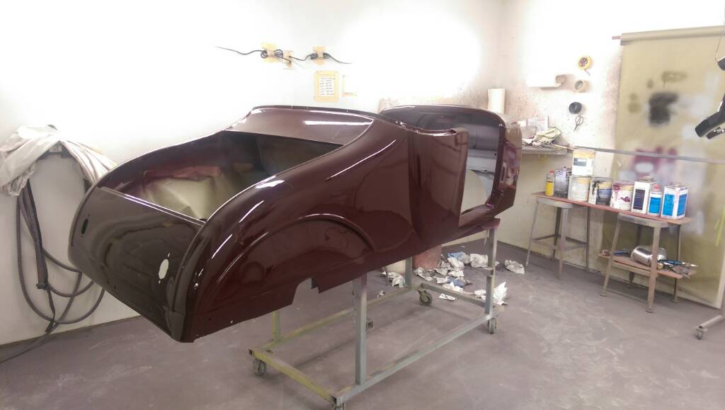

    Tomorrow I'll work on the firewall, then the rear panel below the deck lid, and if there's time, the tulip panel. Wish me luck! :grin:

    Well my luck ran out. I have sand scratches on the tulip panel, but I think I can res and and buff it out.
    Firewall...
    Taillight pan before. Lots of orange peel and a little garbage.
    Cut it with 1000/2000/2500...
    Round one with the buffer...
    Round two!
    Tulip panel getting cut with 1000...
    And round one with the buffer.
    I went further with the buffer but the number and depth of the scratches kind of let the wind out of my sails. I'll hit it again later this week.
    I also rebuffed the fender wells and they look amazing. I'm learning still, and need to learn when and where to stop especially near edges. I haven't gone far enough out as you can see in several shots. It will be corrected.
    Not sure if I'll do bigger panels like the cowl, doors, deck lid. Not that I'm intimidated but I really don't want to screw up a big panel and have to repaint it!

    Eric, are you color sanding all the way to 2000 grit? Gotta get all of those co****r scratches out......dark colors can be a *****.
    I absolutely hate color sanding and buffing........but the end result is worth it!

    Yep Steve, starting with 1000 but stopping before the orange peel is gone so I can use that as a gauge when sanding with 2000. Once that looks good I'm going over it thoroughly with 2500. These are all wet paper, soaked in a bucket and using a spray bottle to keep the surface wet. I'm probably stopping too early with the 1000 but I'm trying to err on the side of caution, even if it means more work.
    I'm pretty sure the scratches came from a small tear on the edge of the 1000 grit paper. I'll start with the 2000 again, then work up to 2500, then buff.
    The color and depth are phenomenal!

    Eric, Do yer 1000 as you already are, then go to 1200, then 1500. 2000, 2500, 3000,4000. Then all ya gotta do is a finese finish.
    Looks like yer not gettin the 1000 out goin to 2000, Doesn't take much longer to do the 1200/1500 cuts. Try it U'll like it.
