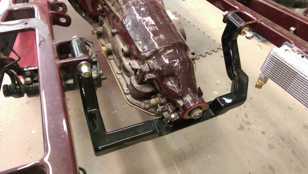

    We went to install the trans crossmember Bob built but had a problem. The plate and moved the transmission back a 1/4" and now the holes don't line up. That's a perfect example of how close of tolerances he builds everything to. The 1/4" difference was my bad because I didn't know I'd need the starter plate. We'll elongate the holes on the mount and it'll be done.

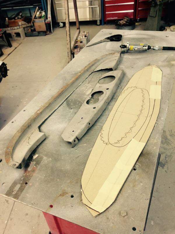

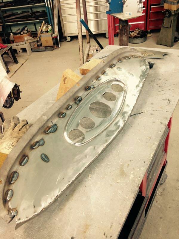

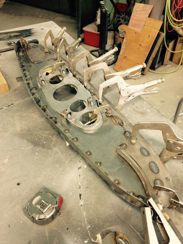

    A fellow HAMBer saw my dash insert plight and sent a message offering to help. He takes old guitars and builds customs out of them and is just the guy to do the mother of pearl dash insert! Thanks Chris, looking forward to working with you!
    And not a moment too soon! Bob sent these pics today while building the new dash. We wanted a '32 shape to it but it'll hide a few tricks. Nothing that hasn't been done before, but it'll keep everything looking real sanitary.
    Here's today's progress.
  20. 26 T Ford RPU
    Joined: Jun 9, 2012
    Posts: 12,604
    26 T Ford RPU
    That new dash will suit the rest of the build just fine, looks real cool. :cool::cool::D JW

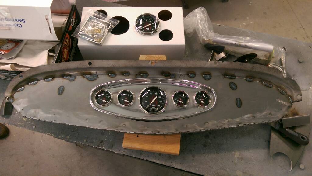

    Not much of an update, but I did make it to Bob's yesterday. We didn't accomplish anything, but sat and BS'ed for two hours and planned.
    He got a few things done this week though. Dash is almost complete.
    And the transmission cross member has been modified and installed.

    The placement of the gauges looks very clean, is the tachometer going to be mounted somewhere else or omitted and will the steering column be recessed into the dash panel or will it be below it? Cant wait to see the Pearl behind the gauges...........COOL !!:cool::cool::D JW

  26. Atwater Mike
    Joined: May 31, 2002
    Posts: 11,618
    Atwater Mike
    Where did the center insert come from? (is it polished aluminum? Very s****y!)
    daddio211 likes this.

    Thanks as always brother! The tach will be mounted in a chrome cup on the steering column and the column will be coming up through the floor at roughly a 70° angle. I'm not a fan of vertical steering, but the Mustang steering box ultimately dictated the angle. So to answer the other question, no, there probably won't be any column bracing to the dash. Bob and I discussed it yesterday and he's built many columns this way. He's confident it'll work perfectly and that all I need.
    Mike, it's a cast aluminum piece from So-Cal. It came with an engine turned aluminum faceplate but will be pearl guitar pick guard material very soon.
