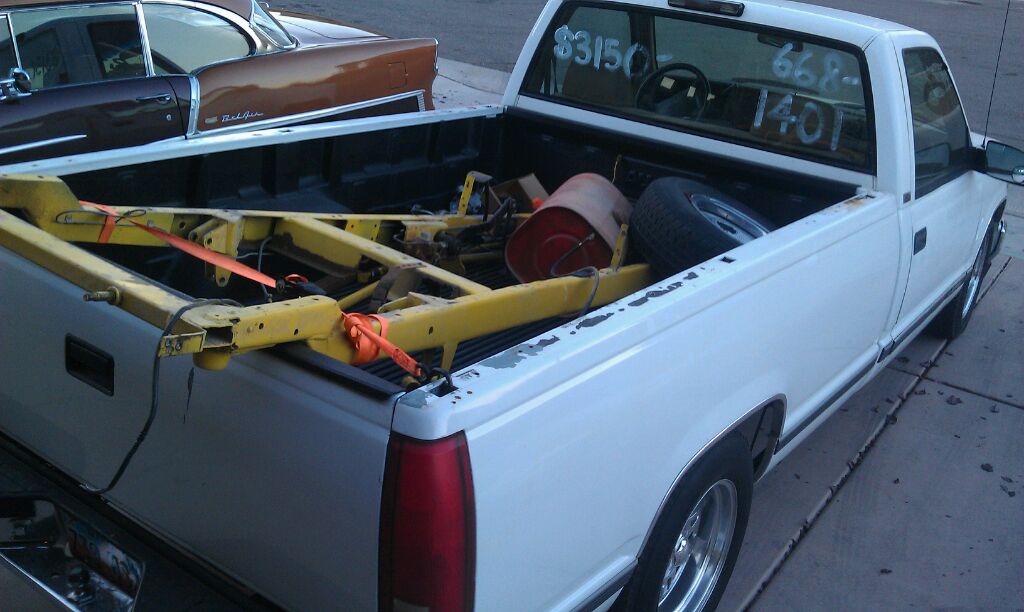

    Such a GORGEOUS day here, low 70's meant time to cruise with a bunch of buddies to a shop tour. Wife and son jumped in the '55 with me (the one for sale in my signature - shameless self promotion!) and we had a great morning.
    Got home, jumped in the truck and went to get some parts out of Bob's way. Old A ch***is, fuel tank, suspension pieces, etc.

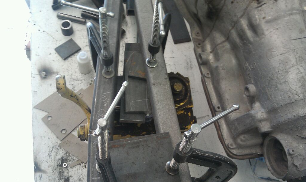

    The K member is in progress with the bushing mount for the brake pedal in place. Chances are slim that the Delron bushing Bob is making will wear out, but the whole ***embly will be removable for maintenance if it does. If it weren't removable it'd be a nightmare to service!
    These are the kind of thoughtful details Bob plans into every build that make a huge difference down the road.
    And just a quick shot of how the rear of the K member will tie in to the rear rail...

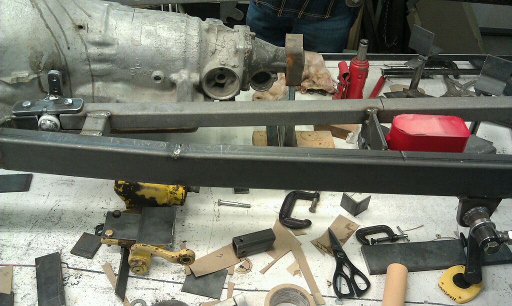

    Update from this past weekend.
    Bob and his wife have been recovering from a nasty cold, but he still manages to plug along.
    Both sides of the K member are now roughed in, and more importantly the MC, pedal and linkage are figured out. This puts the MC under the driver's seat, which is fine as the seat bottom will be easily removable.

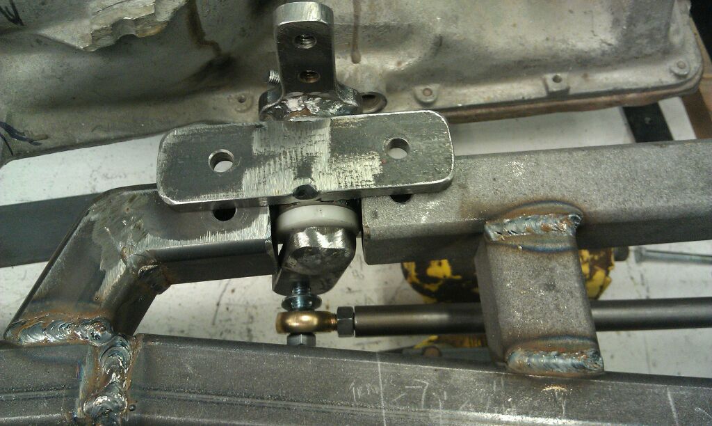

    Here you can see the mechanism Bob built for the brake lever. I'm drawing a blank at the moment... bell crank? Did I get that right?
    Two bolts and the unit slides out for service.
    Not that the delron bushings he turned on his lathe will wear out, but if they do they're easy to service. A small service panel will be located on the driver's footwell to ease removal and servicing.
    A shot of the other side of the bell crank...
    And a shot of the MC mount...
