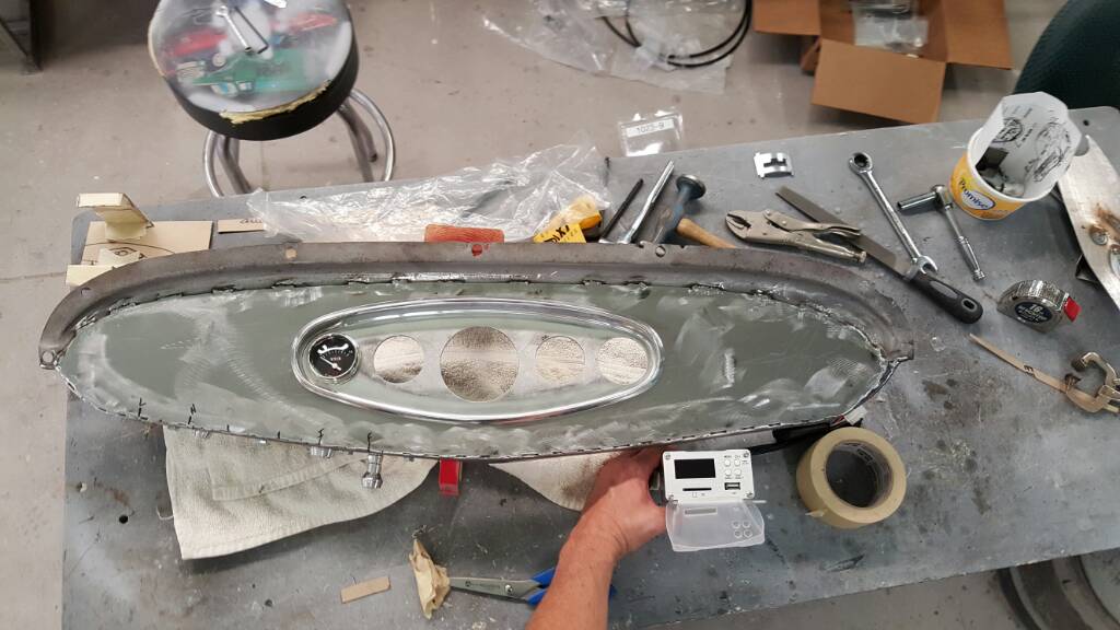

    Making headway. Bob has been working on the dash a little more as the ends have been welded in and rough finished. Also, I didn't want anything sticking out of the face of the dash besides the gauge panel, so he mounted all of the switches underneath it in a cool little removable panel he came up with. @da34guy turned me onto that clean and cool look years ago.
    The bolts you see will be replaced with stainless ****on heads up final ***embly.
    The stereo will be mounted up and under the dash. You shouldn't be able to see it unless seated in the car. It's a weatherproof motorcycle unit with FM, USB and smartphone connections. It's supposed to be 600 watts (doubtful, I've done a LOT of car audio) and four speakers. As long as it's loud enough to hear at 80 MPH we'll be good. Speakers will be mounted under the dash out of sight.

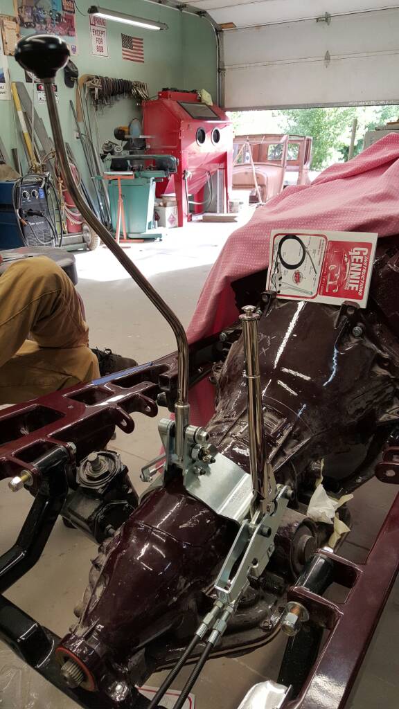

    My son Austin and I mounted the Gennie Shifter shifter and emergency brake this afternoon. Guys, if you haven't looked at Gennie in a while you need to. Absolutely EXCELLENT quality and customer service! I won't be buying Lokar anymore.

    I see your shifter has a fixed position with the mount plates, mine (Hoffman Group junk) was multi fit and thats where im having my trouble. Shifters are not cheap in NZ, especially good ones. :( JW

    I can't begin to explain how nice this Gennie Shifter is. What me to send one to you? I can't believe Hoffman is still in business.

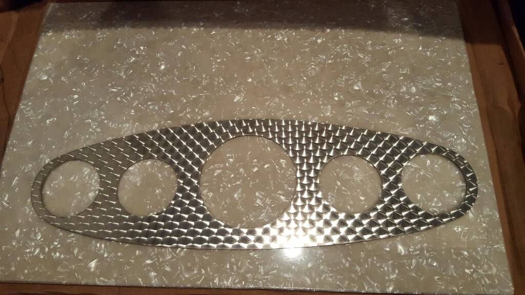

    So this celluloid showed up today. I dropped the engine turned blank on top for fun.

    A question about the Gennie shifter.
    There is no push down like Lokar, correct?
    I'm wondering how the Gennie would be for manual shifting of my C4.
    I'm not sure I like that aspect of the way the Lokar works.
    Can you possibly explain the difference between the two shifters in the way they operate?

    I think I can answer all of your Gennie Shifter questions with one of their pictures.
    Instead of pushing down (or a ****on to push down) it's spring loaded and gated to the side. Pull toward the drivers side, then back. Slide it through the gate to select your gear. I like it a lot.
    It includes an adjustable neutral safety switch, like Lokar. Two wires to a contact closure. Does that help?

    Actually, I think this pic shows it better because the labels appear here....
