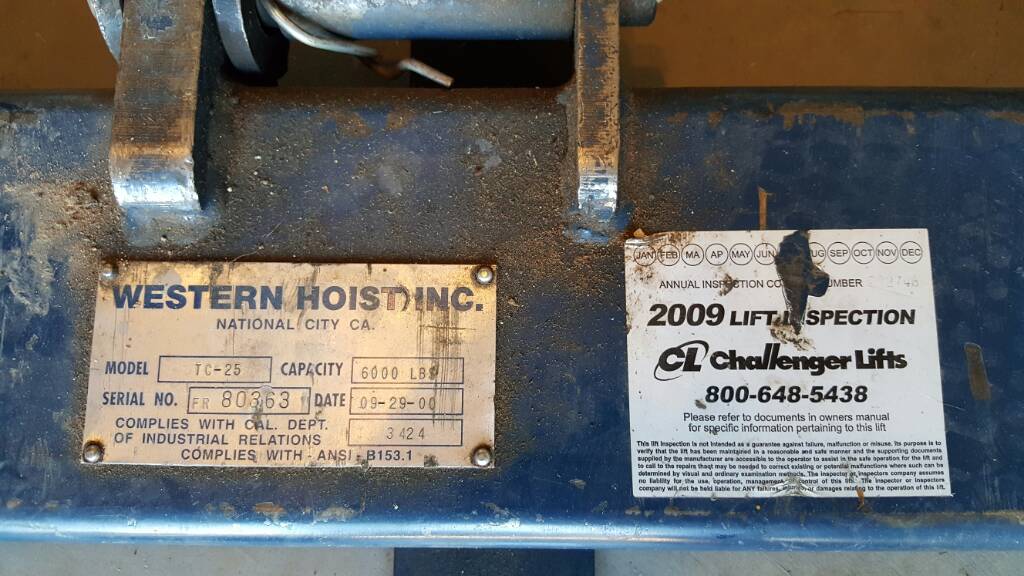

    For those who were interested in my lift here are some pics.

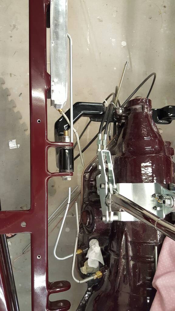

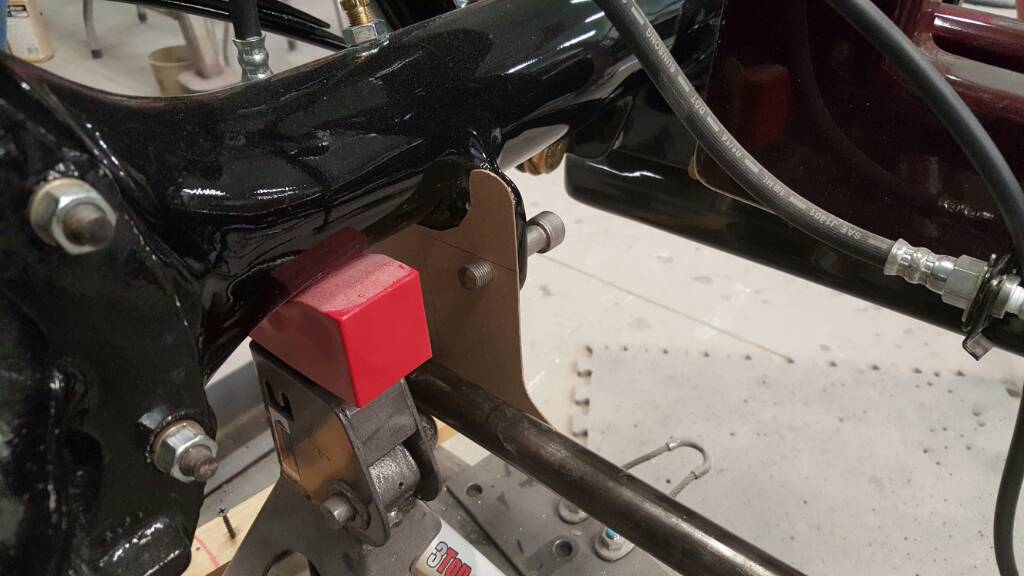

    I bent up a few lines tonight for the trans cooler. The bare ends will be flared and I'll use rubber tubing to connect them in an effort to isolate any twisting or vibrations. Ends are staggered so that the clamps on the hoses are easier to access.
    Waaaay back we discussed the vulnerability of the 75+ year old split rear bones. Bob and I decided to beef up the rear end by running an additional set of bars inboard of the frame rails. Templates are made and the bar is in place.

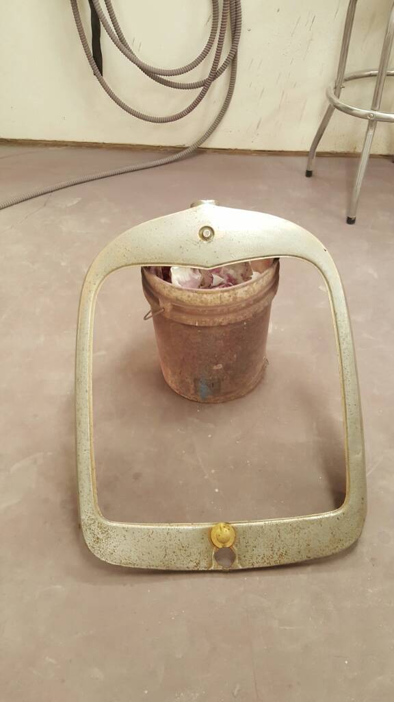

    And a shot of the '28 grill shell I'm using. Needs a little work and it's pitted, but it will get several coats of high build primer and be painted maroon.

    You will need to support those trans lines as they will still fatigue if unrestrained. This is what I did for my power glide. JW

    Sounds a lot like life, some sad days, some happy days and family and friends to help celebrate the good times and to mourn the bad times. Yes, you want to support those lines to prevent failures, otherwise keep up the good work.

    Thanks fellas. Jeremy, you're absolutely right, thank you for double checking me!

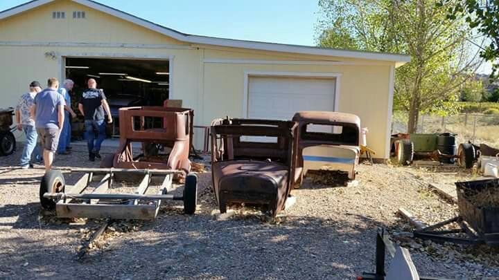

    So Tuesday six hot rodders from the Netherlands stopped by. @corvettesander and friends and family. We hung out at my house for a short while, I showed them my '50 shoebox and '54 COE then went to Bob's. I'll post the pics Sander posted on Facebook of their visit.
    What a GREAT bunch of guys! If you're not familiar with @corvettesander search here for his COE build. Seriously cool ramp truck!
    Bob's been working on little things like finishing the dash and getting it ready for paint. Hope to see that, the deck lid and the grill shell all in color soon.

    Absolutely, so those coupe bodies are your's? I am getting even more jealous than I have been! :rolleyes:
    volvobrynk and daddio211 like this.
  13. daddio211
    Joined: Aug 26, 2008
    Posts: 6,012
    daddio211
    No, those are all Bob's. However I do have an original T coupe in running condition stuffed away in a secret location...

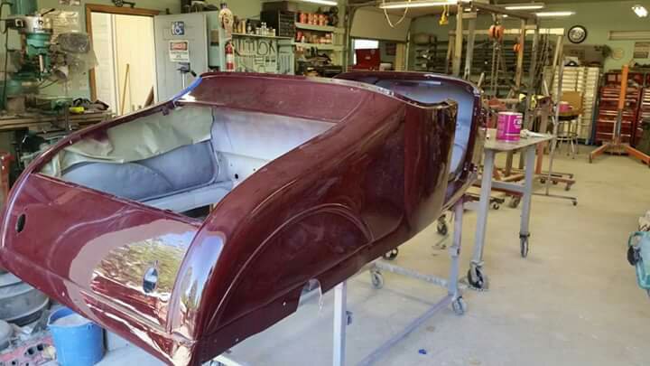

    Sanding, sanding, sanding. There were a few sags in the clear on the inside of the doors. Not likely they'd ever be seen, but ya know ya can't just leave 'em there! 1445720956568.jpg
