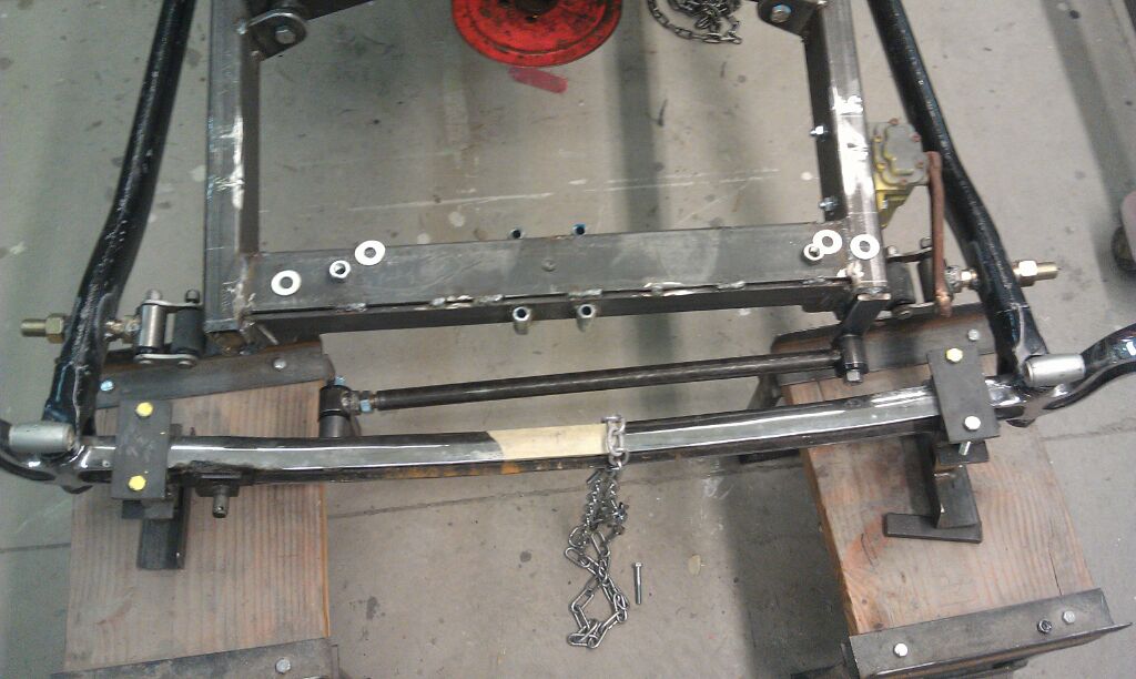

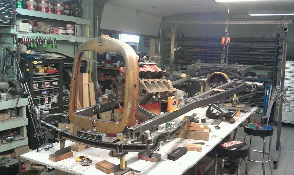

    I arrived at Bob's yesterday to find the TH350 mount was done, and the front crossmember well under way. Bob wasn't sure how I wanted long I wanted the front frame horns so he waited for me before cutting cut them off.
    I said "I want 'em short!" so we measured, marked, drilled pilot holes, and Bob started cutting.
    Here's where it gets interesting. I actually worked on the car for the first time! Shhh... don't tell anyone but I ground the cuts flat and beveled the edges so that they can be capped with plate later.

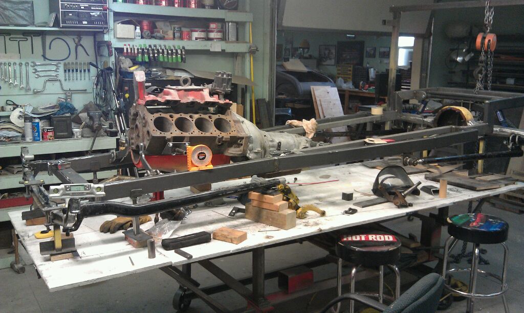

    Then we started mocking up where we wanted the front suspension to "sit". We got it square and where we were happy with it.
    Because of Bob's careful planning, the rear of the bones will attach at the same elevation as the rear bones, making a nice aesthetically pleasing transition and keeping them parallel with the frame rails. All of this and the driver's side measures a perfect 5* of caster!
    And before anyone points it out, yes the split bones are upside down. This gives us the additional clearance for the steering linkage which will run right under the spring. This was the plan from the beginning.

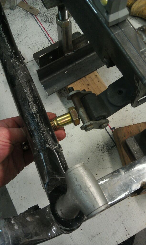

    Then we measured the p***enger side and found a problem. The p***enger side measured 7* of caster! With the kingpins in you can see the difference.
    Oh the joy of using old parts! We'll take it to a diesel shop and have it untwisted. You can actually see the twist where someone, long ago, welded a plate for a panhard attachment. I've had this axle for 15 years and never noticed it, but I also never had it on the road.
    Bob spent some time figuring how he was going to drill and sleeve the wrists of the bones. I cut some round stock for the sleeves (no pics, boring) which Bob will bore in the lathe. I didn't have three hands but with this picture you have an idea. Bob likes making his own parts when and where practical, and will fab these bolts to hold the wrists of the bones. He shows in detail how he does this on his first DVD.
    That brings us back to last night's pic of where its at now. Thanks for following along.

    Being a welder I tend to notice things like this. :)
    Porosity in the welds. Some repair and grinder work will be in line for the welding it seems.

    You're completely correct and I also noticed those areas, and a few others too. Bob ***ured me that this is all the rough in, all areas will be ground (grinded?) and finish welded.
    Please know, I WELCOME such critiques! There is no reason for me to get **** hurt over someone pointing out a potentially dangerous situation or poor choice! Thanks Blue One for helping keep my wife safe! :)

    Being a welder as well, IMHO the only reason to "fix" those welds would be cosmetic. Although we can only see the one angle, the width and thickness would infer plenty of strength.
    Oh - AWESOME build - and I really like the way he's got it laid out on the table at seating height.

    Thanks man. Bob's a great builder and I should really see if I can scan some of the photos on his shop walls of some of the cars he's built. He did have a '27 track T that won a cl*** award (1st place) at GNRS in the mid eighties.
    He built his first cars on the garage floor for years before figuring out the seated working position was optimal, LOL. Watching him work is really a treat. He takes the time to do everything the "right way". He's a big guy and certainly capable of lifting and heaving things into place, but methodically uses tools to do the hard work for him. When I wonder why he's taking the time to use an A frame and chainfall, he shows me how much quicker (and safer!) it is to do it right. He teaches a lot of this in his DVD series.

    That may well be true, but the cosmetic factor alone would be reason enough for me.
    Sloppy welding just looks bad even if it will in some cases be strong enough to do the job.
    As far as weld faults like porosity, I tend to wonder if they are there and visible, what other problems (like lack of fusion for instance) might be there and may not be as visible.
    All weld faults have varying degrees of severity, I like to be sure of a welds integrity, visual inspection is probably the first step.
    I think that since he is an experienced builder he will fix any potential problems and pretty things up.

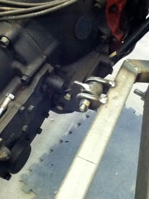

    Mock up engine and TH350 are out, 283/PG that will be used are now in. Trans mount for the PG is under construction.

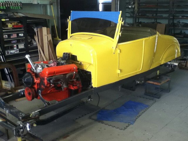

    The wife and I had planned to get to Bob's yesterday, but weren't able to connect. He needs to fit the seat, steering and pedals to her and we'll do that tomorrow afternoon hopefully.
    Bob did send pictures to me today though, and I'm more excited about the progeress than ever before. Sometimes little steps make such a big visual difference.

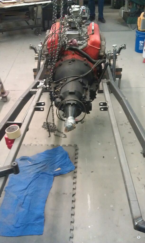

    Last photos had the rear of the engine and trans supported by a chain while Bob finished the PowerGlide mounts. Those are now finished...
    P***enger side:
    Driver side: (creative clearance around pedals)

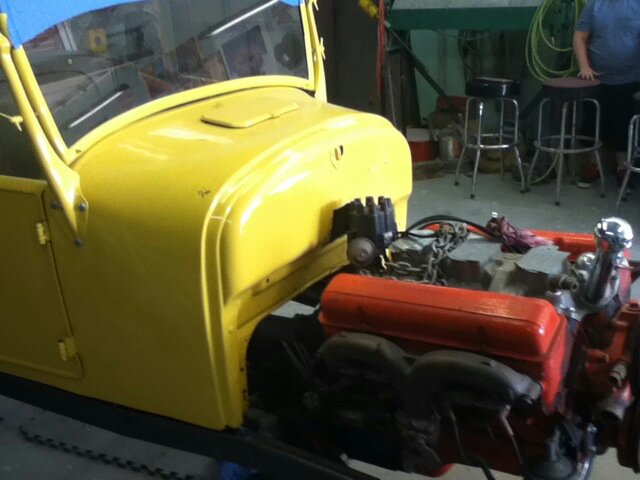

    Body on the ch***is again!
    More pics tomorrow hopefully!
    Sent from my DROID device using the TJJ mobile app

    The body IS in pretty nice shape but as you can imagine, has a few issues. There is some bondo in areas, but I don't think we'll be taking the whole car down to bare steel. The worst spot is on the tulip panel, just behind the p***enger, where there's a hairline crack in the paint. Chances are good that it'll be worse when we dig in to it, but overall the car is really solid for being painted 20 years ago.
    It's whatever you want it to be!

    Fun to see the body mated up with the frame and engine. Looking great!!
    This is nice to hear for once. I don't subscribe to the "take it all down to bare metal" theory.
  25. daddio211
    Joined: Aug 26, 2008
    Posts: 6,012
    daddio211
    Yeah, its pretty exciting to see it coming together! If I were to do it myself I probably wouldn't have the first lug nut off yet... hence having Bob build it!
    I'm okay with not stripping the body down too, just giving attention where needed. Besides, this build doesn't call for "that" level of detail, and we can ALWAYS go back and do bodywork, right?
    I think Bob wanted to strip it completely, but we'll DA it and respray. Of course AFTER we fix the problem areas.
