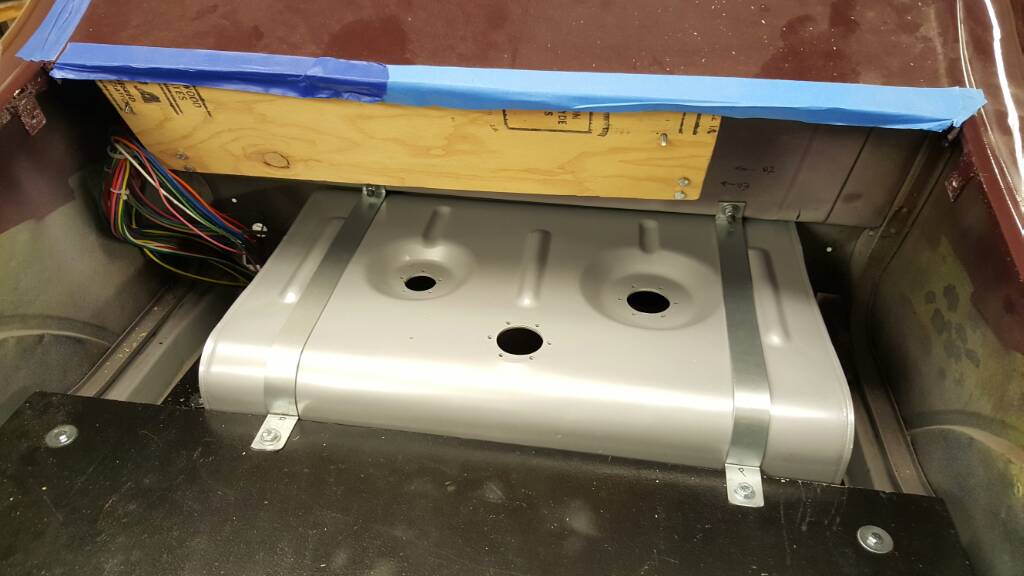

    Went up to Bob's tonight and accomplished a little more. I ran out of electrical connectors last time so I bought more and finished tying the lights and ground on the dash together.
    Had to make some major adjustments to my original wiring plans. I had built the trunk upholstery panel and door for the fuse panel and was pretty proud of it, but it just wasn't very practical. I had planned to run a Centech fuse box and do all of my own wiring but decided it would just be quicker to use a Rebel kit I had bought several years ago.
    I wanted to keep it in the trunk, but still accessible. With the cowl vent, heater, stereo, etc. under the dash there was just no room there. Well, no room if I ever needed to access it again! Because of the length (or lack thereof) of the wires I decided to mount it as far forward as possible in the trunk, but it still had to "look right" and be functional.
    I decided to switch the gas tank to the right and battery to the left, putting the fuse panel above the battery. Bob made a cool little bracket to mount everything.
    The door hinges down and can be removed from the hinges, then the whole panel can be pulled out to work on. The fuse box and voltage regulator will be mounted to the inside of the door. The outside will be upholstered.
    So I began stringing wires...

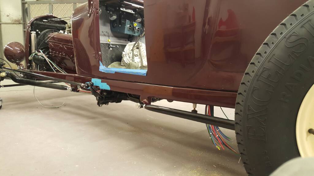

    I knew I'd have to lengthen the dash portion of the harness, just not this much!
    Yeah, those are the ends of the dashboard group hanging in front of the rear tire. Looks like I need six to eight feet of 28 different colors and gauges. "Hello? Rebel? I need some stuff."

    Hit a car show this morning with the black roadster. Saw a lot of friends I haven't seen in a while.
    Drove it up to Bob's and worked on the car for a few hours. Mounted the new fuse panel and built some small spacers for the gas tank.
    Fitted the gas tank...
    And bolted it down.
    The door is removable so I can bring the wiring toward the back and make it easier to work on.
    And the heater hoses are a done.
