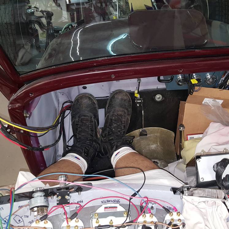

    A while back I ordered a blinker ***embly from United Pacific. Not thrilled with the quality but it's okay, but they only give about a foot of wire with it. I wasn't about to splice wires inside of the column so I blew it apart, strung new wires long enough to reach the fuse box, and resoldered everything.
    Moving along, I sat down in the car and finally finished wiring the dash. I need to clean my boots.
    And installed it.
    With the wheel mounted I'm thrilled with how it all came together.

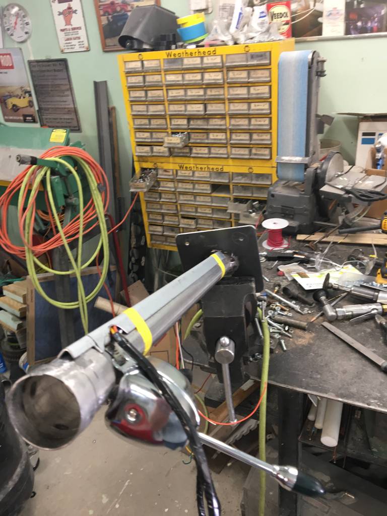

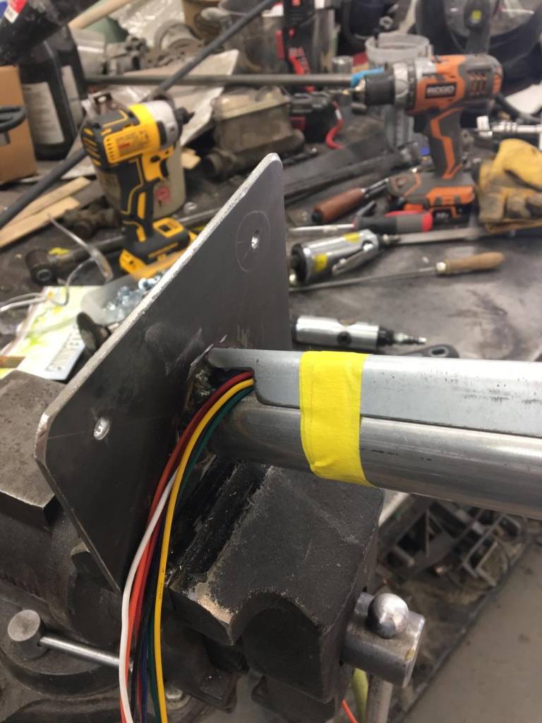

    Progress...
    Exhaust tubing with Delron bushings, belled end to match the size of the steering quick disconnect, and a conduit (of sorts) to route the wiring through for the turn signals and tach.
    Lot of work here, even if it doesn't look like it, LOL.
    The tach will be mounted to the column next. I had planned on it being to the right side of the shaft over my right knee, but it interferes with the Gennie Shifter. We moved it down to the back of the column, but still high up. No effect on getting in or out of the car.

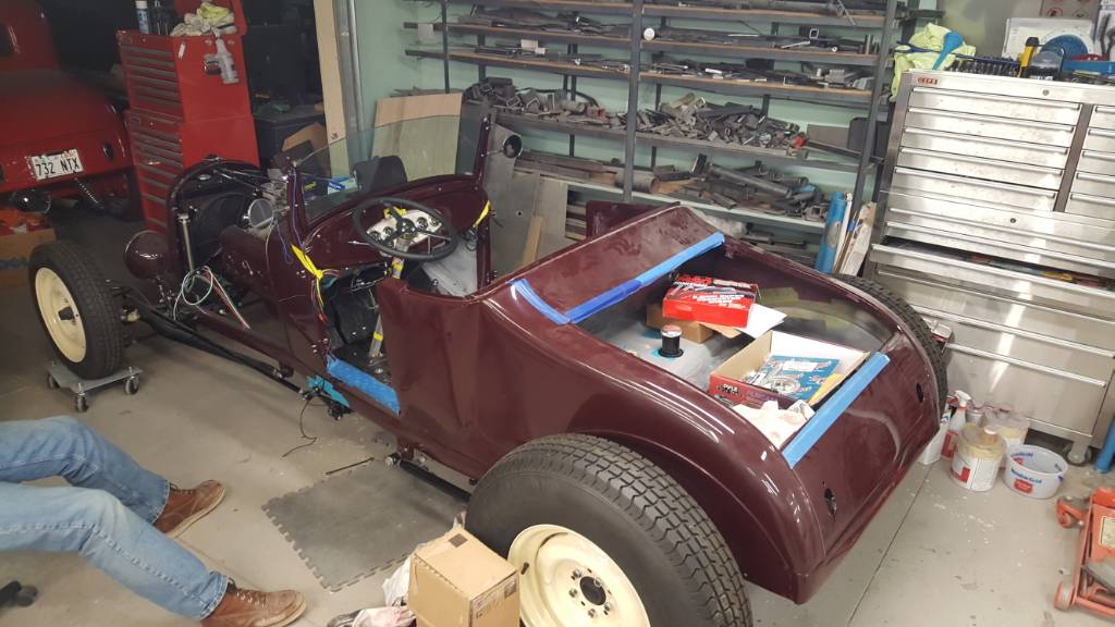

    Need to complete the wiring still, but the column has to be finished first. Not much left to do though.
    Need to have a driveshaft built, put in all the fluids, find upper and lower radiator hoses, cut and buff the doors and finish polishing the paint. Oh, and put the headers on...
    When the car goes for interior we'll have the headers chromed.
