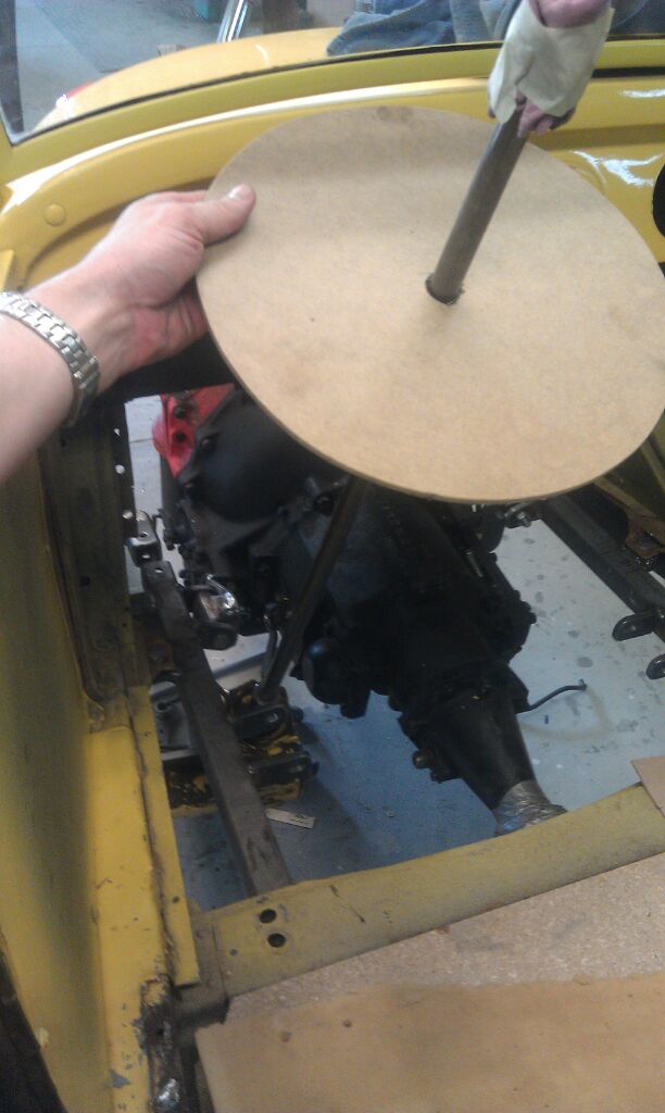

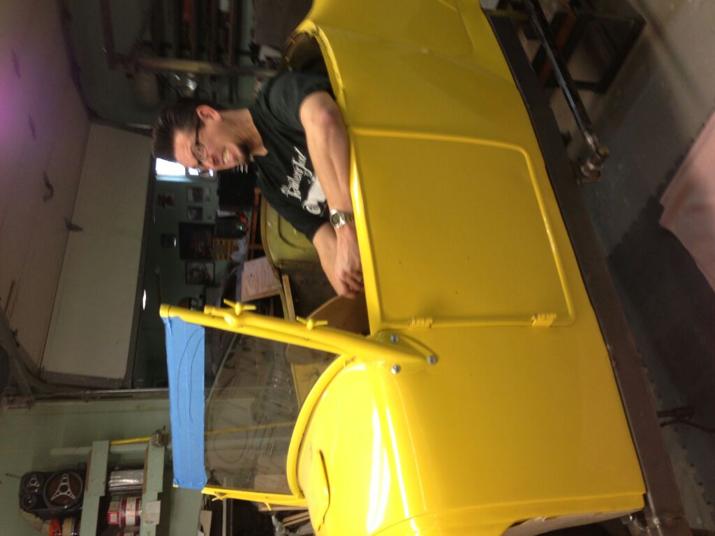

    UPDATE! We finally got up to Bob's today. Bob put some foam padding and boards on the floor and back to adjust seating height so we could plan for the steering wheel and shaft. One of my bigger pet peeves about T's is that most people look like they're sitting ON them, rather than IN them. I want to be LOW inside the car, like you should be in a deuce with a chopped windshield. We ended up taking all but 1" out of the seat riser and a 3" section of medium foam.
    We're using a Mustang box that will be located fairly far back, and the steering shaft will be fairly vertical, about 70 degrees. Although I don't like bus-type steering wheels, this accomplishes two significant things. First, I've gained a lot of leg room by having the steering column NOT penetrating the firewall (I'm 6' 1" and 210 lbs). Second, it avoided using a Vega box, which I have one and have nothing against but it wouldn't be right for this build. Technically, an F100 box would be perfect but it just interferes with too many other things. Believe me, we tried.
    We also worked on headlight placement and other details, but nothing photo worthy at this point.
    Thanks for following along!

    You look a happy man Daddio and with good cause. My T has an F-1 box and i had to offset my small block 3/8'', have no idea how it had a Hemi in it !! Looking good man, very cool. JW :)

    Larry, I turned that picture every possible way on my phone and it always loaded here at that same angle. I figured I'd fix it this morning but now I don't have to, thanks!

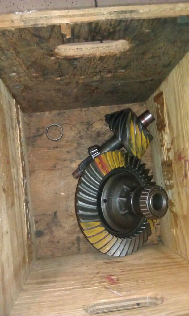

    Doorbell rang earlier, wife said my buddy Robin came over. Struggled, but I got up to say howdy.
    Robin and I had talked about it before; the rearend gears I had were way too short for the anticipated driving we'll be doing in the roadster. If I remember, they're 4.11's and I need something highway friendly.
    Sitting in the trunk of his '57 Bel Air was a wooden box labeled 2.75, and in it was a ring and pinion. A quick count of the teeth (13 and 29) tells me its a 3.00. PERFECT!!! I suspect it had a 2.75 in the box originally, and the 3.00 got stuffed in the box when the 2.75 went in.
    Hopefully they'll fit my carrier. If they do Robin said "just give me whatever you think its worth. It's just wasting space in my garage." Great guy!

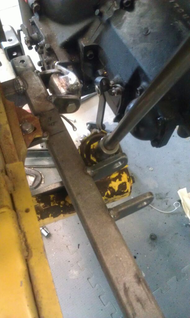

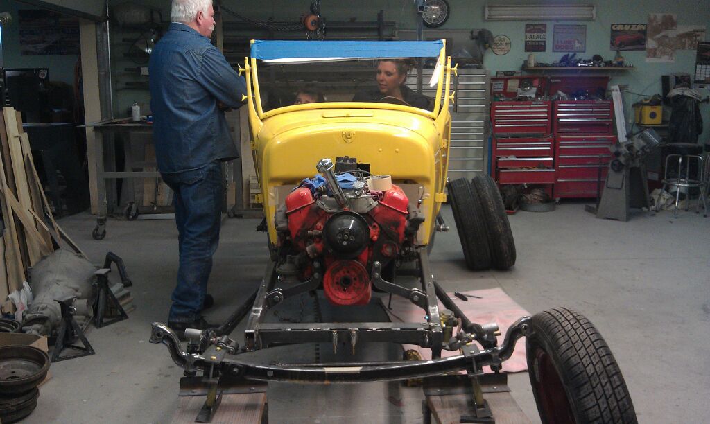

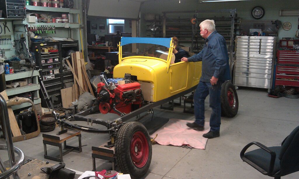

    Ran to Bob's this afternoon to check progress. I was greeted by headlights!
    The steering box mounting plate and gussets are made and tacked in. Mustang box is bolted in and steering shaft is placed. We set the steering wheel height today.
    Bob also heated and bent the steering arm to clear the frame rail.
    An overall view with some negative camber tribute from my mini truck days. :rolleyes:
    Yep, Bob the Builder is crankin' this hot rod out!

    I like it all except the steering box and column placement. (Steep angle and poorly placed wheel :) )
    The car is going to drive like the bus it is painted like :D ;)
    I think you should figure out a way to either relocate the box or incorporate a couple of U joints into the column to allow a more natural steering wheel position.
    In my T ,when I get there I will have the column at more of a horizontal angle from under the dash to give the more desireable steering wheel position.
    I'll use a couple U joints to connect to the box, or if needed one of the steer clear chain drive units to preserve footroom.

    I'm right with you Larry, and I HATE the "bus" steering wheel idea. I also hate the shade of yellow this car is too, but you already knew that! :)
    HOWEVER... moving to a typical angle meant using a Vega box, which I don't want. We tried a F100 box for this exact reason, but it just didn't fit neatly with where everything was mocked up. The Mustang box is the best fit, and much to my surprise sitting in the car the steering wheel position has a VERY natural feel to it. I've always detested the Fad T steering thing with a vertical column, but being 6' 1" I suddenly appreciate the additional leg room of not having a column between my feet!
    The other option (and really preferred) was cowl steering and that's out of the budget.
    I can see the personalized license plate now... SHRTBUS LOL!

    Thanks Tim-eh! I've had Vega boxes, but I LOVE the Maval cross-steer 1/2 rack that we put in my A Tudor! Rock solid, good feedback, and it felt great at 110 MPH in the several bursts I made! Trying to follow the vintage Ford parts thing as much as possible, but within reason here.
    Although a Mustang box isn't period correct for what I'm aiming at, a Vega would be a further departure yet.
    I really was surprised how good it felt. Bob is one hell of a planner and knows how to set up a car! Still, I wished the F100 box would have fit in the tight constraints as it would have been more "correct".
