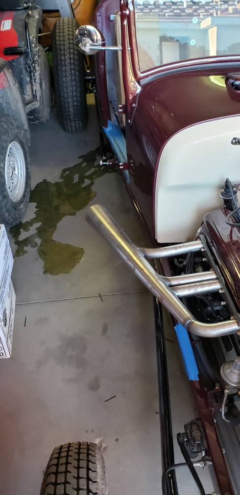

    Feeling a bit better this morning. Walked out to a large puddle of 80/90 on the garage floor... ugh. Guess the list is getting longer instead of shorter.

    It's the pinion seal. Can't get one today so I'll move on to other things.

    Glad you are feeling better but dang that's a bad leak, would need to be missing or the wrong one to leak that bad. Hope its an easy fix. Even if its the seal, I cant see how that much oil came out. JW

    Yeah, it HAS to be the wrong seal for sure.

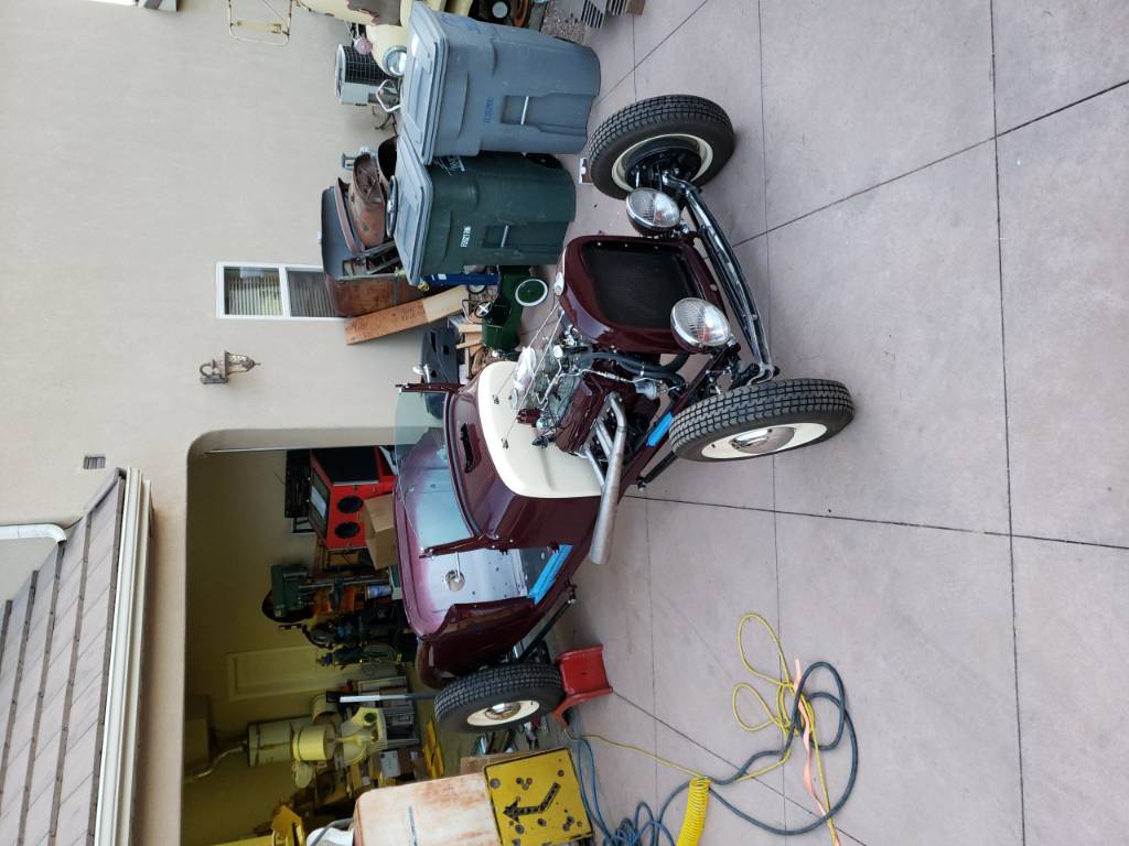

    Been in the driveway the majority of the day. I shot a quick video but the HAMB won't let me upload it.
    Mostly working today and troubleshooting things I did more than a year ago. Chasing wires, trying to remember where I left off and why I didn't finish certain items.
    Hooked everything up and hit my electrical disconnect, fire extinguisher in hand. No smoke, but no voltage. Whoops, fusible link not connected at the starter.
    Try again... still no smoke, still no voltage. Tracing wires I realized I never connected the link back into the fuse panel. I think I did it with the intent of connecting it last.
    Try #3, no smoke and now we have voltage. Ignition switch works, horn works, headlights work, blinkers work, stereo works. Wired up the electric fan override, now it works. Only thing not working is the rear taillights. I'll sort that out next. List is getting super short. Still have to figure out the pinion seal.
    Time to take a break and get ready to work again tomorrow. I've been working 14-16 hour days recently and it's been kicking my ****. Nice to get some time with the roadster and my family!
