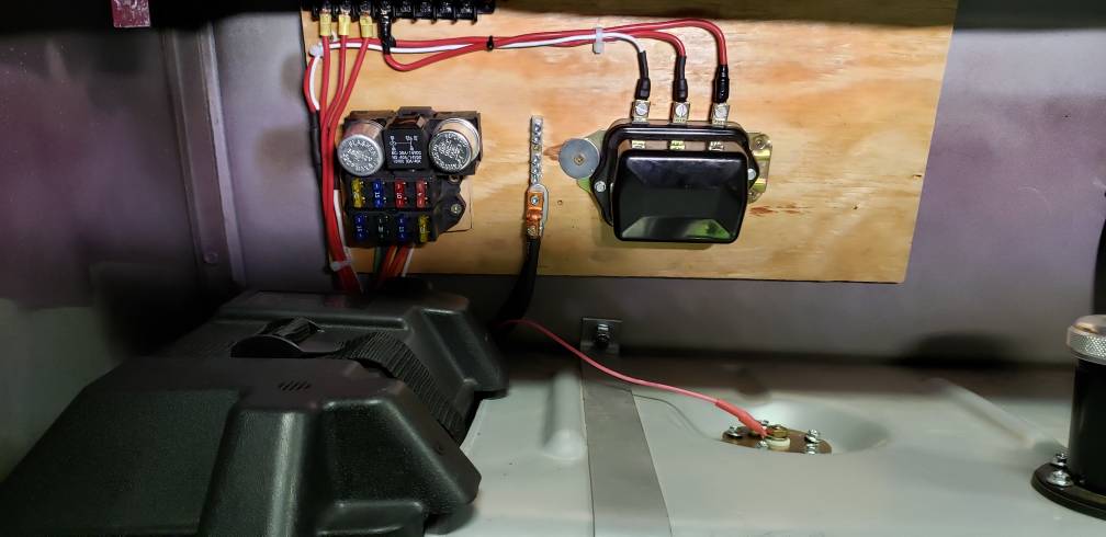

    You may have noticed the interior was cleaned of all tools and s****. My son Austin has been helping me throughout the day, and we finished cleaning up all wiring in the trunk too.
    Gentlemen, the car is completely wired and tested.

    Looks real nice and neat . You’ve done a great job . Blue
    loudbang and daddio211 like this.

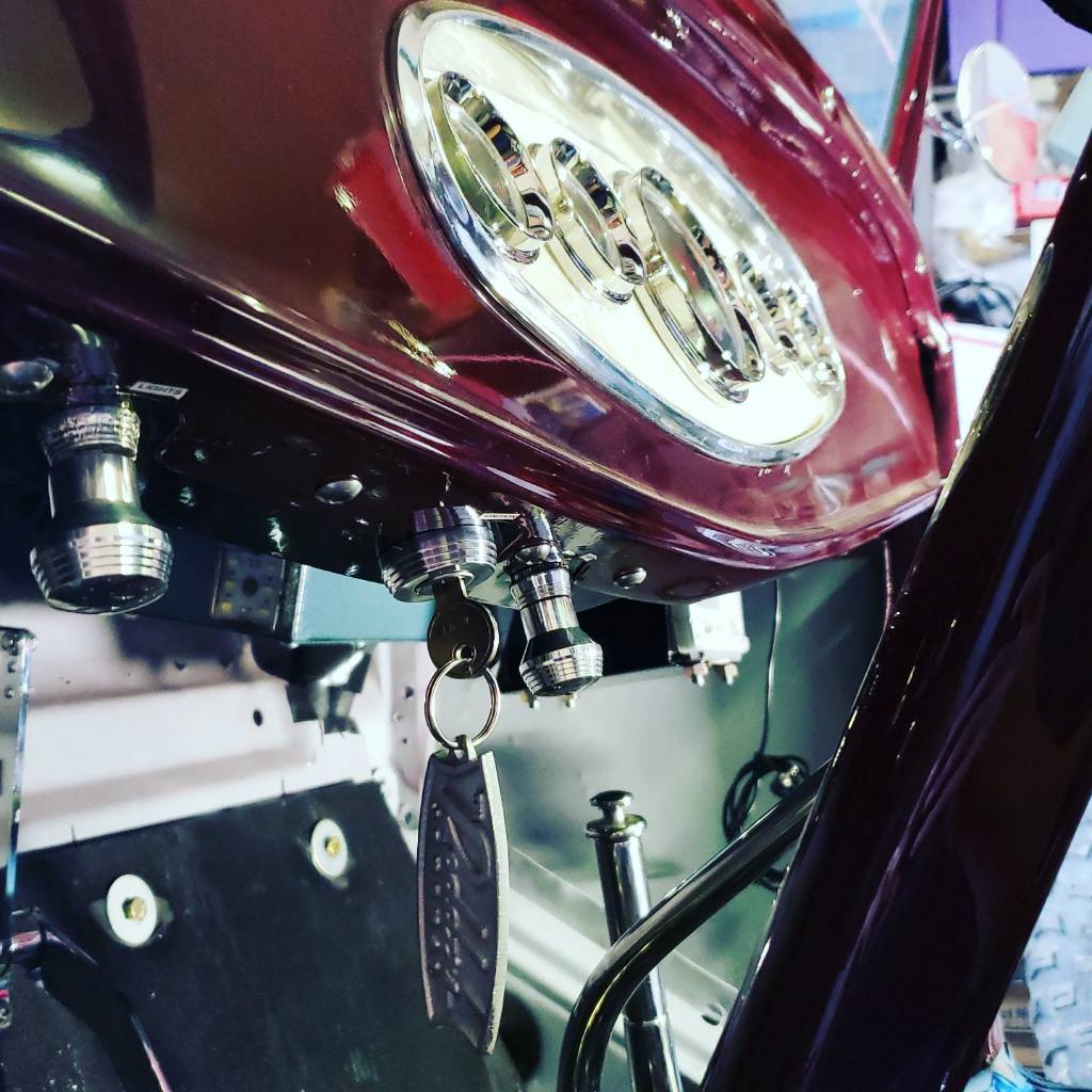

  18. KJSR
    Joined: Mar 7, 2008
    Posts: 2,497
    KJSR
    from Utah
    I'm digging the switches under the dash......guess I had never really noticed it before.

    Thanks E, I wanted the dash to stay free from anything but the dash panel. Figure less is more and I'm super happy with the way it turned out.
