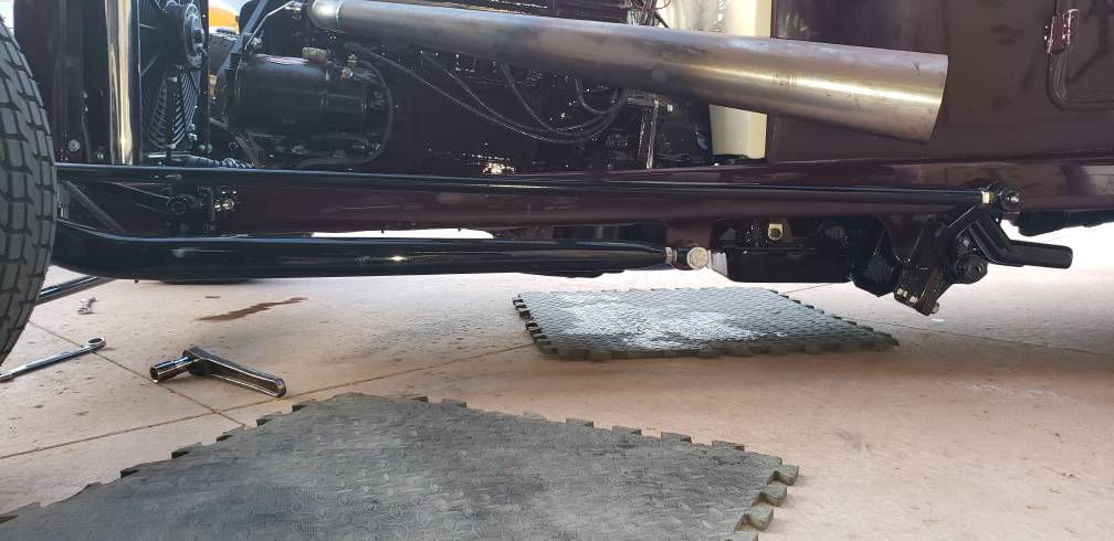

    Even though your front radius rod and drag link appear parallel they are not. Take a line from ch***is pivot of the L/H radius rod to the center of the king pin boss on the axle, that is its pivot line as its the center of the wheel that counts. they are far from being parallel and will travel in a much different arcs to each other when the axle moves up over a bump and with the drag link being longer its arc is flatter than the other arc. This can be worked out with string, chalk and a tape measure....or wedge a front tire against the curb (with a rag to not mark the tire) and bounce hard up and down on the front of the ch***is ( rags so to not mark the super paint) and see if the steering wheel moves back and forth. JW

    First, thanks for the phone call and input Jeremy! We'll get this sorted, won't we? Hey, next time you call (if after my work hours) press 5 for emergency service so it rings my cell phone! Also, I'll PM you my cell.
    Back at it this afternoon, confused as ever. Changing one thing at a time and taking notes.
    Changed tire pressure to 25 lbs, no change.
    Pulled panhard bar off, no change.
    Checked oil level in shocks, both low. Filled with 30W per specs found on the interwebs, no change.
    Double checked toe and caster. 8°-ish caster, 7/32" toe in. Yeah, didn't bother going for the extra 1/32" yet.
    Steering arm is tapered so rever mounting the steering linkage (at this point) is a huge project.
    I said last week I was going to buy a steering stabilizer but I didn't do it. After discussing the problem at length with Lenny at So Cal I wanted to try to fix the problem instead of masking it.
    Here's what I've noticed:
    1. The car seems to drive perfectly fine at any speed up to 50 (fastest I've gone).
    2. Steers well, tracks well, responds well to steering input.
    3. It SEEMS that when I hit a bump at any speed between 30 and 50 WITH THE FRONT LEFT TIRE ONLY that the issue begins.
    Going to swap left and right front tires in a minute and see what happens.
    Also, going to a local alignment shop Monday. Talking to the guy he made a suggestion that I think someone in here mentioned before - bounce on the front end and see if the steering wheel moves. If so, something is binding. Well it does and it's probably somewhat amplified by the removable steering wheel mount. Holding the wheel lightly stops the movement to the point where the steering wheel moves about as much as a tire out of balance.
    Bob stopped by today and we talked about a million things. We went through step by step and checked thing of the list.

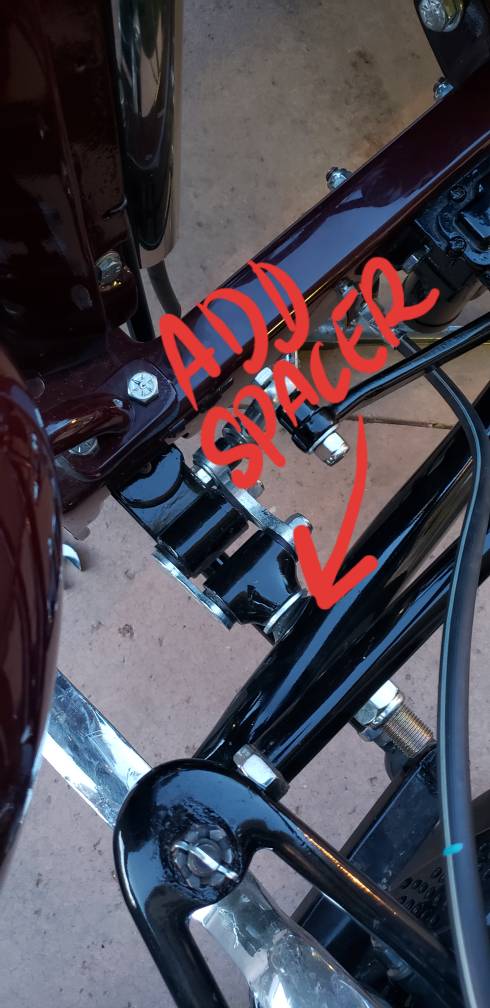

    I think the last thing we are looking at is making a spacer to drop into the mount between the spring perch and the split wishbone, effectively giving more of an angle to the spring shackles.

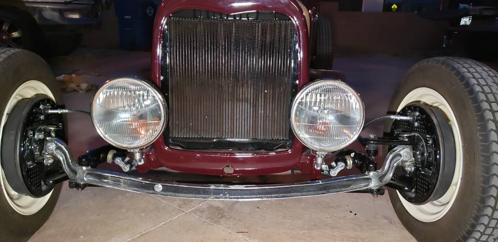

    Going to throw a few other pics in just for argument's sake. Thanks everyone for the help with this!

    I like the idea of the spacers to give more angle to the shackles Eric. It seems that the shackles are sitting stretched out fairly flat in the one picture.

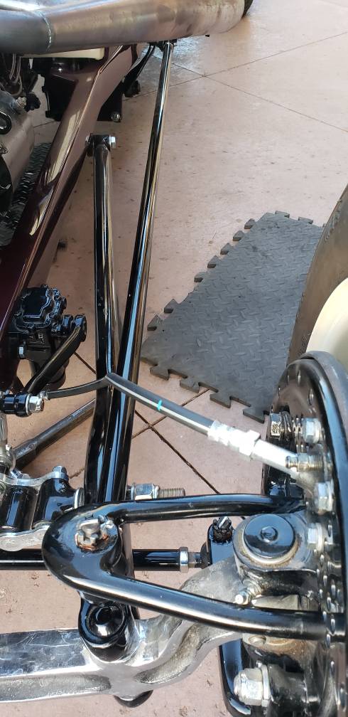

    Eric, you need to flip the steering arm so the rod end is on the top (hope the brake hose isn't an issue). this will get the arcs of travel closer to each other and WILL reduce the bump steer. You can do it without removing the rod end, just loosen the jam nuts and lengthen the drag link till it lines up again, i know it will make a difference. I didn't notice the spring mounts were adjustable, Bobs idea is good. WE WILL GET IT SORTED !!:D JW

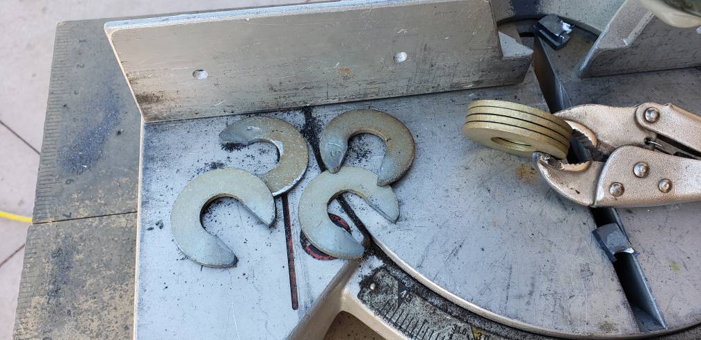

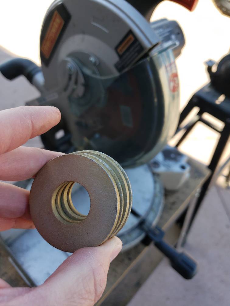

    Had a little time to work on the car again today. Jeremy, I still didn't get the measurements for you but will shortly. And after doing the math I totally see what you're talking about and I think you're correct. I'll relocate the steering arm this week.
    In the meantime I knew I had to get the proper angle on the shackles. I grabbed some washers for a quick test of theory.
    I notched them and took the burrs off.
    Loosened the spring perch and slid the spacers in.
    And achieved the angle needed.
    Haven't driven it yet to see if it's made a difference. Still have tools all over the driveway. Will report back shortly.

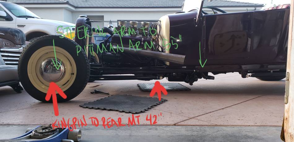

    Okay, lengths attached in photo.
    At center/neutral steering position steering tie rod end is directly over the spring perch NOT KING PIN as I wrote in the photo.
    Tie rod end at Pitman arm is directly wetical to pivot at center/neutral steering.

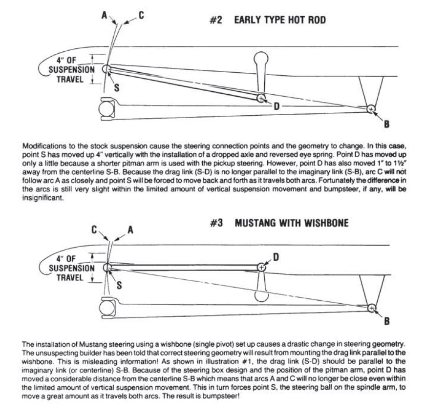

  20. Blues4U
    Joined: Oct 1, 2015
    Posts: 8,068
    Blues4U
    from So Cal
    The upper example shows the idea. To keep the arc's as close as possible, and reduce bump steer, both the drag link and the radius arm need to have intersecting planes. The bottom illustration shows drag link and radius arm parallel, the arc's of travel are very different, which WILL result in bump steer.
    Stogy, loudbang and brEad like this.
  21. Blue One
    Joined: Feb 6, 2010
    Posts: 11,512
    Blue One
    from Alberta
    You cheated, you didn't draw those pictures. :D
    But yes you're right, I've seen those illustrations before.
    I tried to get mine as close as I could to the top one, I guess I'll see how it works once I get out for a drive.
    Stogy and Blues4U like this.

  23. 26 T Ford RPU
    Joined: Jun 9, 2012
    Posts: 12,594
    26 T Ford RPU
    The top illustration is what i am working on with Eric, except his Pitman arm goes up. If we cant get the front of the steering arm up enough to get the arcs travelling together the radius rod pivots will need to come up with correction to the castor angle....... WE WILL FIX IT. Here's my setup, no bump steer and NZ has the roughest roads!! JW

    One aspect that both those diagrams fail to show is the spindle center, this is where the axle arc is taken from......NOT the bones to axle point. JW
    Stogy and loudbang like this.

    I had the chance to visit Eric and check the roadsters steering. I flipped the steering arm on the spindle so the rod end is on the top so it runs upward to the front. Its better but we still got the wobble on ''once'' ! A new steering arm with a 1 1/2- 2'' kick up may be required yet. On close inspection i found that the perch bolts are loose in the axle and believe this is a good part of the issue....... WE WILL FIX IT, Buddy !!
    Of note on all spring over axle perch bolts is they are not long enough for use on radius rods after 1934 due to the extra material required on the canter lever spring mount. They should have full to near full purchase in the axle...... you will only get 2/3 or so. The fix i made on my T was to turn down two 5/8 unf nuts to the perch/axle size and lock them on tight. The perch bolts has a lot of load when braking and even more so with a dropped axles and even with over coming the effect of steering caster. JW
