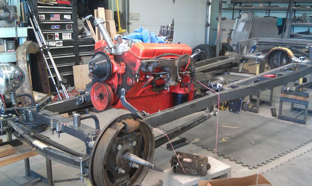

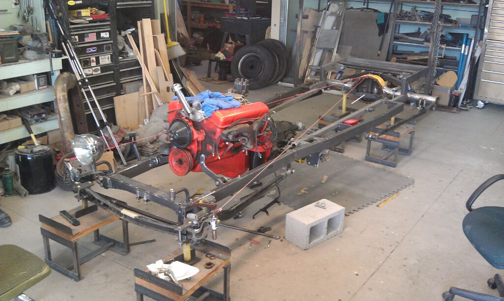

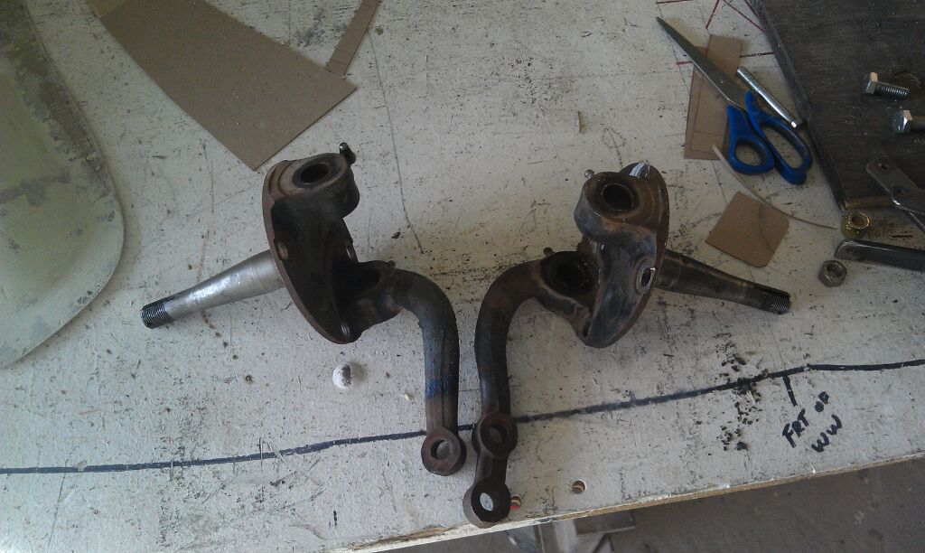

    I made another run up the hill to Bob's this afternoon. Over the past few days we have discussed an issue with the steering arm of the spindle not clearing the drop portion of the axle. Bob had heated and bent the steering arms a few times and the turning radius was dismal at best.
    I had the spindles that were last used on this axle, as everything was under my A Tudor when I bought it. I took them up and we threw them on. Pathetic. About 20* of turning radius, and that's being generous.
    Bob already had a backup plan: fabricate a bracket and steering arm that positions the linkage lower where we need it. Somehow I didn't get a picture.
    Obviously the body is off, but not before he built a transmission tunnel out of fibergl***.
    You can also see the strings from the kingpins to the center of the rear end. Bob was getting ready to set Ackerman, but we had pulled off the spindles. It will be redone when the new steering arms are fabbed.
    Still have a few issues to sort out, but everything is coming together nicely!

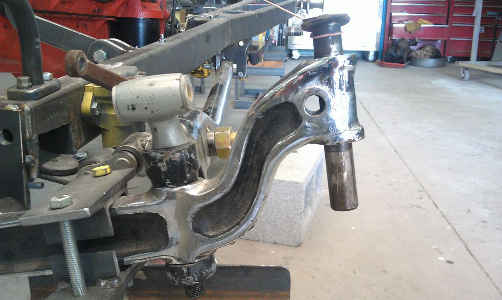

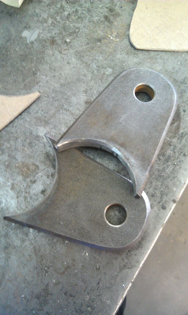

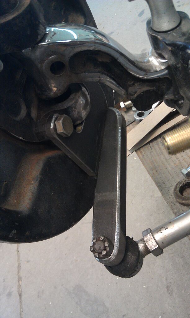

    I didn't know I was going to end up at Bob's this evening, but I did. My twin daughters wanted to spend the night at a friend's house about 25 miles north, so I threw a few parts in the truck and stopped at Bob's on my way home. Great excuse, huh?
    I didn't take any pics, but the generator is going to be mounted down low on the driver's side. Bob will fabricate a mount off of the existing engine mount and tie the adjuster into the water pump. I didn't want an alternator, and I wanted it down low and away from the carbs. This solves that problem nicely.
    The steering arm dilemna we faced last week is history too. Bob built spacers for clearance, then a piece of 3/8" plate connects to a piece of flat stock. Of course everything is just tacked right now but you can see that clearance around the axle is no longer an issue.
    The tie rod also tucks perfectly under the front spring, nice and tidy!
    Driver's side:
    P***enger's side:
    Bob also made the brackets for the other two links of the 4 link. Note they're tapered to fit the rear axle at an angle. There will be a light triangulation to the four link, but I'll still run a panhard bar. The biggest reason for running a four link is that I'm hard on stuff. I don't beat my cars at all, but I do drive them hard and I don't trust the rear bones to survive my (or the wife's) right foot! :D

    Correction made, stering arm was not 1/4" plate, it was 3/8".

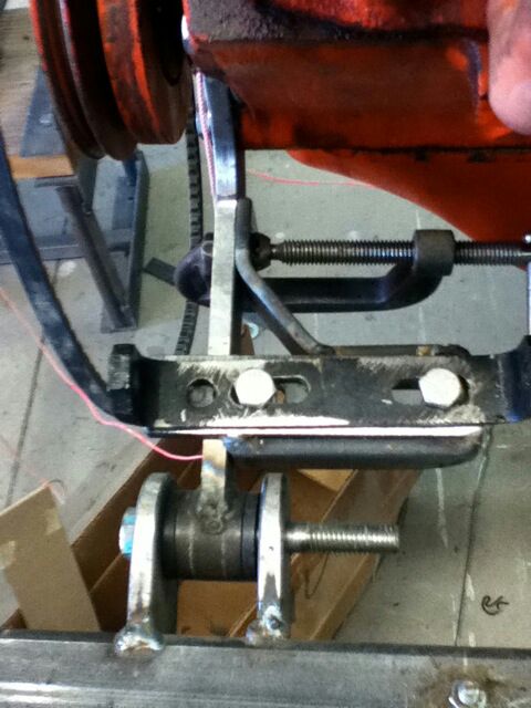

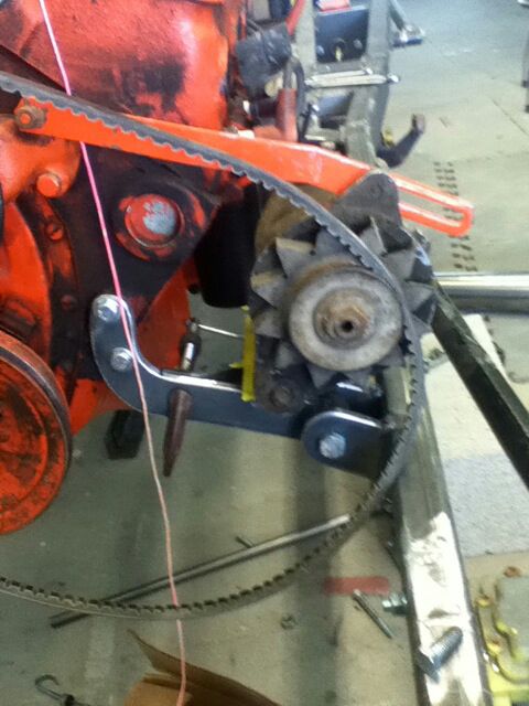

    Bob emailed a few pics to me today. He put together a cool little mount for the generator. It's just clamped together for now, but its perfect.
    Sent from my DROID device using the TJJ mobile app

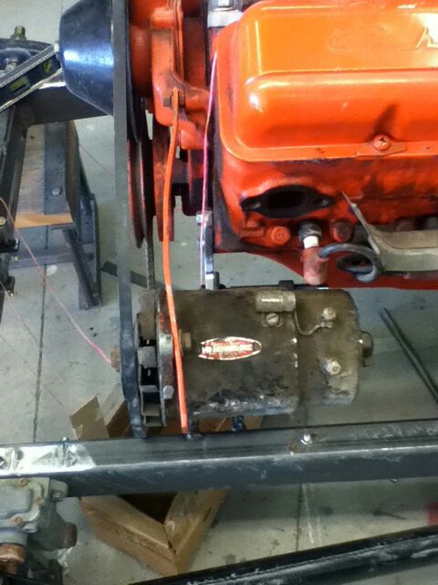

    More pics today from Bob the Builder. This shows the lower portion of the generator bracket that will be welded to the engine mount.
    This guy builds cool ****! Just give him an idea and let him run with it!
