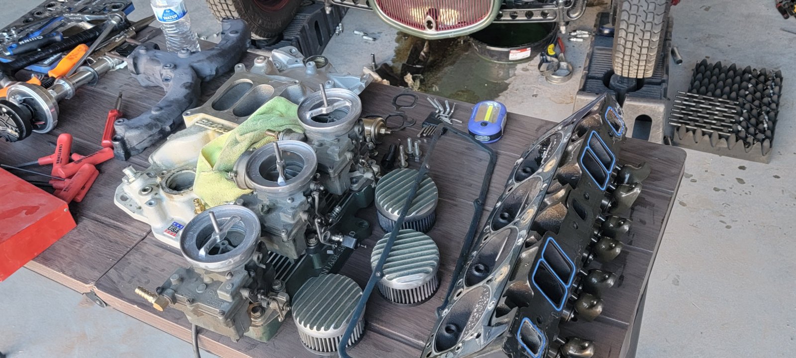

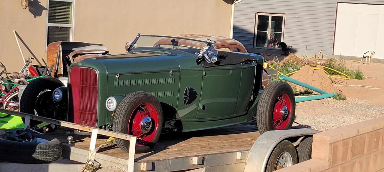

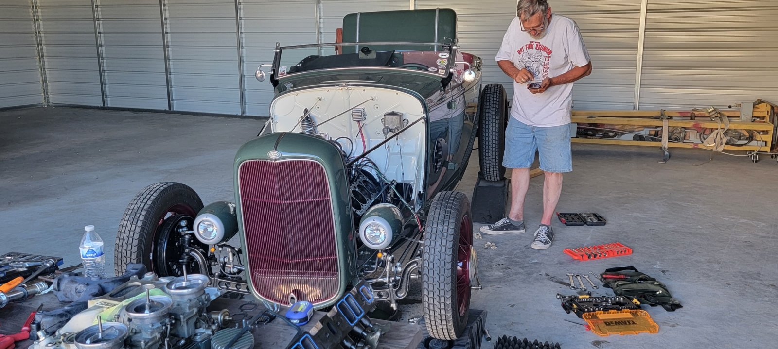

    Victoria's roadster got some fresh air and sunshine last week. Your pal and mine, Dale Grau, was on his way home to Minnesota from LARS and developed a bad noise in his engine. He shut it down about 40 miles south of me and put out an SOS on Facebook. I got half a dozen messages from mutual friends.
    I ran down with my trailer and brought him to my house. First car in my shop, LOL. We tore it down and got him back on the road several days later. Thought I'd share a few photos with y'all.
    We believe a set screw from one of the air cleaners found it's way down the intake and into cylinders 1 and 7, you can see it embedded in piston 1. We replaced pistons 1 & 7 and had a friend surface the head. He also did some valve work as they weren't seating properly.
    Dale made it home with no futher issues.
