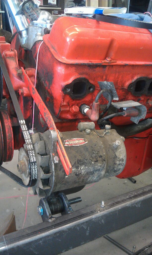

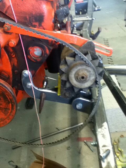

    I don't understand how that bracket functions. It looks like the adjustablity is north-south instead of east-west.

    Howdy Brent! You can clearly see the forward/rearward movement, but if you look closely there are tabs at the top of the mount where a bolt slides through the generator, giving it the left/right movement allowing the belt to be tightened. The left/right adjustability will come via a slightly modified original arm connected to the water pump.

    Looking at it from the other perspective, I completely get it now.

    I figured the combination of the two pics would nail it for you.

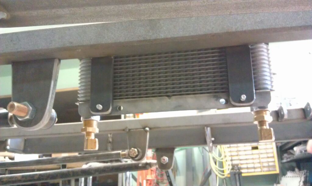

    Finally made it up to Bob's yesterday. From photos it doesn't look like much has been done, but lots of little details are coming together.
    Front brake lines routing/plumbing figured out.
    Shocks have been moved back 1", mock up parts in place for connecting to the axle.
    Trans cooler mounted.
