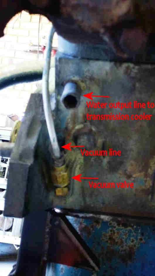

    With respect to the outlets on the rear block near to the starter motor, I have discovered that the small line as previously mentioned is a vacuum line for wipers plus I have a larger connect point that looks like the size of a heater hose hook on point.
    I am reliably told that this was a delivery point for water to cool/heat the transmission of the era.
    I intend to block both these connect points off and I am currently considering my option on how best to do this to achieve a nice clean and permanent result.
