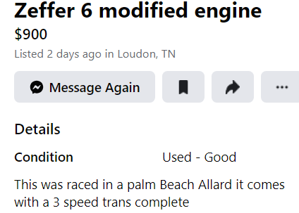

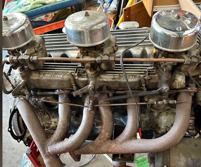

    This engine is for sale just down the road from me and it's described as a "Zeffer 6 modified" that was raced in an Allard. I've tried to identify it using the Edelbrock F 361 intake, but I can't find any info on the manifold. Anyone have an idea as to what it is? The Ford Six Performance forum is no help.

    looks like a 200 (or one of the other sizes of the same basic design).
    More pictures, including numbers on head and block, will help identify it further.

    Looks a lot like my 240/300 Ford
  8. squirrel
    Joined: Sep 23, 2004
    Posts: 60,039
    squirrel
    should look a lot more like a 144/170/200 and sort of 250 Ford?
    note the shape of the valve cover, the exhaust manifold mounting surface angle, the small rear of the block, etc.
  9. alanp561
    Joined: Oct 1, 2017
    Posts: 5,604
    alanp561
    Looking at all that, especially that small rear and high mount starter location, and I'd almost have to agree except the 170 and 200s intake manifolds are cast into the head. After searching further, I find that the Australian Ford sixes had a removable intake. Maybe that's what I'm looking at here. How about some of you guys from Oz chime in?
  10. squirrel
    Posts: 60,039
    squirrel
    Did you look at the picture that I posted above? and read the article? I can scan the rest of it.
    you had to drill holes into the integral manifold part of the head, and then clamp the aluminum part to the head, to use this aftermarket 3 carb intake on the 144/170/200.
    I guess if you haven't been around this stuff for decades it's pretty confusing

    It does make it pretty obvious that the engine in the first post is not really a Zephyr engine

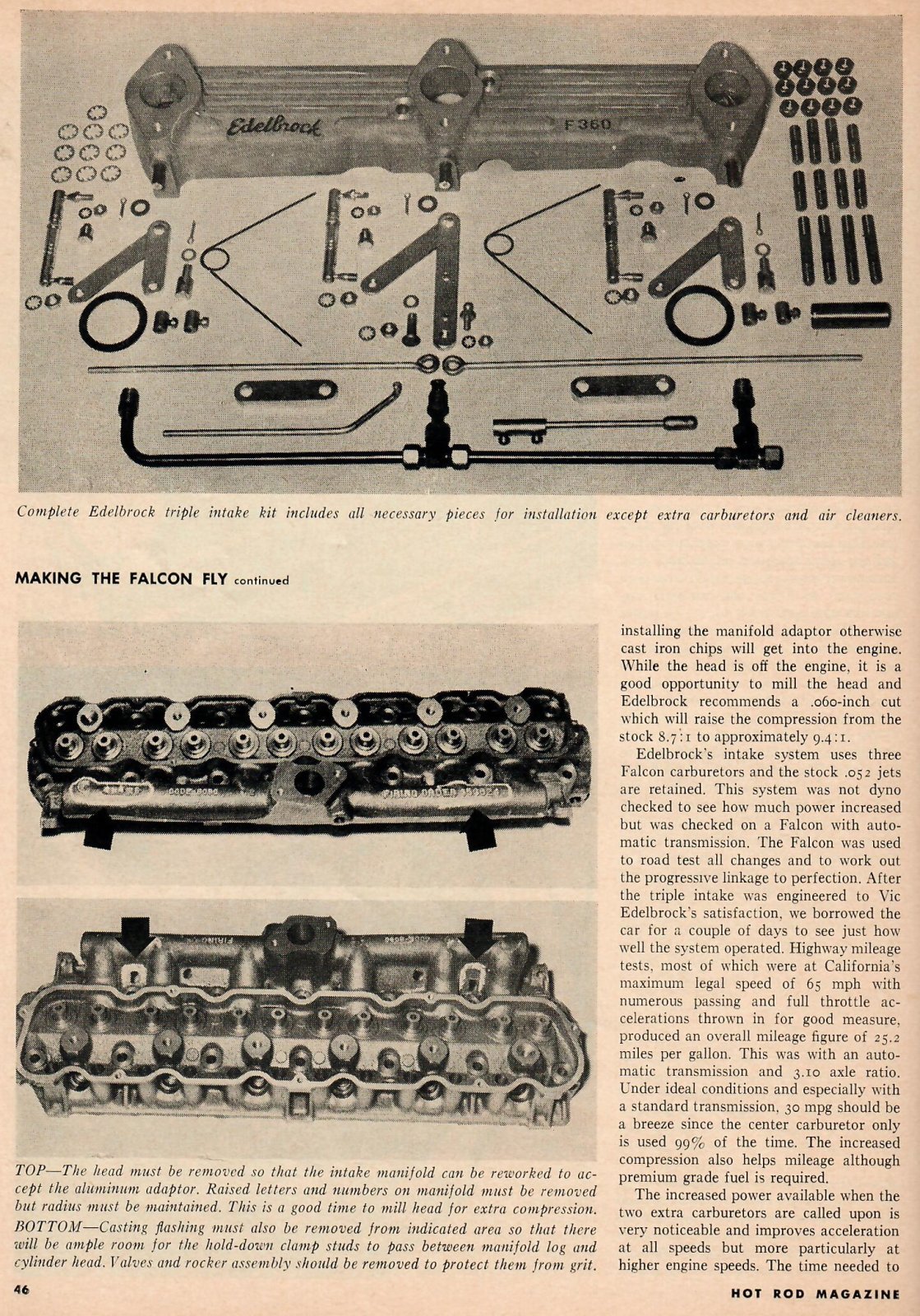

    here's the whole story...more details about how the intakes work. This is from early 1960, these engines were still brand new!

    Thanks, Jim. I see that Edelbrock designated the manifold as an F 360. If I want to know any more about an F 361, I guess I'm just going to have to make the trip. The fact that the guy who posted the ad referred to the engine as a "Zeffer" or Zephyr, could very well mean that it is an Australian unit.
  20. squirrel
    Posts: 60,039
    squirrel
    could more likely mean that he really doesn't know anything about it?

    I find it amazing that Edelbrock had their three carb intake out in March 1960, for a model year 1960 car, which came out no doubt in late 1959.
    Does anyone nowadays get stuff engineered, cast and machined that fast?
  22. squirrel
    Posts: 60,039
    squirrel
    sure, they have computers and cnc now.
  23. squirrel
    Posts: 60,039
    squirrel
    The 60 in the part number, for a part that fits a 1960 144 engine, makes me think they redesigned it a bit in 61 when the larger 170 engine was available, and changed the part number. But that's just a wild guess.

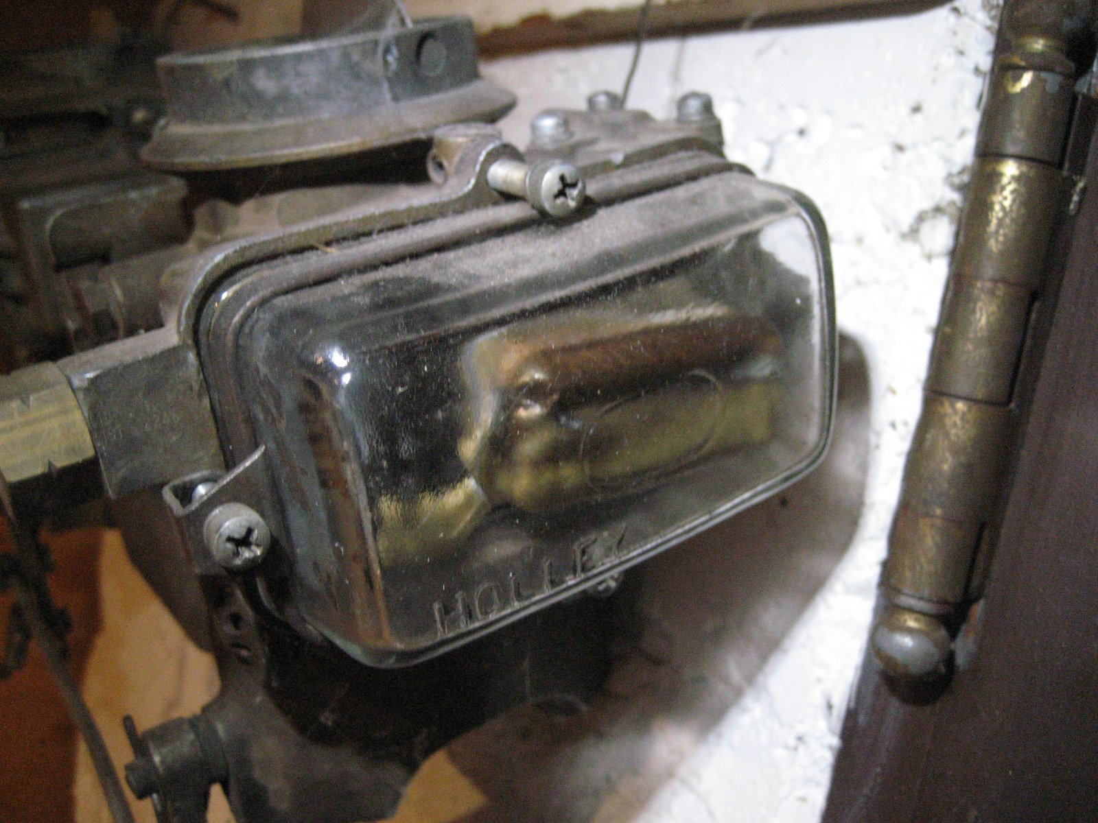

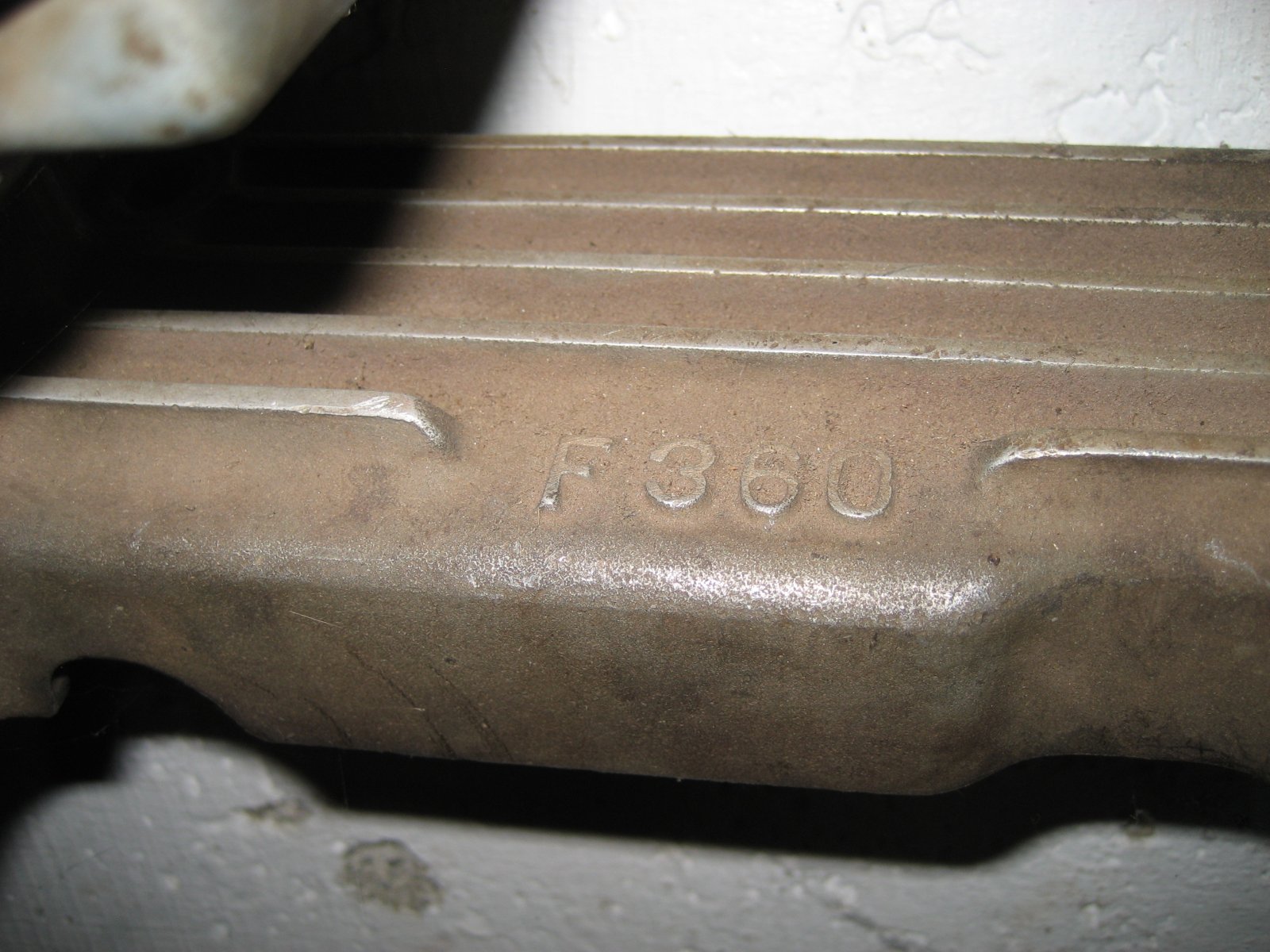

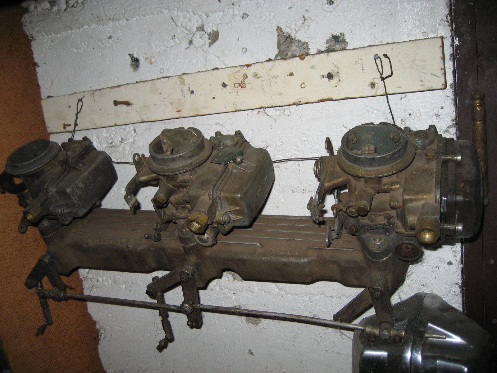

    Here's mine, but it's an F360.
    If you need any measurements, let me know.
