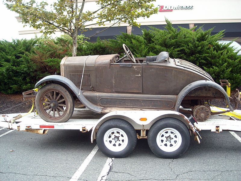

    This is a buick near me. Not sure what year, but i would speculate mid to late 20s

    1925 Star? 102 inch wheelbase look close at front brakes and at whats visible of rear frame especially the shackles. dscn1470.jpg dscn1470.jpg
  24. badshifter
    Joined: Apr 28, 2006
    Posts: 3,633
    badshifter
    It's a 1925 Durant/Star the front hubs have been replaced/updated as the originals had wood spoked wheels

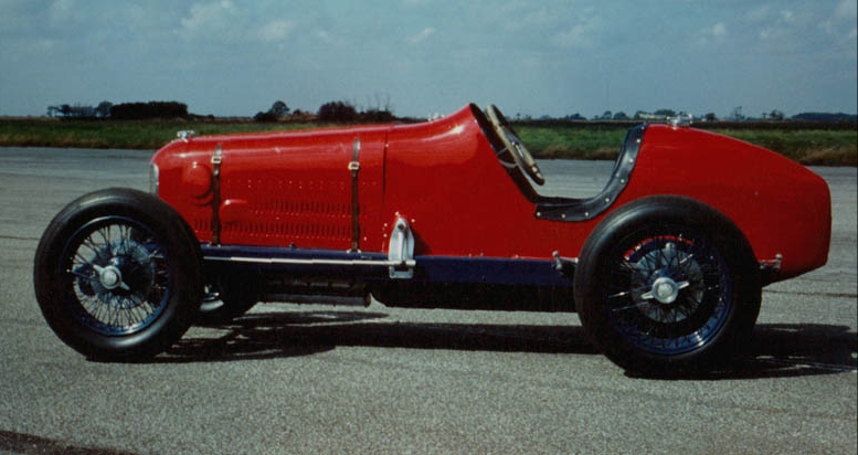

    I'd suggest the poster's rails be used to build an early "big car" racer. Narrow the frame, modify the rears to have kick ups, and get an old Chevy front axle with 18" wire wheels, mount the front springs outside of the frame, get a small Toyota or Nissan truck rear (same PCD as the Chevy, but will need spacers to eliminate wheel-to-drum clearance).
