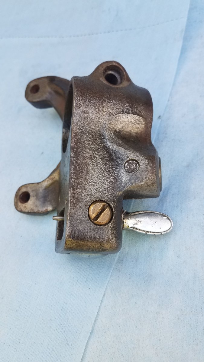

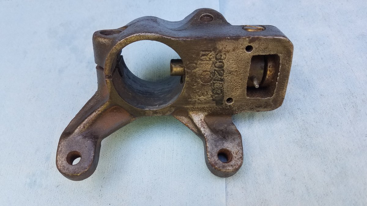

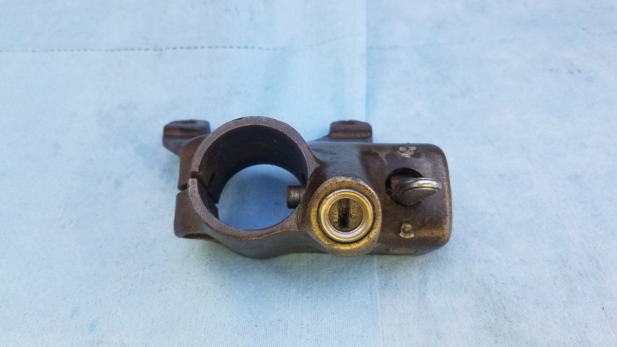

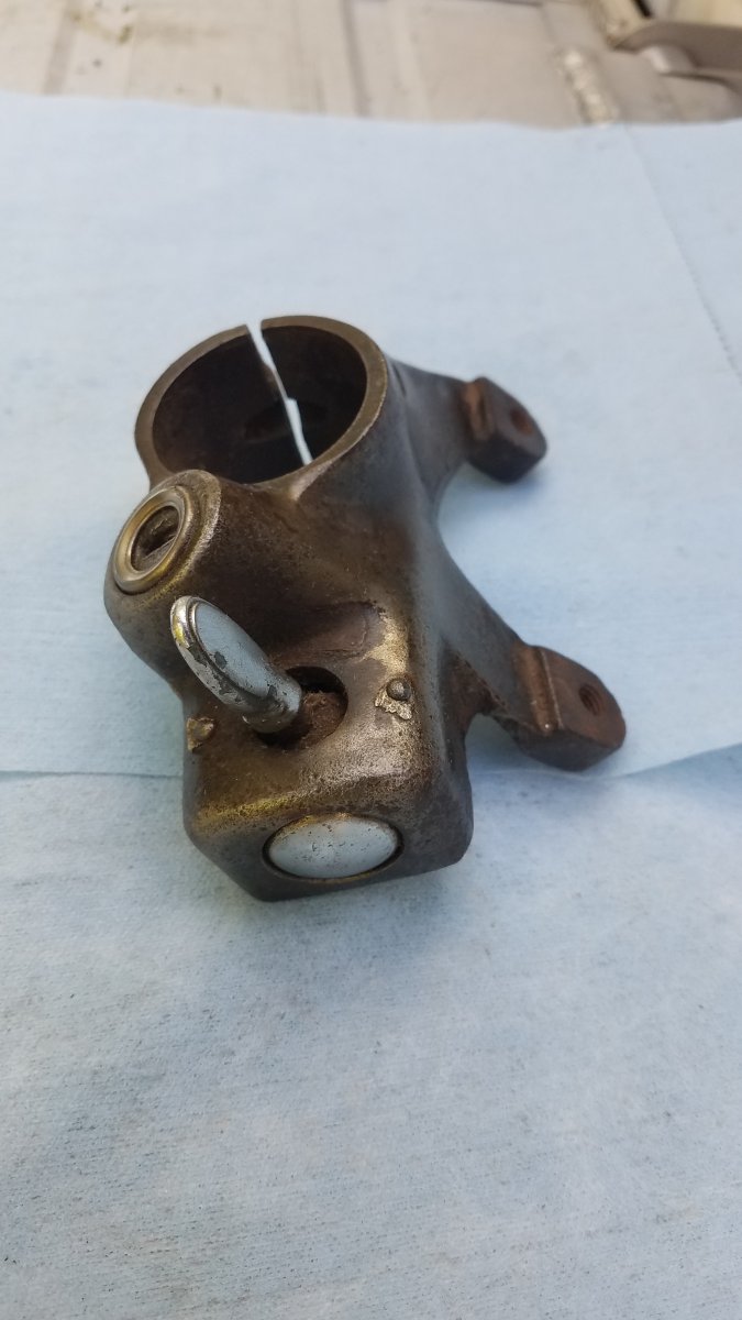

    Hello,
    I was wondering if anyone recognizes this part. I don't have the key for it and the Chrome switch looks like it had some kind of tag or plate that used to be there. It's really heavy made. Any info would be greatly appreciated. Thanks

    1940 Ford

    LOCK ***EM from a steering colomn (dont know year)...more than likely from a FORD

    This one is pretty close to being put back in business. The on-off plate is available in fair repro. The lock is held in place by the approximately 1/4" pin visible in this pic...drill it for a small machine screw and get it out. The key number is on the cylinder, so take it to the oldest locksmith you can find and you have a valuable part to build a car around...

    Use a socket head screw for the pinch bolt.
