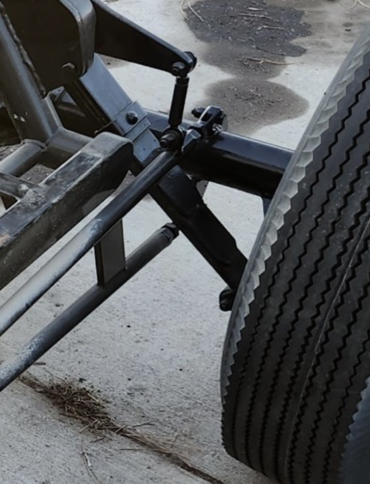

  6. I'd say the seller got lucky. It came out of someone's mind and a pile of material I'm afraid. The rest is up to you. What's up with that front spring? You know it won't work like that, right?

    Take a bar and flip those front shackles. Hope they clear the axle, they look pretty long.

    Yes, I also noticed the problems with the front end. Fixing it is on the list.

    I think that’s gonna make a neat hot rod. If it were me I’d try to get that tie rod behind the axle. The nice thing about hairpins is you can heat your steering arms to allow the tie rod to p*** through them instead of having to get above or below a wide wishbone. But I know guys do run them out front too. Good luck, start a build thread.

    Moving the tie rod is also the plan. Seems people don't understand you can't just flip the steering arms, it messes with the Ackerman angle.

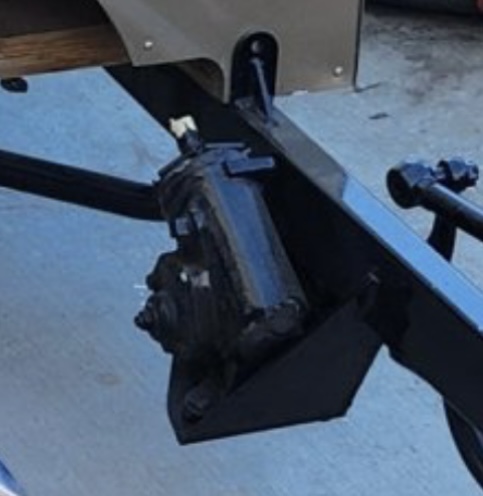

    That steering box has been reversed, that serves a purpose and is not a bad thing. Can you provide more photos, or can you tell if that is an OEM box or an aftermarket knockoff? For me it’s OEM or Borgeson, nothing else compares.

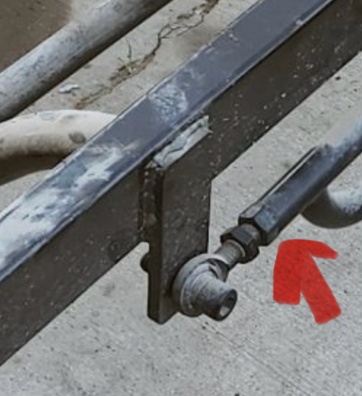

    The tubing used looks like it could be 7/8 OD x .156 wall and could have been tapped for 11/16-18 Ford tie rod ends. The arrow shows what I think are 5/8-18 nuts welded to the tubing.
    I don’t recall seeing a spring p*** through the radius rod like this before, IDK, maybe that’s not necessarily a bad thing. Does anyone see a potential problem with this that I’m overlooking?

  20. [​IMG]
    That's nothing more than a stock 60-66 C-10 truck steering box.
  21. squirrel
    Joined: Sep 23, 2004
    Posts: 60,033
    squirrel
    turned on it's side
    chryslerfan55 and Pist-n-Broke like this.

    Fair enough, and as I said nothing compares to an OEM or Borgeson box.

    Thanks for noticing things. I was excited about my new project and didn't notice everything. The radius rods are definitely going to get a close look. Everything is coming apart anyway, so I'll inspect them.

    I know Mustang boxes are often used in applications like this, but I don't know what one looks like. I ***umed this was one. I do know the '66 C10 I harvested a steering column out of, I needed to cut the shaft off the box, it was integrated. This box has a splined input shaft. Does a '67-'72 box look like a '66, but with a splined shaft?
  25. squirrel
    Posts: 60,033
    squirrel
    Chevy pickups had the column integral with the box through 1959, then they went to separate column and box. Are you sure of the year?

    I am sure of the year, I must be misremembering which car I cut the shaft out of.

  28. squirrel
    Posts: 60,033
    squirrel
    60-67. The truck frame was redesigned in 68, when they first started using the integral power steering gear.
