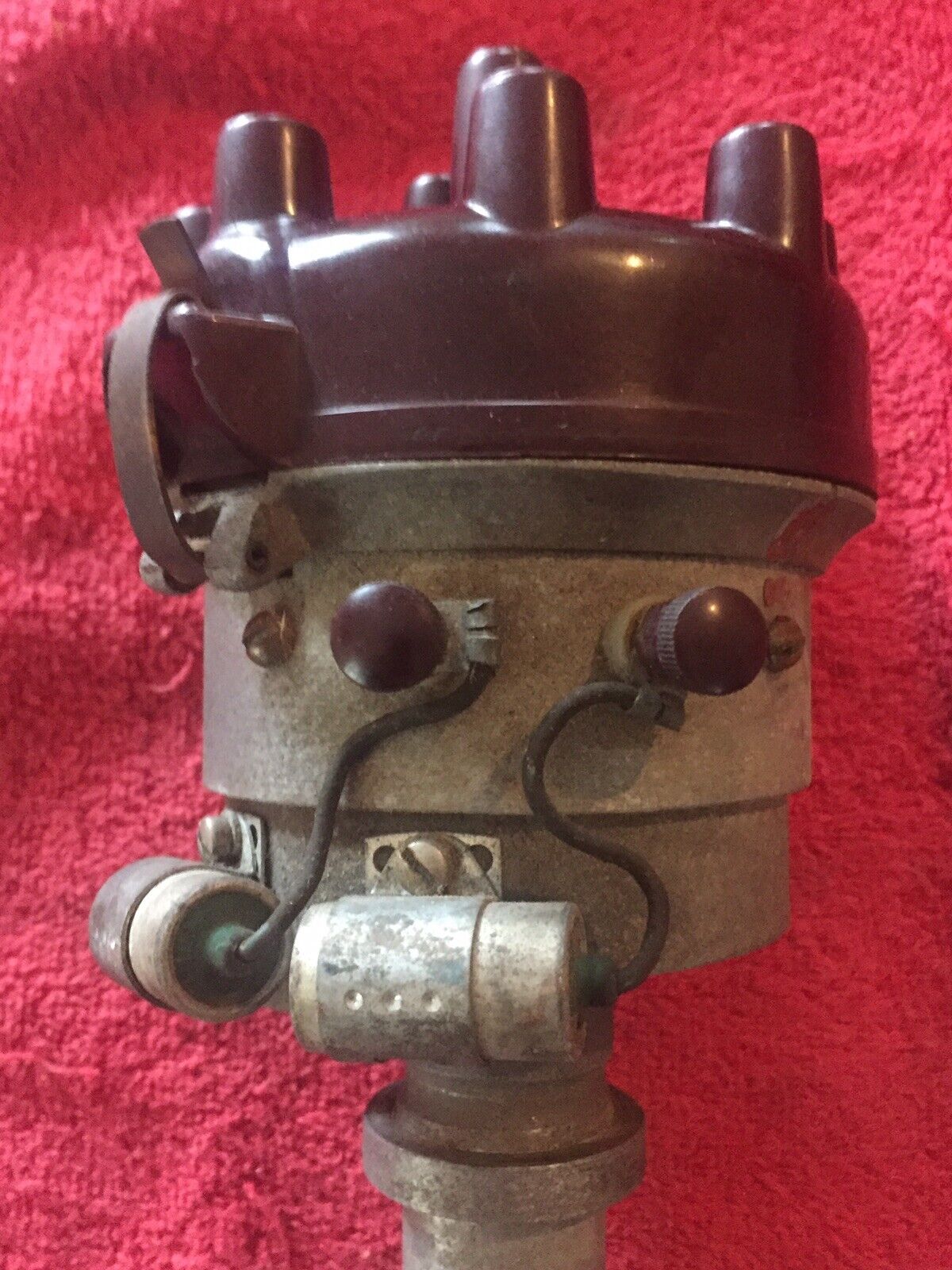

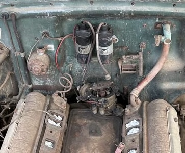

    I posted a 49 olds to the interesting cars for sale thread that looked like it hade done some racing in its time and I can’t get this thing out of my head or wrap my mind around how it would work. It has vacuum advance which I believe would rule out a Mallory unit. It uses 2 coils and appears 2 have 2 pickup units on the rotor.

    Could be a DuCoil brand distributor. Just a WAG!

    It's hard to see any detail in the picture that was posted, but it is a dual coil setup of some kind. It has two coils (obviously) and two condensers. It acts like two separate 4 cylinder distributors in one housing, with each set of points energizing the separate coils alternately. "Dave G" may be right that it is a "W&H DuCoil", but it's hard to tell from the picture, and I believe there were other brands offered. These types of distributors needed special caps with two coil towers and matching dual path rotors. They are special pieces and very hard to find these days (I think the Harmon-Collins pieces may be currently reproduced). This is not a Mallory because they did their "dual coils" differently (One coil with two primary windings, but only one secondary winding) allowing the use of regular caps and rotors. Some Mallory's were available with vacuum advance.

    main thing to ck is 4 vs 8 lobe cam..if you don't have the cap to ck for two coil inlets

    Yup certainly is a W&H ducoil. You can tell by the double ended rotor

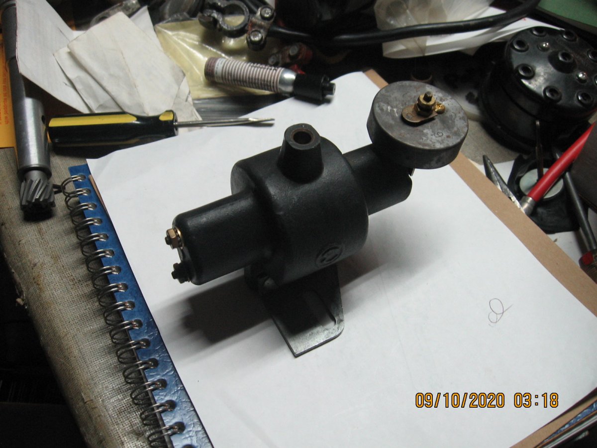

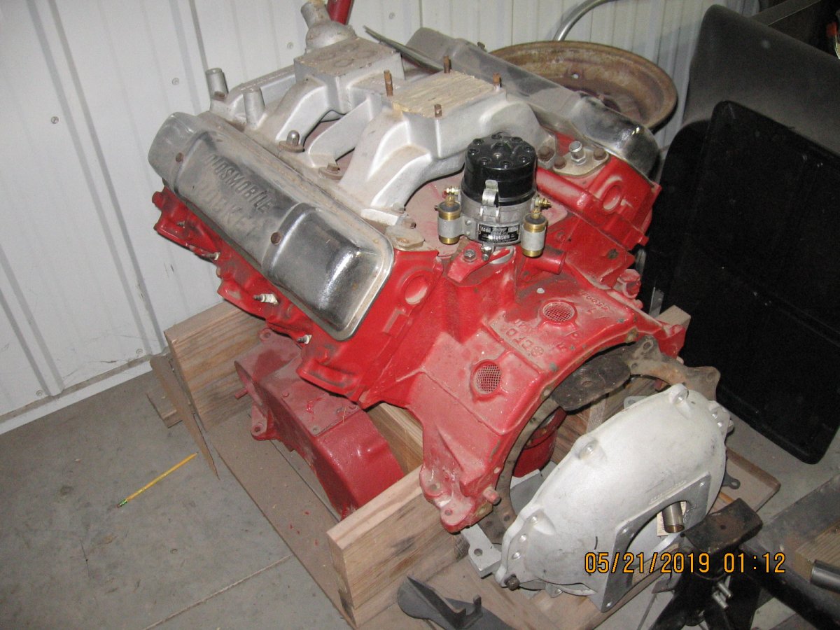

    Just so you know, here's a picture of a Mallory "Double Life" distributor for a Rocket Olds. Also pictured is one of their special coils with two primary windings and one secondary. Notice the 3 primary connections, one for each set of points and one for power. An interesting thing about Mallory coils; back in the day 6 volt coils were black while 12 volt coils were red.
    Imagine trying to start a big high compression Olds on 6 volts.

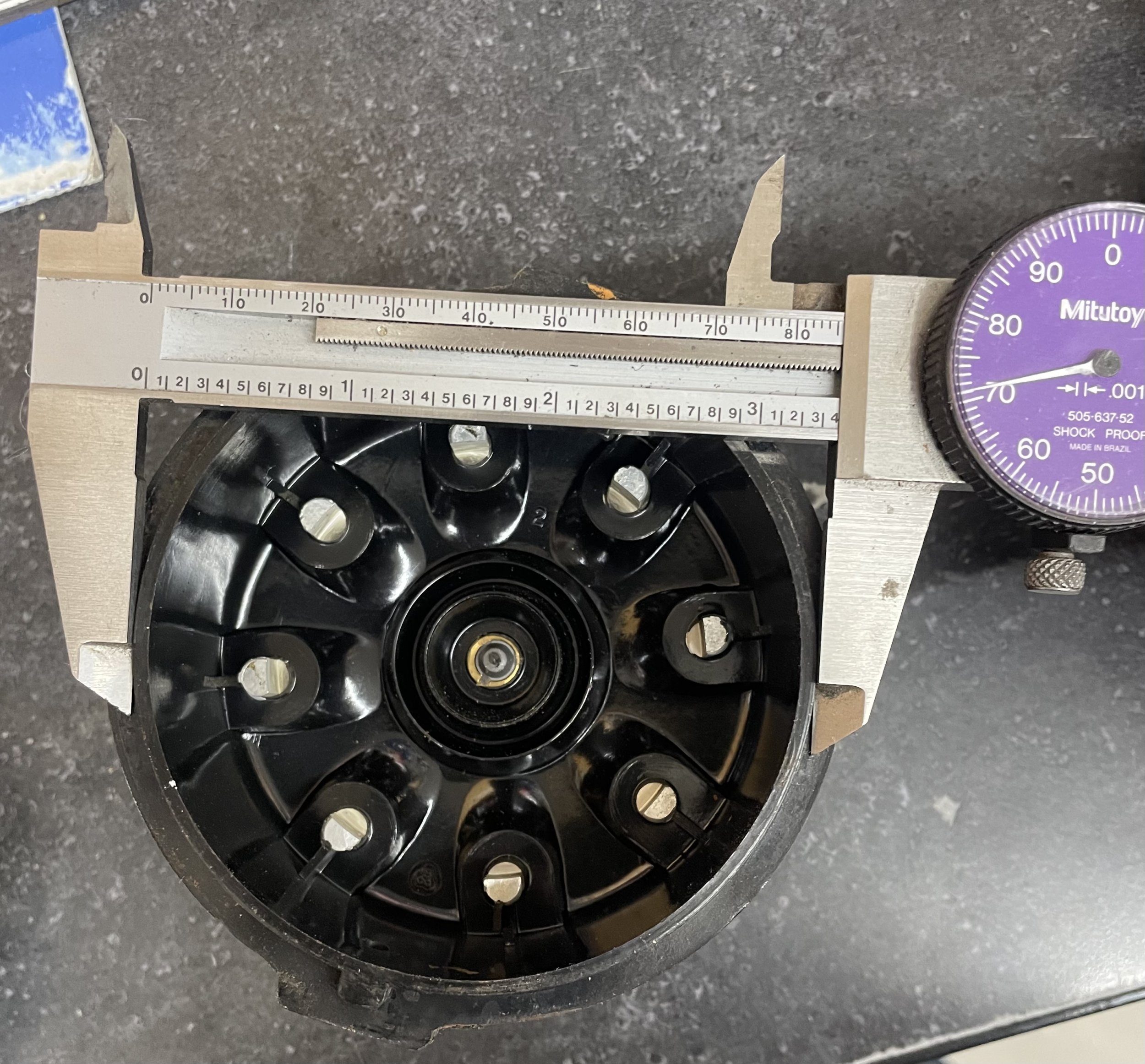

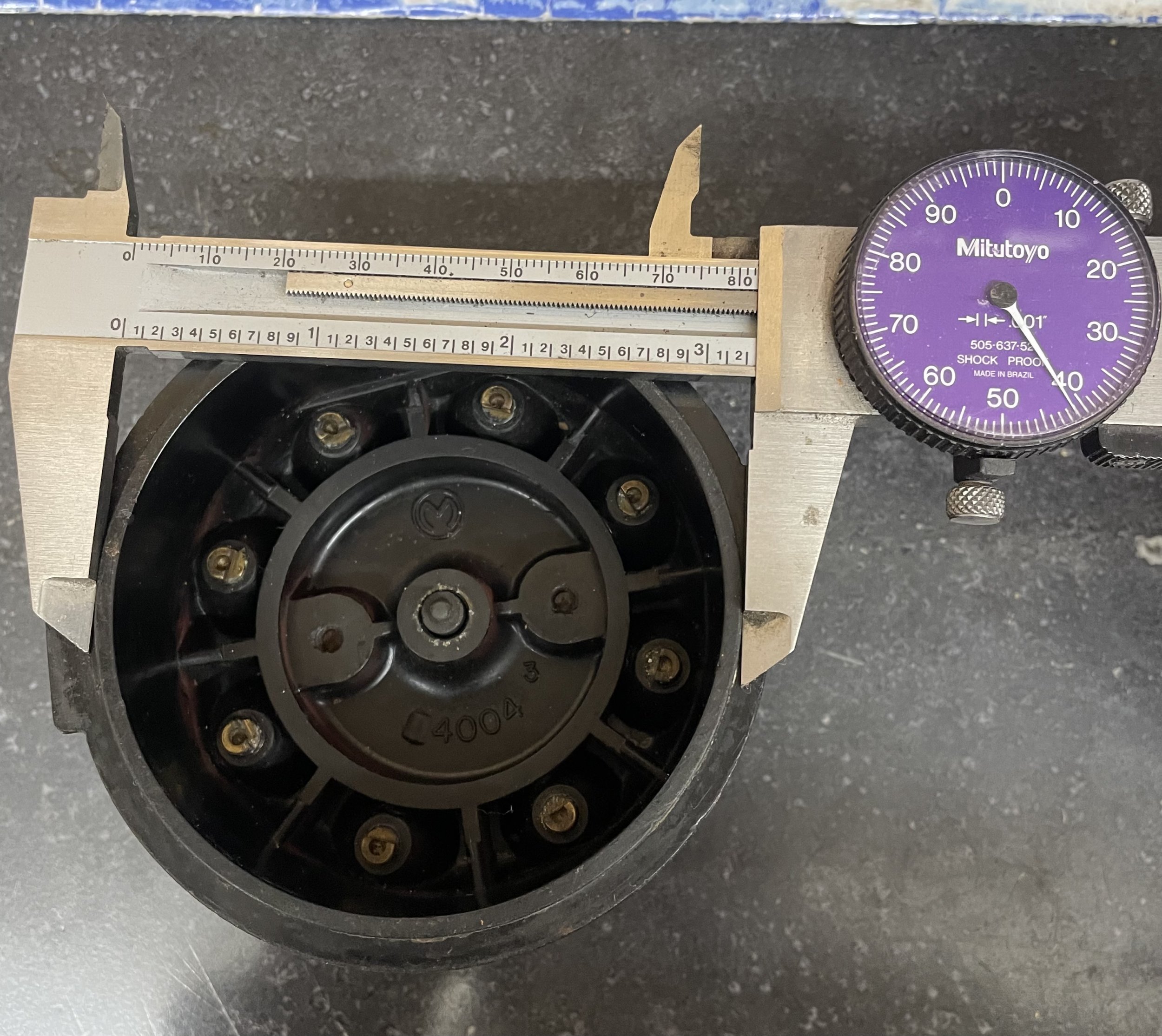

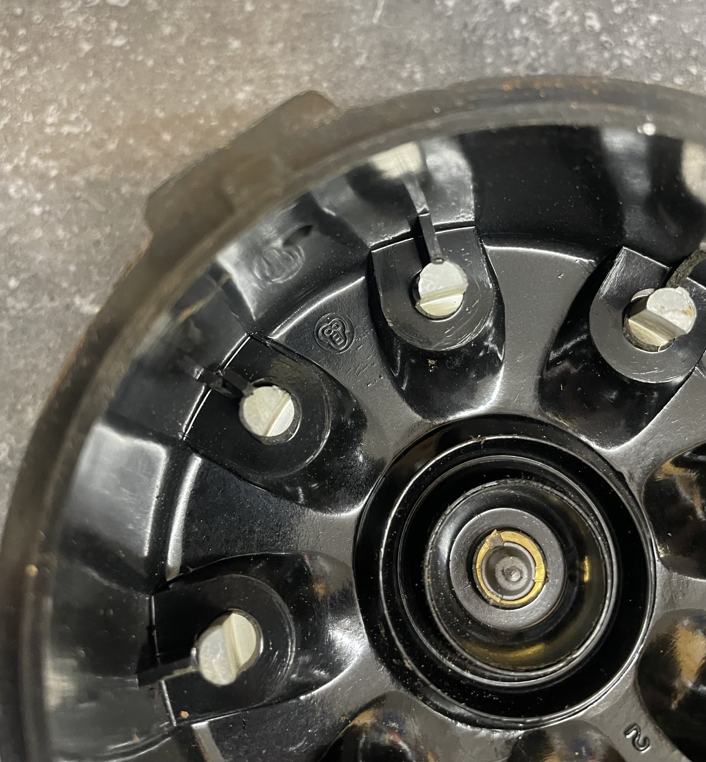

    My factory distributor with Pertronix unit works just fine. So why do I want one of these so bad?
    I wonder if anyone has tried using a flat top 2 piece cap on a factory distributor?
  10. Moriarity
    Joined: Apr 11, 2001
    Posts: 37,066
    Moriarity
    SUPER MODERATOR
    because they won’t fit. Different way of indexing and the diameter of the distributor bodies are different IMG_3292.jpeg IMG_3291.jpeg IMG_3290.jpeg IMG_3289.jpeg
