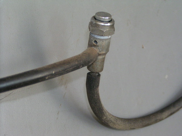

  1. Found a vacuum switch or button in the lower edge of the dash - wasn't connected to anything. My '47 Fleetmaster does have windshield washer nozzles in the cowl, but everything else for washing is gone. Was there a vacuum-operated washer pump, or was this for something else???? Thanks! P6210147.JPG

    Escape ...Nitrous button.

    vacuum starter switch

    I just helped do an engine swap on a '48 Fleetmaster, and it had an aftermarket horn/whistle on it that was vacuum operated.

    I am assuming some aftermarket gadget, maybe wolf whistle? I had a 46 and a 48 that did not have switch of that type under dash.

  7. Pretty sure an add on for a wolf whistle or oil eye or maybe a vacuum operated fan ?

    Not sure about Chevys, but back a little earlier there was a vacuum shift two speed rear end , mostly for Fords. Maybe? But I’m betting on the whistle!

    the vacuum shifter stuff was all self contained at the transmission, it did not require any buttons to make it operate. The windshield washer system used a button that was in the wiper knob, or a separate one on the floor. But that was for the Chevy accessory...there could have been an aftermarket washer that had a separate button like that.

    Most likely for a wolf whistle or air horn. They did make vacuum operated trailer brakes but the control lever was different than that. Not a button but a lever.

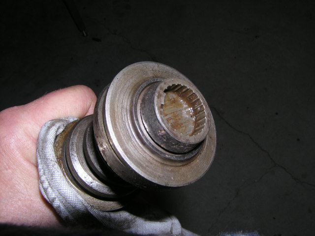

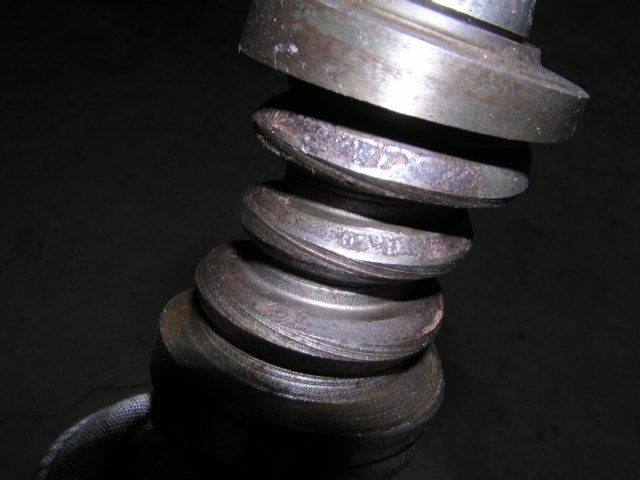

    I had to get the front shock/upper control arm assemblies rebuilt - one had about 1/2" of lost motion in the fore/aft direction at the top of the king pin - most likely internal pivot bushings worn from years of driving with an out of round or out of balance tire. Replaced king pins, thrust bearings, and bushings - including the threaded bushings and link pins. Replaced the tie rod/ends on the passenger side and the tie rod ends on the driver's side - also because of lost motion. Rebuilt the steering gear and replaced the worm shaft tapered roller bearing that was bad and cleaned up the inner race (this is made onto the worm gear - not replaceable singly). Replaced the balls in the sector shaft roller because of rust. Cleaned up the rusty and pitted worm gear, but really needed a new one. Because I cleaned up the worm gear, I can't quite get all the lost motion out of the steering gear, even with the worm adjusted as near the sector roller as possible. Had to replace all the rims, as water had entered around the valve stems and rusted the old rims away. However, I appreciate the input about steering effort possibly still being greater than it should! One possible cause is that the tires are wider than original - not real wide, but a standard 16" modern radial tire easily obtained - maybe this was a mistake. I'm not a big fan of power steering, but I wonder if I can find a modern manual steering box with a sector gear (instead of roller) and recirculating balls that will work for this application - I would prefer this to buying new parts for the old gearbox. I do like the big steering wheel! I am certain the car is safe to drive, but could be improved. This is a low-budget build, and so far the rebuilding of the front shock/upper control arms was the greatest single expenditure. Front end kit with bushings and link pins was 2nd, and rims were 3rd. I've also replaced all the brakes lines, shoes, master and wheel cylinders.

    Northing listed in the 47 accessories that would go with it pages (gmheritagecenter.com) I'd go along with a vacuum operated aftermarket accessory.

  25. I don't know what it's for either but I have one like it too......and I once had a 48 chev coupe. I think it's for vacuum operated windshield washers because it allows vacuum to pass only while the button is pushed...let go and the vacuum stops.
  26. Sounds like a good possibility! My car had a bracket on the firewall that looks as though it might've held some sort of bottle - maybe that was the reservoir. Haven't researched washers yet - getting the old girl going - and logged about 30 miles today! Every time, I hit a bump, she loses another 5 pounds in rust flakes.....

  28. If it's anything like mine, the vacuum wiper valve (the one on the dash that looks like an afterthought) leaked like a sieve, and someone probably by-passed it and put a simple on-off valve. My oil-filled shock absorber/top wishbones had the same problem, when I first got the car, I poured the oil in at the fill plug, and it came out of the worn shaft seal/bearing , just as fast. Not wanting to sell a kidney to overhaul these, I put external cylinder shockers on, and am getting an IFS ready to install.

    I had an old pontiac that had a canister under the hood for ashes and cig butts - it was activated by a vac. button and had a small chrome port on the bottom of the dash that you flicked your cig ashes at it and the vac would suck them into the canister - just a thought - Jaxx
  30. I'm with you! This project has been full of issues that almost merit big changes. I'm still replacing 6V accessories (most lately the turn signal flasher) and wishing I'd started out with a 12V conversion! Always on the tipping point.....And yes, the afterthought wiper switch does leak - but I found I can stop the leak by moving it back very slightly toward the "run" position. The heater control in my '84 pickup is the same way - and both are made of pot metal....
