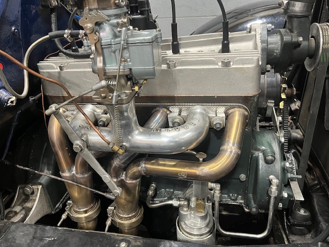

    Hope thats not to me.. started running A/f fed @ 16, then to AA/BAD in the 70's and back to injected alcohol in to the 80.. then to gas broggie roadster, gilmore fed and a long list of door slammers....
    the little guy in the blue shirt built these headers for my model A
