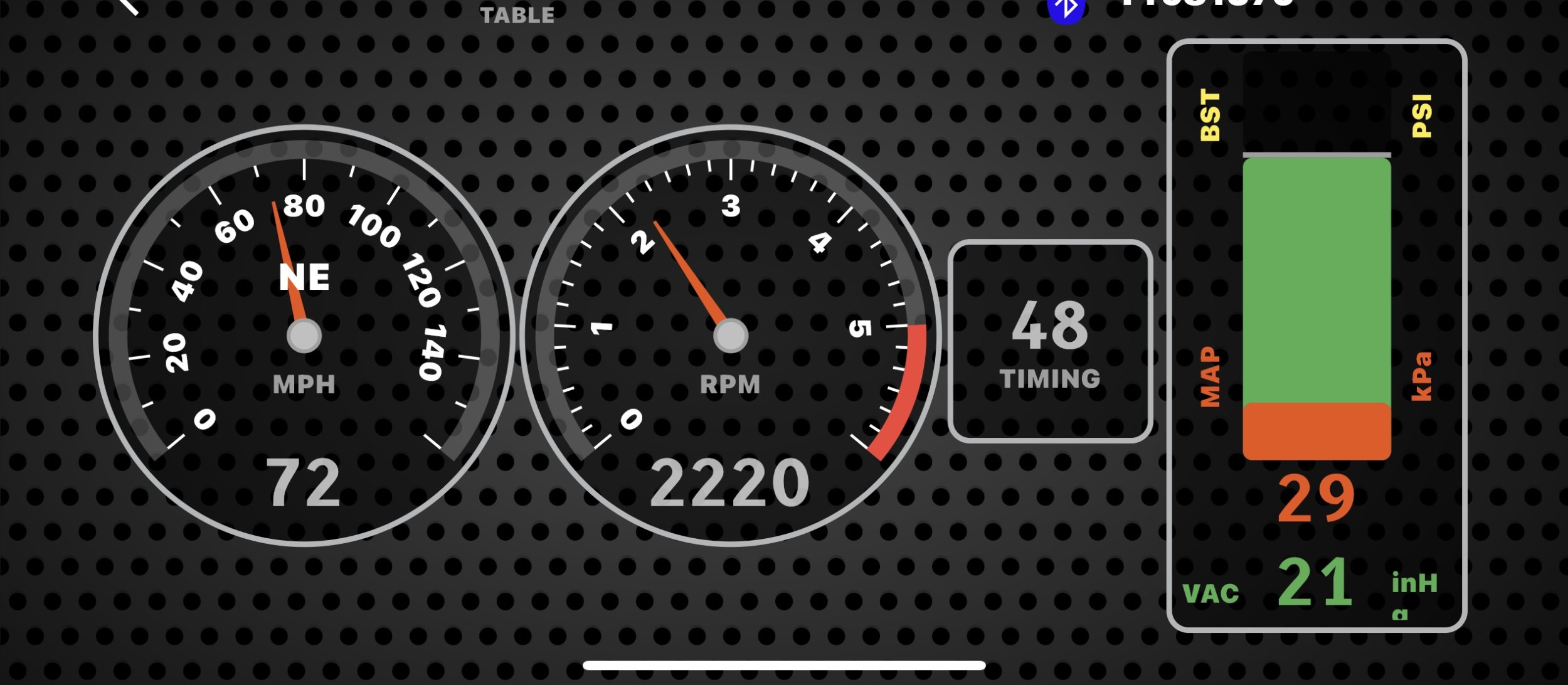

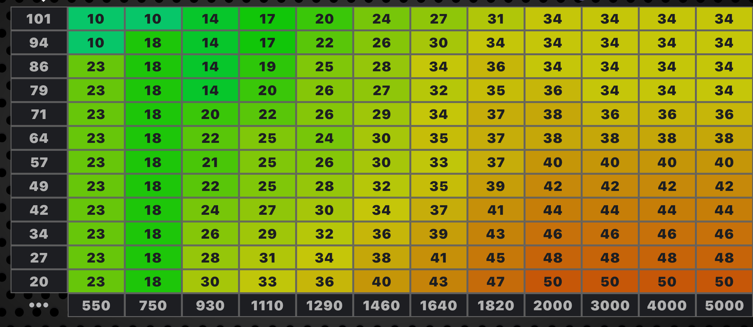

    Small block Chevy in a 51 Merc. AFR in the mid to high 14 to 1. IMG_7465.jpeg
    Rice n Beans Garage and pprather like this.
  23. pprather
    Joined: Jan 10, 2007
    Posts: 8,957
    pprather
    Thank you @ebfabman.
    Light throttle, 21"hg vacuum.
    Cruising 72 mph at 2220 rpm.
    Timing at 48 degrees BTDC.
    Initial advance, some mechanical advance and some vacuum advance.
    Rice n Beans Garage and ebfabman like this.
  24. ALLDONE
    Joined: May 16, 2023
    Posts: 3,809
    ALLDONE
    and just to keep with the facts... timing was not set @ 48 degrees... it saw 48 when it wasn't producing any poewer, and the motor was just floatin... also fact... which would be nice if it was shown...is that every time you touch the throttle ,the timing will drop 15 degree...kinda like the instant MPG on new cars... my cl*** C rv got to 99 mpg pulling a 10k loaded trailer down the 8% grade in hurricane utah. but soon as Got to the bottom and had to gas it on the flat it dropped to3 mpg.... but just to not argue with the sign post and take the wrong road home....I never tell anybody I get 99 mpg pulling a trailer...same as one should not tell others they run 50 degrees advance,... the motor is asleep when it gets to 50 degrees ...
    Fordors likes this.
  25. ebfabman
    Joined: Mar 10, 2009
    Posts: 604
    ebfabman
    Wrong. I set it at 48 degrees and can change it in real time any time I want.
  26. ALLDONE
    Posts: 3,809
    ALLDONE
    you win....
