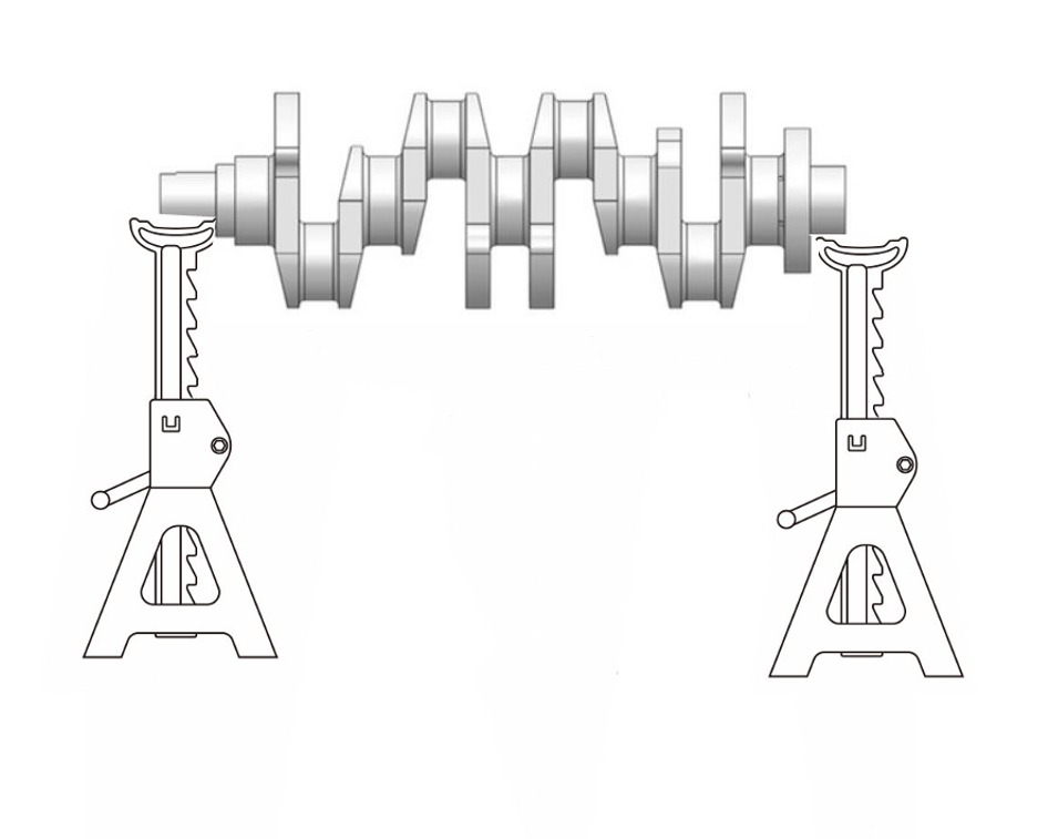

    I store mine like this:

    I'd rotate the jack stands 90 degrees to keep the crank in place.

    hmmm, that could be why they keep falling off.o_O
