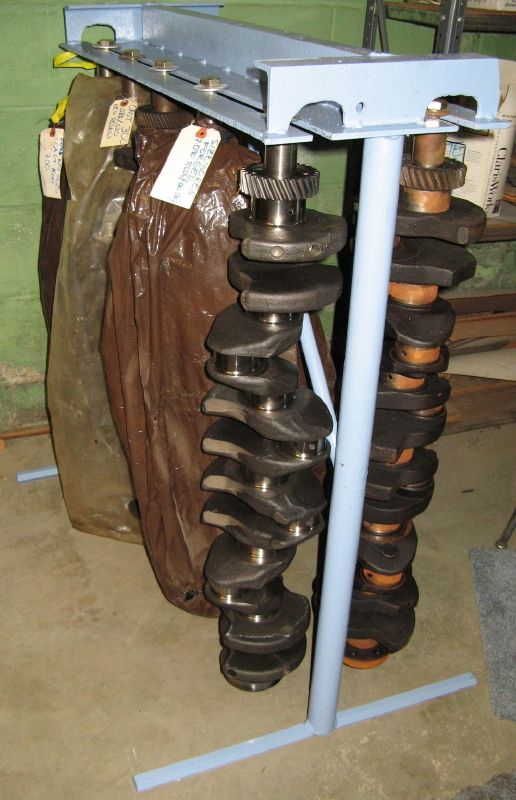

    That damage is called brinelling. Not uncommon on rotating kit freighted long distances.

    Remember a guy in 80s, had a row of 409 Cranks hanging from bracket just like that. Some had chromed journals, real vintage stuff from 60s.

    I don't want to get to in the weeds here, but yes steam turbines to this day are motored over on a turning gear at about 1 revolution every seven minutes. Now days through hull shafting specifically CPP shafts aren't skinny. But they are aligned with radial offsets, mostly on the vertical plane.
    yes brinelling is real, yes distortion can occur from not uniformly supporting a shaft. It doesn't happen quickly it's over a long period of time. Also while we are on the subject don't put your bearings split line down.
    y'all can store you cams and crank shafts how you want, me at my pace I'm going vertical.
