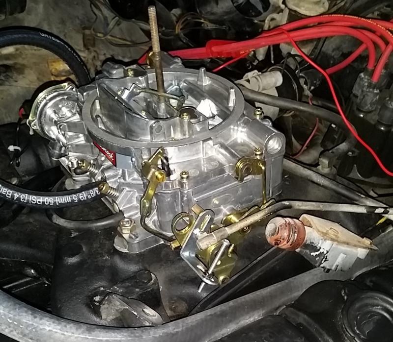

    I have read some about the trans kickdown would need linkage made if I ran a Edelbrock. But I can't find a lot on it online .

  9. The transmission kickdown is an electric switch that can be adapted to the Edelbrock without too much effort. I put an Edelbrock 800 CFM on my 401 but you have to modify the primary bores in the intake slightly for the throttle plates to clear or use an appropriate carb spacer. My motor has been modified though. I think the original AFB was rated @ about 635 CFM. Jon is correct about the AFB being the best choice as the fuel inlet and PCV connection are in the correct location. He can probably fix you up w/ the correct carb.

    IMG_0006.jpeg Here’s a picture I stole off the net (from a Riv site) on mounting the switch to an Eddy. Just a starting point for you.
    But it’s a Riv, even if not pristine. Keep looking for the right carb. I’m glad you’ve got it before your friend got a bigger fire pit.

    Yes that is the pic I seen that had me questioning what I was going to do .
