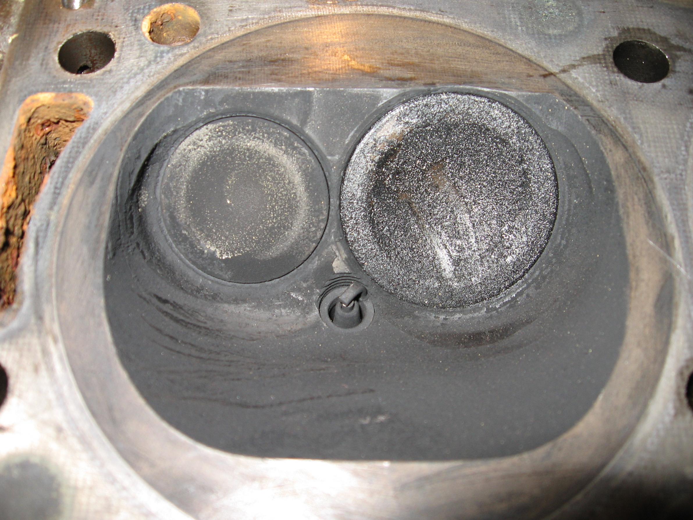

    So I started to rip in to my motor and came across some weird ****.
    1 There is a good amount of carbon build up on top of the pistons and heads
    2 One of the pistons are not like the others and it has small holes that to me looks like a bad cast with some weird scoring. No scoring in the cylinder walls. This piston was cleaner but a little greasy and the valves had this same weird gunkey buildup and all the rest were dry carbon buildup
    3 the oil smelt a little g***y and seemed thin.
    The engine sat for about 3 years but ran fine before it sat. No smoke or stuttering. The guy I bought the car from said it had been rebuilt 8 years ago. Everything else looks good except for these issues listed. Here is a pic of it.
    Thanks for your help
    Chris

    Looks like steam erosion. A leaking head gasket can allow a bit of coolant in the cylinder, causing pitting like that. Or it could have got some water in that hole when it sat for a while, that'll do it too.

    Is it ok to run like this?
