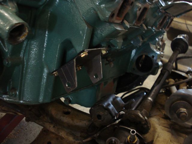

    So I've been not working on my '60 Intl' for a while. Kind of sat it off to the side and left it in bare metal waiting. Well I picked up an S10 for $61 and decided that maybe I'd put the Intl' on that chassis instead of going through clipping the stock chassis.

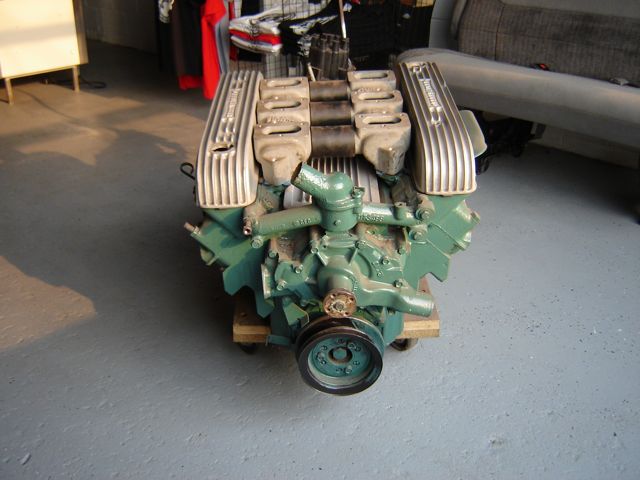

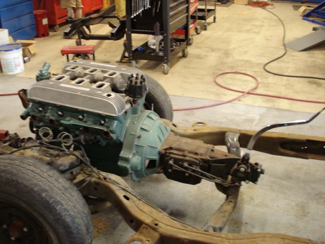

    So check out the 364 I just happen to have laying around... :D

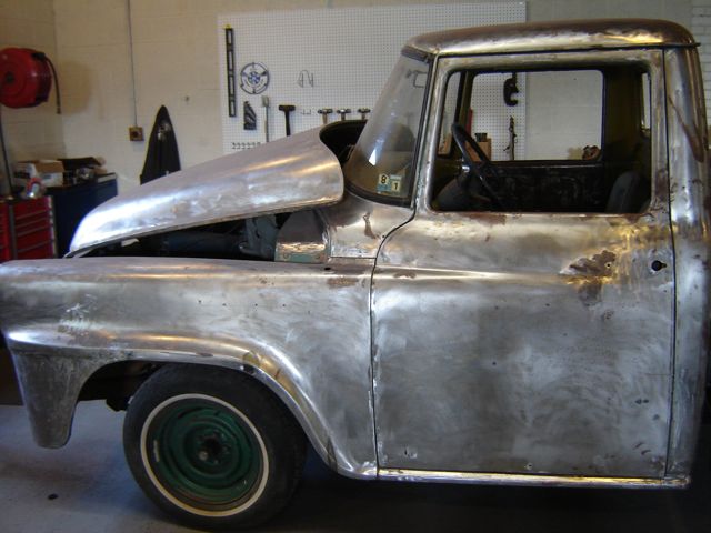

    And the Intl'... a 1960 model...

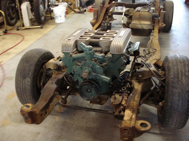

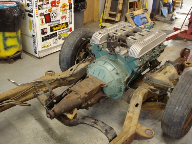

    Mock up of the drivetrain in the chassis...

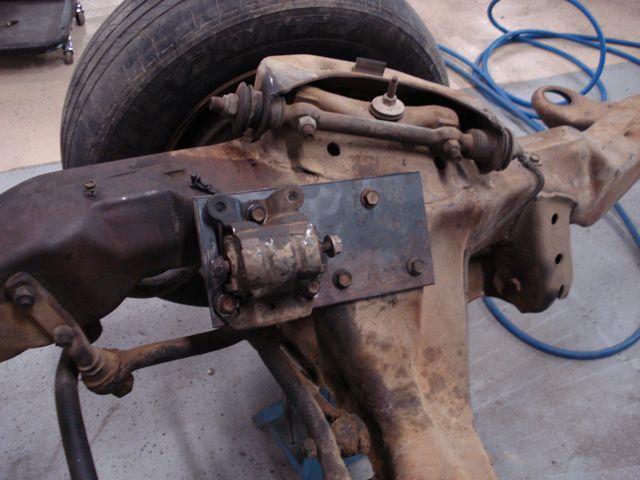

    3/8" plate to move the stock motor mounts 5" forward to better position...
    Some 4x4 I had laying around as well....

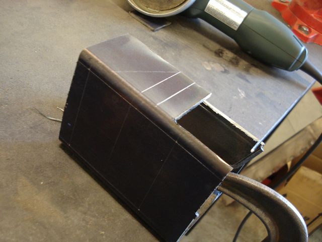

    Dye Chem and a scribe.. then the cut off wheel....

    A little work and here is what I ended up with....
    Bolt them up and check the positioning...
    I guess I can grab a transmission mount at the parts store tomorrow and be living in high cotton... plus I can lose the 2x4 scrap... :)

    I still need to move the rear end before I can work on body mounts and get it all set up on the chassis. Wether I got a long or short wheelbase the Intl' doesn't match up.
    The engine also sits a little higher than I would like, but is better for some of the clearance issues. I'm gonna need to run a remote oil filter but I can at least run the stock starter....

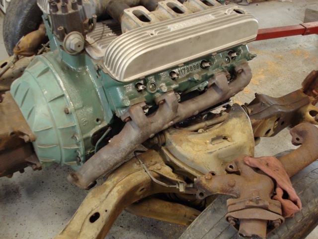

    That is a genuine Buick GS bellhousing. Very rare. But I just happened to have two of the whole setups. And the GS exhaust manifolds as well...
    The first rub is that I do not have a set of exhaust manifolds that work. The GS passenger side manifold works. A regular 401 driver side works. I hate to split up a set, but ya gotta do what ya gotta do.

    Exhaust manifolds...

    dont split up two sets of exhaust... just stop bein a lazy bitch and build headers... PS. dont move the rear. just torch the factory welds in the frame and make it as long as you need it. less work too

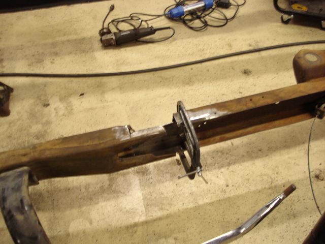

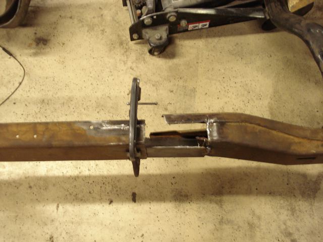

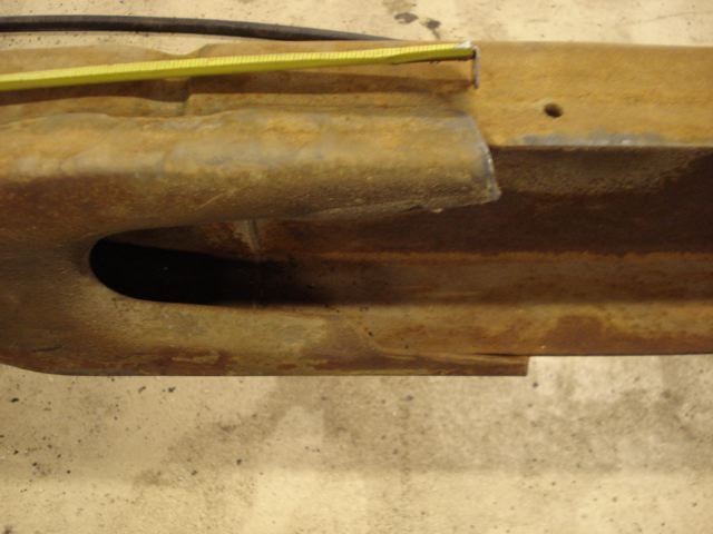

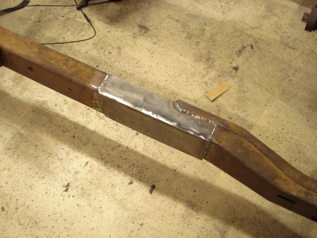

    Looked at it this morning (this one is a 92) and it doesn't look like that can be done. It's inside the other rail for all of 4 inches, I need 6. I can just weld in another piece. I'll figure it out today, but first I have to fix the Ice Cream Express....
  16. zman
    Joined: Apr 2, 2001
    Posts: 16,787
    zman
    from Garner, NC

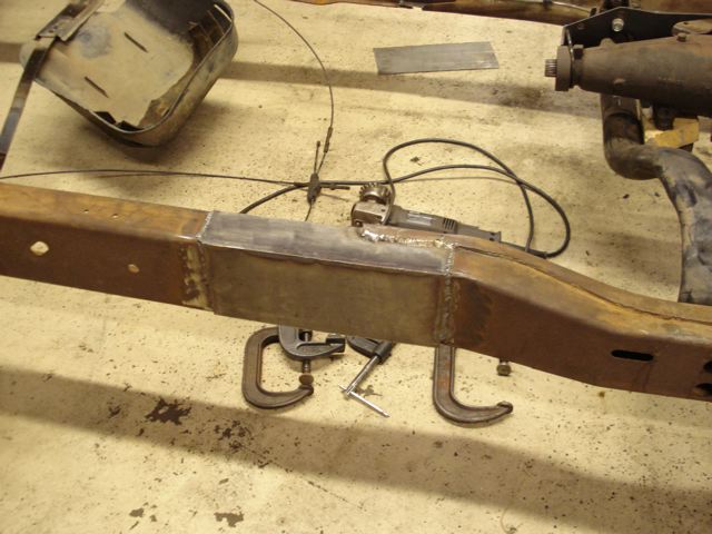

    so I split the frame and tacked a piece inside to get the stretch. made sure everything is kosher, checked the wheelbase and rail alignment about fifteen times. then I started to box it all in, got the top done.. tomorrow the sides...
    welding in 100+ heat is swell...
  17. 51ChevPU

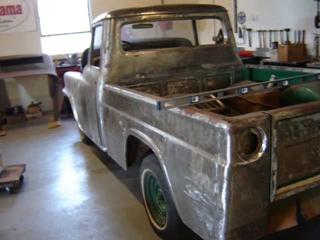

    I have not forgotten, we've been getting stuff done. The cab is on the frame and the bed is getting there.
    The height is just what the doctor ordered...

    Got the bed on it today, got a bunch of pics I need to post of the steps to make it through. switchblade327 is the cut off wheel king....
