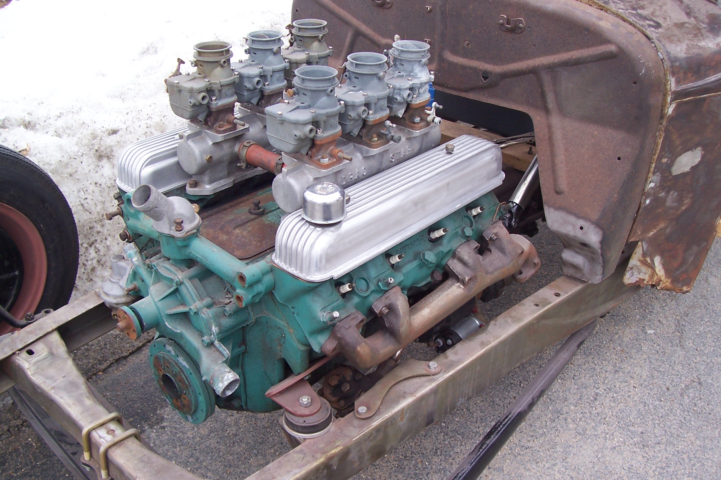

  5. The bottom line is the carbs SHOULD be level............As you can see in the picture, the carbs are level, the valve covers are level and the motor is level.......................Most other intakes will be high in the back but there are ways to work around that. 100_5863.jpg

    ImageUploadedByH.A.M.B.1408318594.897563.jpg ImageUploadedByH.A.M.B.1408318607.011372.jpg so could my intake be raised slightly in the back? Could it be on backward?

    "Could it be on backward?" Sure it could. Lots of fabbing, but anything is possible.:D

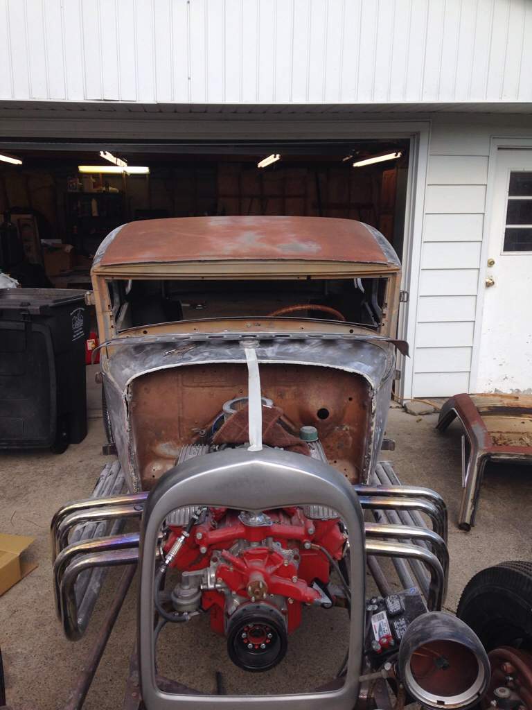

    Picked up a radiator shell today and figured I would set it up really quickly to see how much I am going to have to Bend my headlight mounts and get an idea on upper shock mount position. ImageUploadedByH.A.M.B.1412050902.176115.jpg ImageUploadedByH.A.M.B.1412050915.158245.jpg ImageUploadedByH.A.M.B.1412050925.608590.jpg

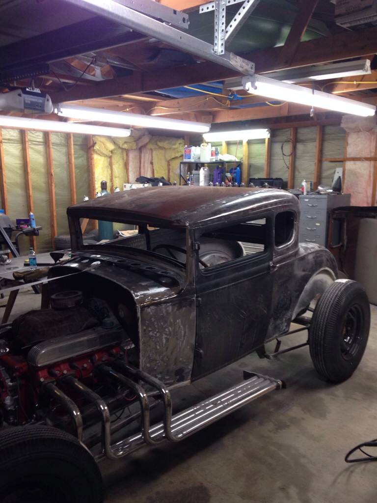

    ImageUploadedByH.A.M.B.1412559488.092742.jpg ImageUploadedByH.A.M.B.1412559499.943265.jpg ImageUploadedByH.A.M.B.1412559514.725511.jpg ImageUploadedByH.A.M.B.1412559531.792310.jpg ImageUploadedByH.A.M.B.1412559544.809304.jpg
    Got the top insert tacked in place ran out of welding wire so had to stop for the night

    Your're going to have alot of fun stepping over those "cool" hot pipes - been there done that!!
  22. Bam.inc
    Joined: Jun 25, 2012
    Posts: 661
    Bam.inc
    from KS
    I don't usually like the gallery of critical comments, but I'll have to agree, this time. Please re-engineer those pipes. After you instruct every p***enger & every kid "don't burn yourself" You'll stick your leg to it too. Good luck

    Having fried my leg on the side pipe exhaust of a friends plastic cobra,,I hate them,,if they stick out as sure as the sun comes up in the morning somebody's kid is gonna grab hold of one of those pipes ad get severely burnt. HRP

    The plan with the pipes has always been to shorten them and angle cut them.

    The problem is. You'll end up breathing fumes and get a headache and feel sick.
