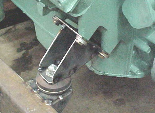

    was workin hard last night and tonight, got the body out of the way and the k-member out also, bolted the fire wall back in place and stuck the trans on the motor and swung it in place, did a bunch of measuring and centering, then tied the motor on place where i wanted it. then i started putsing and thinking of how i wanted to mount my engine.....heres what i came up with

    i also pondered over some ideas for the trans mount, think im gonna go with an x member type, heres some ideas i had for that, i think i can also incorporate the pedal ***embly into it(like a 40 ford). ill also cut holes in it like and original ford x member. ill also have to run the exaust through there cause i dont want it hanging down below the frame rails, but ill have to make sure everything fits first. well thats all the progress for tonight.

    very clean motor mounts, nice work.

    Those mounts are perfect ! I just posted a question yesterday asking about this same topic. I'll send you a PM.

  11. Very nice design.
    I like em.
    Am curious about the metal gage though - is it 1/8" or am I being fooled by the angle?

    Nice mounts! Wish I had done something like that. How about some lightening holes in the sides? Just a thought.

    Nice job. Giving me lots of ideas for putting a 401 in my Deuce Tudor.
