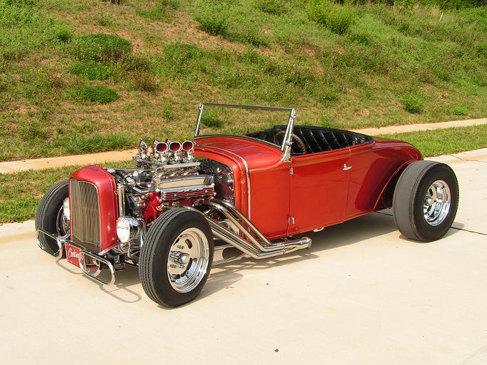

    Had the same problem on this car. Also, the faster I drove it the hotter it got. Had the distributor recurved. It was way off but the real problem my dad found out was that the water was moving too fast and couldnt cool down in the radiator. He put a big nut in the lower radiator hose and put a hose clamp on it. Fixed it.
