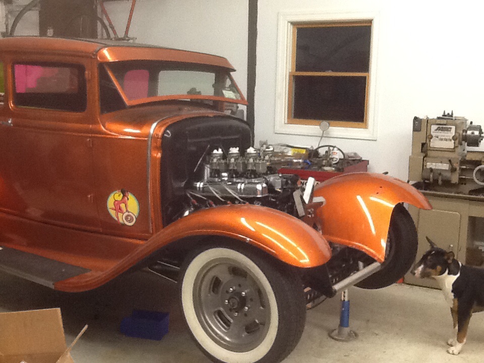

    Someone out there asked about Nailhead Power in an early model A.
    My Roaster P.U. is a 28 AR model, powered by a 401 Buick Nailhaed,
    backed up to a T400SP transmission. Attached is a picture of the
    build to date.

  4. jr9162
    Joined: Sep 8, 2008
    Posts: 247
    jr9162
    That ought to move on down the boulevard. Firewall mods?
