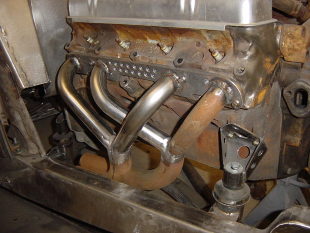

    This weekend I made the flanges for my headers and got the one done minus the collector. The flanges were the hardest part. They're gonna get coated white when they're done.
    Cool? I like them!

    I like them. I've been looking at making something kind of similar as far as the pairing of the cylinders but bringing them outside the frams rails and also reminiscent of fenderwell headers.... I'm just waiting on the tubes I ordered to show up..

    Those are bitchn!! I'm only countin two Ys, but I'm not complaining.
    What are your plans for the collector?
    Man, I love building headers...one of the funnest parts of building hot rods.
    Can I steal your idea for my Studebaker?

    JK...I spent about a half hour on the one head. After cutting myself on the one casting mark I got pissed off and got rid of it. A half hour later the head was smooth. I didn't do what the plug covers cover.
    FlamedAbone...the third Y is at the collector. I've got a 4 into 1 collector I'm going to beat on till it fits. I'll have more pics tomorrow.
    Sorry not my idea. I think they used to do it a lot in the 50's or 60's. If you're into maximum power you have to match the ports according to the firing order.
    I did have fun with them.

    The third "Y" is where the tails of the first two "Y"s come into the collector.
    Was there a performance reason for pairing the cylinders like you did, or was it cool looks? Other Nailhead Tri-Ys I've seen made the obvious pairings (both front, both back, then into one). They look GREAT--I've often thought that if I ever get off my ass and start actually working on hot rodding my '54 instead of just talking about it, Tri-Y headers would be the plan.

    Brad...I guess I did make them the hard way. I just liked the looks this way. I hope I didn't screw up the performance with these. Of coarse with 1 1/2" into 2" pipes I can't see how it could be worse than stock manifolds.

    Man, I think they look GREAT! I absolutely love the drilled flange. I agree--can't be worst than the stock manifolds! I'm going to run a set of stock '56 2.5-inch outlet manifolds on my '56 322 for a while, but I think at some point headers will be the order of the day.

    Zman....lucky you! I've got at least 6 hours in the flanges. I measured several times to make sure everything was perfect.

    looks good Clark,
    I'm thinking you did it right by splitting them the way you did, on this side anyway.
    if you had paired the number 1 and 3 cylinders together they would be firing consecutively and fighting each other for flow.
    while not perfect this separation should give some time between pulses, helping the scavenging effect.
    I think though that the other side should be paired 2-4 and 6-8 to break them up, if you pair them like you have here cylinders 4 and 8 will be consecutive in the same secondary.
    Paul
  17. That will be difficult, the Stude center exhaust is siamesed so you only have 3 ports out of the head.

  25. Great job Clark. I ran a set of tri-y's on a '62 Vette for quite a few years and then went to 4-in-1 "tuned " headers and the latter moved the power range up further and robbed the bottom end so that the car wasn't near as much fun to drive. Went back the other way.
    I don't remember the pairing except they were different side to side - as someone else mentioned.
    Charlie

    I like things the same side to side so I made the driver's side the same.

    very cool i like your motor mounts aswell
