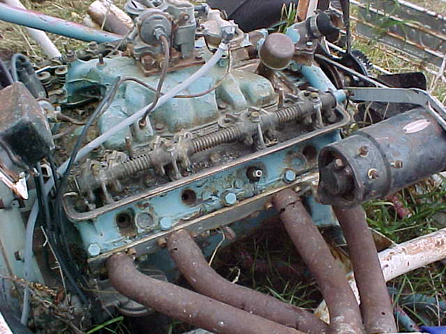

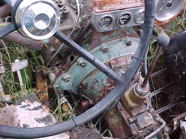

    I picked up a scratch-built open roadster built in the late '50s in California that has a nailhead mated to a 39 Ford ****** thru a Cragar 309 adapter. The car was from the San Diego area and was raced on the desert around there in '58-'60. It has early Ford front and rear suspension. I would like to resore this racer, but first need to know what the Nailhead is --- probably a 322 or 364. Can anyone tell from the pics?

    No harmonic balancer, it would be 53 322 or 54-55 264

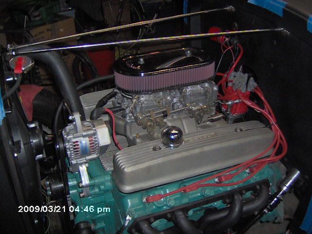

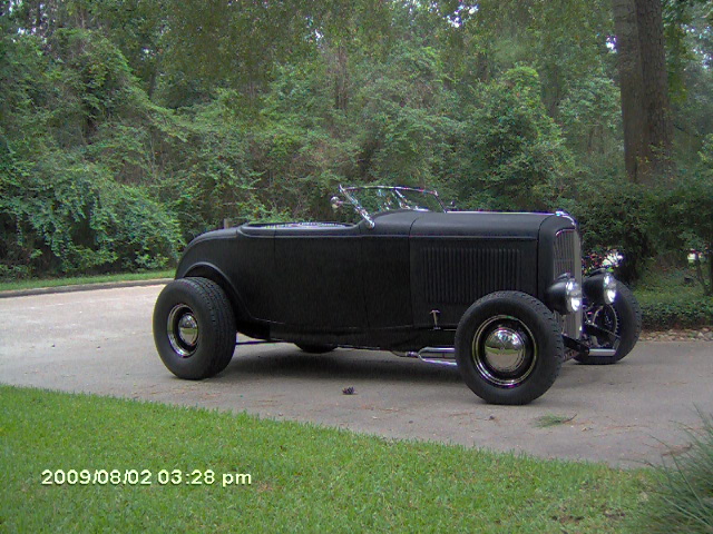

    Our 1932 Ford Roadster with a 1963 Buick 401; dual 600cfm Carter Compe***ion carbs, MSD, .486 lift cam, Sanderson headers, Muncie 4 speed, Ford 9" with TSD and 3.70 gears...
    First photo is from day we fired it up - second photo is first drive to Houston Roadsters breakfast - third photo is the car we visualized in our minds when we started with a frame, body, and rear end housing and spring.................four+ years ago.
    My 14 year old son and I did 97% of the build - with the exception of frame motor mounts and machining of Buick brake drums by Bruce's Rod Shop in Spring, TX; engine motor mounts, trans mount, pedals and clutch linkage by Bob Gleim of Bakersfield, CA.; and some really good advice from Jimmy Shine at So Cal Speed Shop in Pomona, CA.
